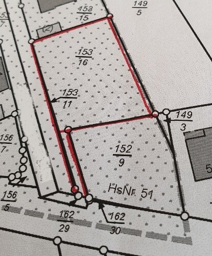

Plot size = 600 m² (6458 sq ft)
Number of floors = 2
Roof type = Gable
2 children’s bedrooms
1 office
1 walk-in closet
1 bedroom
Guest toilet and bathroom
Open-plan kitchen and living area
1 utility room
Double garage with storage area
Found on the internet
Why is the design like it is now?
Plan currently fits best
Utility room and office swapped due to door leading to garage
Dislike the large hallway on the first floor
The footprint of 9.5 x 9.5 m (31 x 31 ft) should be maintained
Layout should be as simple and cost-effective as possible
No unnecessary features
More elegant solutions with less hallway space loss?

hegi___ schrieb:
I have now flipped the floor plan and placed the house in the center. So where is the heating system located in your utility room? I only see a water storage tank. Where will the water meter go? What about laundry hampers for four people?
Don’t forget, all the appliances also need space so a technician can access them. They are usually placed 30 or 40 cm (12 or 16 inches) away from the wall because of the pipes.
Please add the coat rack and show the door swing of the front door. You’ll bump into the closet when you come in. Does the door even open if the coat rack is there? The door is 1 m (39 inches) wide, just as a reference.
Upstairs, you’ll come out of the narrow staircase (please also provide the floor-to-ceiling height here! – 2×2 m (6.5×6.5 feet) probably won’t be enough anyway) straight into the wall. A stair landing of 1 m (39 inches) is too small in a new build.
The house placement is fundamental. I don’t agree with ignoring the noise (as others here seem to). I lived for a long time on a noisy street where the house did not shield from the street noise. My parents ended up moving away from there because of this.
Which street exactly is the noisy one? I thought the main issue was the large street to the south. What about the street to the west?
Regardless of the floor plan, if I position the garden on the south side, I initially get sunlight. But if someone builds a house on plot 152/2, I end up exactly where I started.
Therefore, I would tend to place the house directly 3m (10 feet) from the southern boundary, with the garage on the north side and the garden in the northern corner of the property.
What do you think about this?

But if someone builds a house on plot 152/2Where exactly is this plot located?
I can’t seem to find it...
