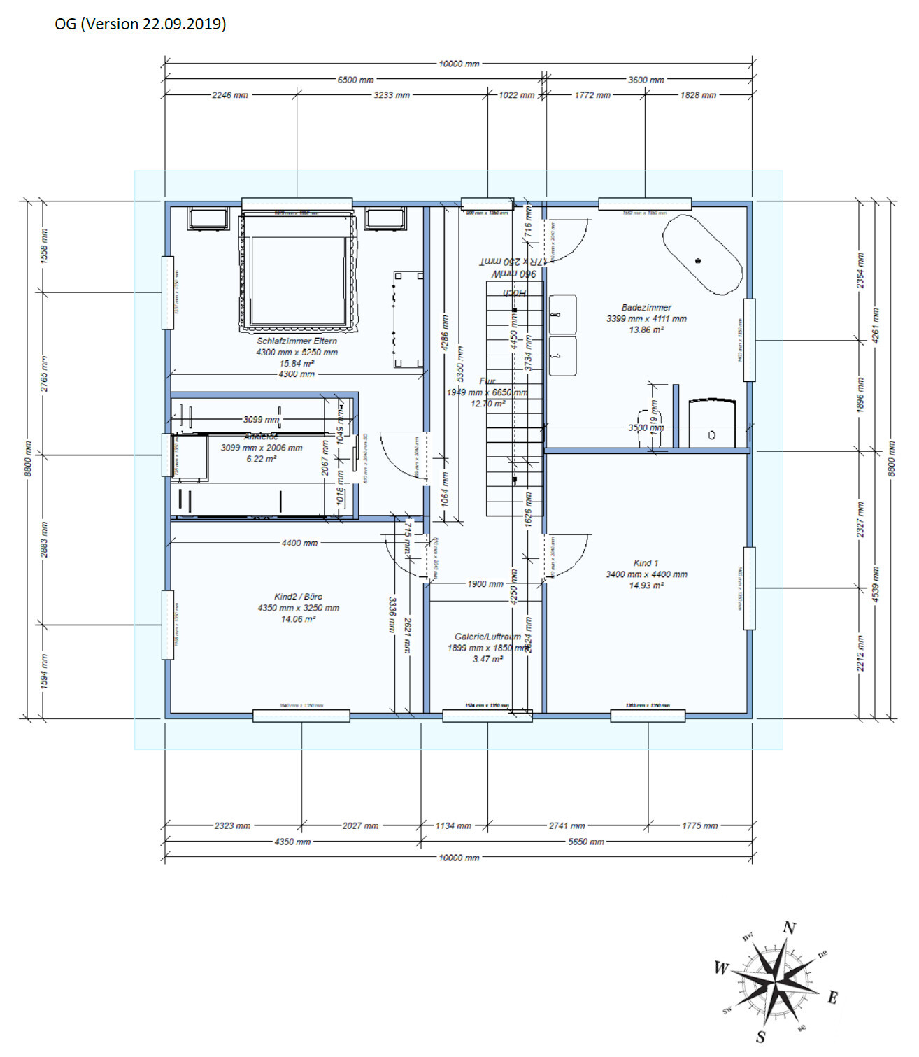

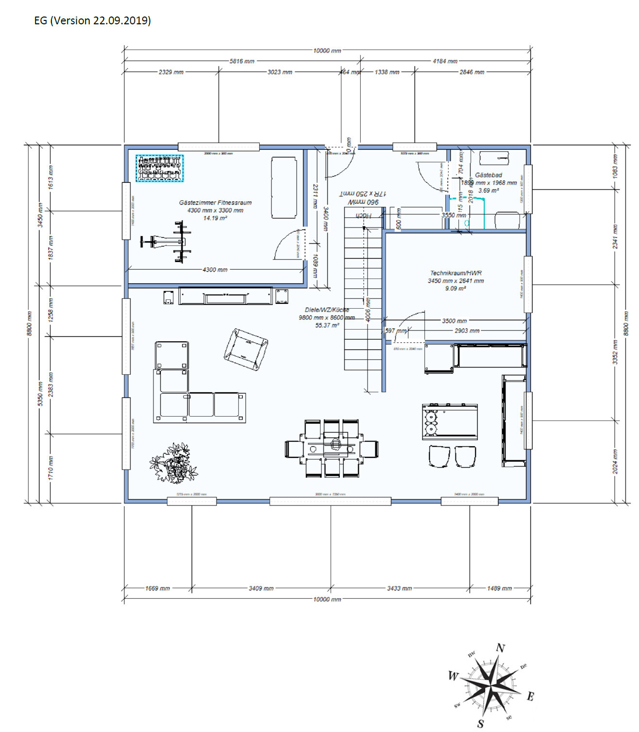

So far, I have created all the floor plans using a software tool. Last Friday, we had our first meeting with the architect. Unfortunately, he dismissed several of our wishes:
- The gallery/open space over the upper floor,
- The layout of rooms on the upper floor (both children’s rooms are planned to face south, while the bedroom and bathroom face north, although we would prefer the opposite),
- All terrace requests,
- The design of the bathroom (we wanted a T-shaped layout with the sink set slightly into the room, the toilet and shower behind it, and a freestanding bathtub in the room), etc.

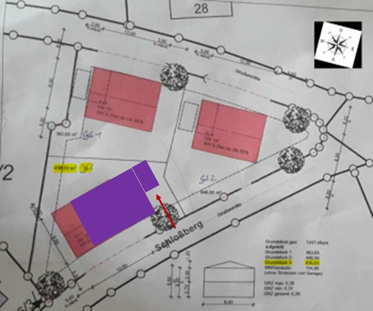

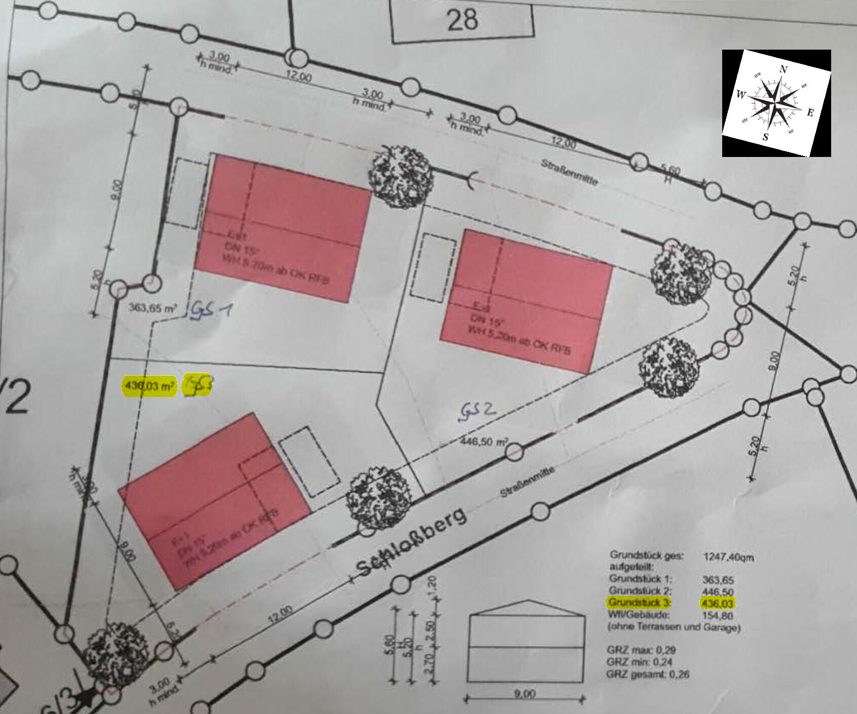

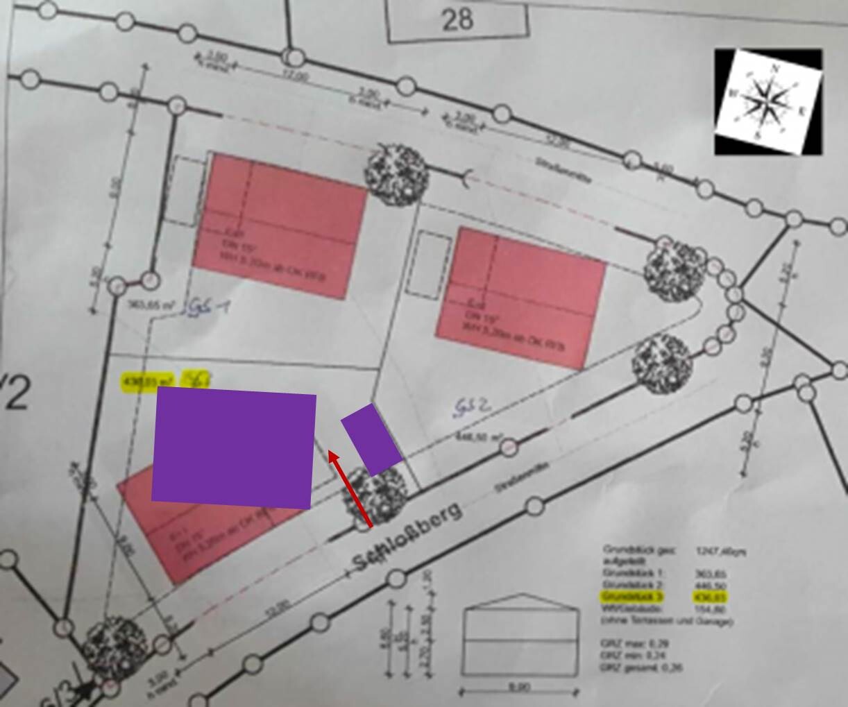

I have attached my plans for the ground floor and upper floor. Since the plot is not rectangular but rather irregularly shaped, positioning the house alone is a challenge because we naturally want the garden and the largest windows in the living room and kitchen to face south. In the attached site plan, the house is still positioned quite centrally (12 x 9 m / 39.4 x 29.5 ft). We will move it as far as possible to the right, towards the east.
We also considered changing the type of staircase (for example, to a half-landing staircase), but according to the architect, the straight staircase belongs to the "Cityvilla" house type by STREIF. I would appreciate your opinions on this. If I change the type of staircase, the entire floor plan will be discarded and the design will have to start from scratch — which is fine, as this is a “major” adjustment.
The architect is planning the entrance not on the south side directly from Schlossberg street, but on the north side: you would approach the property via the street, the house would run sideways along the garage, and you enter after the bend on the north side. So, opposite to what is shown in the site plan. This is quite a long way around. What do you think about this?
You will find comments below with questions. Feedback on the floor plan is welcome!

The guest/fitness room is deliberately planned large to accommodate several exercise machines. Possibly a table tennis table will also be used in winter. The necessity of this is still being discussed. There is no basement. Later, a garden shed will be built in the yard.
Since we have limited space, any tips for storing items typically kept in a basement are very welcome!

The hallway takes up a lot of space, especially upstairs. If the hallway is restricted to the front side, the rooms can be made larger at the expense of openness (see attached test design). Not sure if this makes sense or if it just limits upstairs space too much.
The plot is large but irregular, making it challenging to position the house facing south while maintaining minimum setbacks.

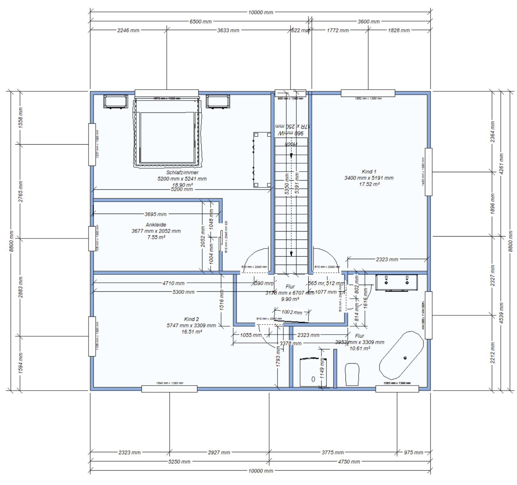

If I were planning with a strict budget in mind, options like "or hip roof" and the open space below the roof would definitely be much higher on my priority list than the total floor area in square meters. A hip roof would also imply a different basic design, since the current approach with knee walls tends to be too luxurious with asterisks. What does the zoning plan actually say about roof shape, pitch, and ridge direction? The house symbols on the site plan even suggest there might be a preference for a clear building axis, including its aspect ratio.
Here, the entrance is actually on the long side facing the street—so what does the architect mean by wanting to place it on the side? How certain can we be that the chosen base model is the right one for this project?
The planning tool is not very helpful—neither the purely symbolic wall thicknesses nor the precise dimensions of irrelevant features (such as the distances between window centers) contribute meaningfully to the discussion.
A mess.
First of all, I want to tell you that you have a very small plot of land. Even if it might be considered large by Munich standards, when it comes to building, it’s still tiny. You’re already having trouble fitting your small house on it.
Of course, it makes sense to choose the staircase design that takes up the least space for small houses. That would probably be a half-turn staircase measuring 2.20m x 2.20m (7.2 ft x 7.2 ft). But it also depends on your other requirements.
Have you already signed with Streif Haus? If yes, why?
I don’t see how you can manage with a 15,000 (15K) budget increase. I find the budget issue quite problematic if that’s your entire financial buffer.
Regarding the floor plan:
I’m not familiar with Streif Haus, but it seems the architect is trying to sell you a cookie-cutter floor plan—probably just to stay within budget. Since the options are limited, he’s offering a straight staircase and a rear entrance.
How flexible is the floor plan with Streif Haus anyway? How much would a custom design based on your own ideas cost extra?
Since everything is so tight here, the discussion only becomes meaningful once you provide the exact dimensions of your plot. Then we can talk about the precise positioning of the house. That would lead to a sensible layout, and only then can we see what money is left over.
Oh my goodness! What kind of nonsense have they told you?
Your financial buffer is already at –35,000€ (–$35,000) based on what’s stated. Whatever is missing will be added on top of that.
What do you want to do with an air-to-air heat pump? Do you have any idea how much electricity that consumes? The photovoltaic system won’t help you much if from the end of November to the end of February you only get 10–20% of the usual output. That’s barely enough to cover the base load and maybe hot water. The heating system will then be completely excluded! You might as well turn off the storage tank for three months because it won’t fill up, and you’ll use everything directly.
I don’t even want to comment on the floor plan! So much beautiful large space on the ground floor and yet so much mess. Oh dear!
To focus first on the house’s position on the plot, I definitely see an entrance in the northeast (if the southeast is to be avoided due to the terrace area).
I have attached two possible locations depending on the building plan’s allowances. I don’t quite understand your mention of the "building line in the northwest." Is the line along the street a building line (which would then be southeast) or just a building boundary? If it is a building line, option 1 would no longer be possible. The more I look at it, the more I prefer option 2. The terrace could be in the southwest, extending slightly around the corner to the northwest, offering both a shaded spot during the day and lovely evening sun later on—wonderful!
(1)
(2)
I see the entrance in the east (or the south), not in the north or west. Although for the floor plan it would be nicer to have the entrance in the north, that would give postmen, craftsmen, etc., a view of your entire property. With the entrance in the east, the northwest part of the plot remains "private" and also enjoys beautiful evening sun.
The "corner" in the garden could be used for a "creative" garage—freely designed, not a prefab garage—e.g., as a storage space for bicycles or a workshop area.
Regarding the floor plan: With the relatively small footprint, I would avoid things like a gallery. Are you planning 2 full stories (typical for the Streif Haus city villa) or 1.5 stories?
Looking at the Streif Haus WD1000 base design, I would rotate the house so the entrance is in the northeast, mirror the ground-floor room layout (utility room and shower to the north), and keep the upper floor as it is (children’s rooms facing south, bedroom in the northwest, bathroom in the northeast). The northwest will also be your quietest corner (farthest from the street).
Children’s rooms in the south make sense—kids want light and the ability to see what’s happening on the street.
Are you set on Streif Haus? A version of the Bien-Zenker Evolution house might also fit the plot well—for example, the Evolution Stuttgart or the EVOLUTION 134 V4.
