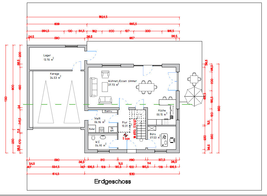

ᐅ Single-Family Home Floor Plan Design, 130-140 m²
Created on: 23 Nov 2019 09:35
hegi___
Plot size = 600 m² (6458 sq ft)
Number of floors = 2
Roof type = Gable
2 children’s bedrooms
1 office
1 walk-in closet
1 bedroom
Guest toilet and bathroom
Open-plan kitchen and living area
1 utility room
Double garage with storage area
Found on the internet
Why is the design like it is now?
Plan currently fits best
Utility room and office swapped due to door leading to garage
Dislike the large hallway on the first floor
The footprint of 9.5 x 9.5 m (31 x 31 ft) should be maintained
Layout should be as simple and cost-effective as possible
No unnecessary features
More elegant solutions with less hallway space loss?
Technical drawings: side view, isometric of houses on plot, floor plan with dimensions
Floor plan of upper floor with hallway, master bedroom, walk-in closet, bathroom, and two children’s bedrooms.
House floor plan with terrace; living/dining area, kitchen, office, WC, hallway.

hegi___ schrieb:
I’m just bothered by the traffic from the main road.
If there’s still some budget left, you could also plan for a soundproof wall, fence, planting, or something similar there.
hegi___ schrieb:
What if we rotated the house 45° clockwise? Then the living rooms would at least get plenty of sunlight.
Do you mean based on your latest sketch from post 54? Forty-five degrees is an awkward angle—you could also call it diagonal. With such a rotation, your house would move even further away from the northern property line, which would make your garden on the south side smaller or shorter. And if you want to build the garage attached parallel to the house, the angled driveway would also cause you to lose space on the north side, which you’ll be missing on the south side.
By the way, I noticed you planned the double garage with the standard setback from the boundary line. I’d waive that in favor of a larger garden on the south side. Also, consider placing only a single garage on the north side to save more space for the south garden.
If the budget allows, you could add a second single garage in the tree-shaded area along the southern boundary, which would also serve as noise protection if both cars need to be kept frost-free during winter.
I’d try to extend the kitchen area all the way to the southern corner (with west-facing windows and close to the entrance), and move the office away from there to the north side instead. Or do you get so many sunny hours in the office that the current location is important to you?

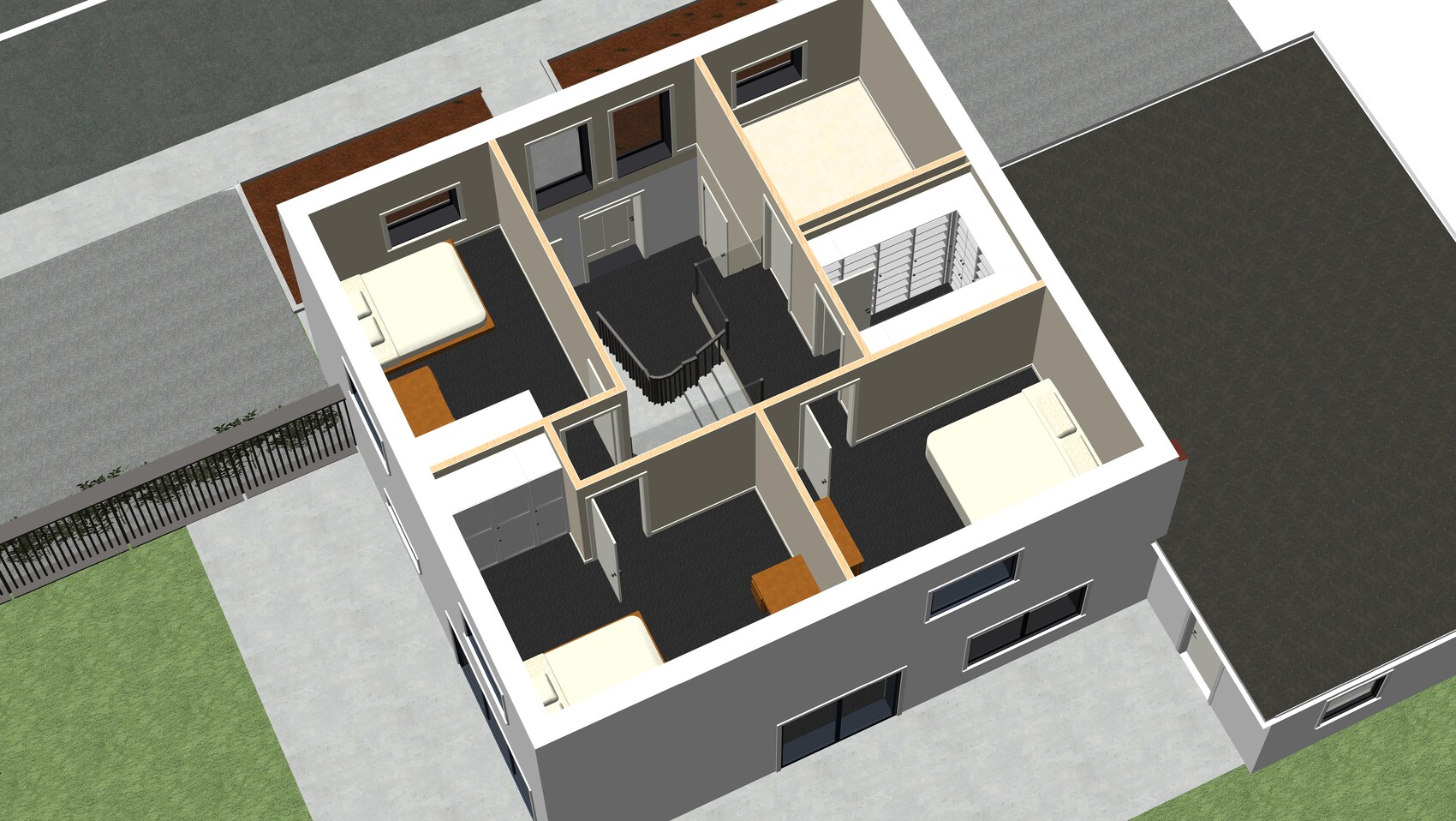

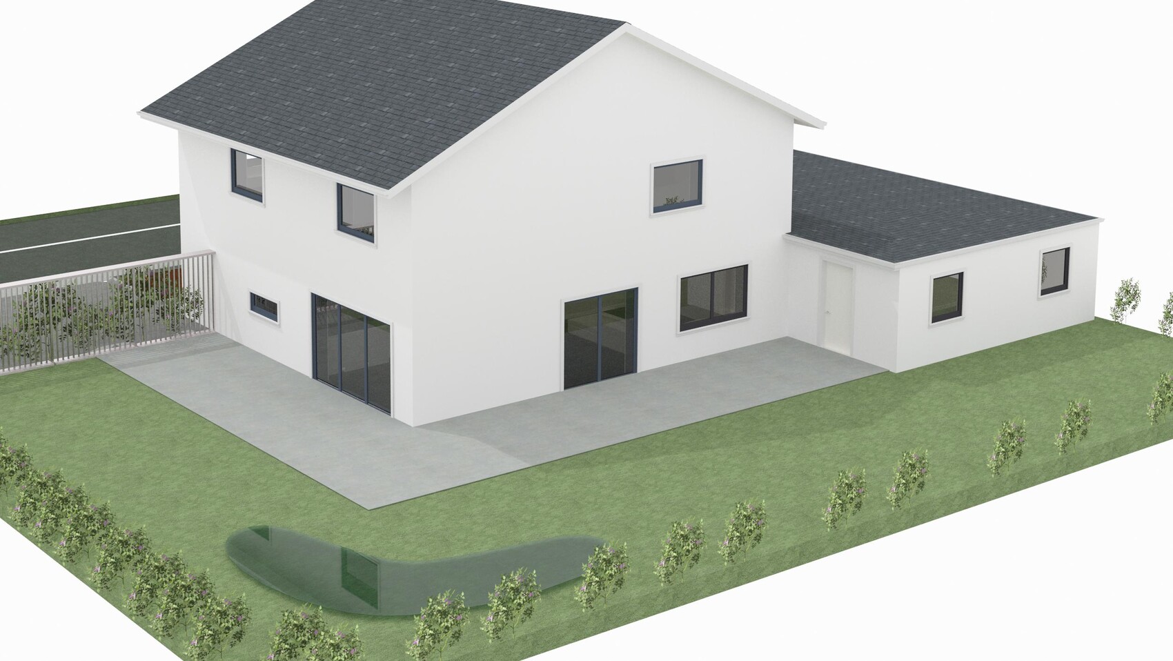

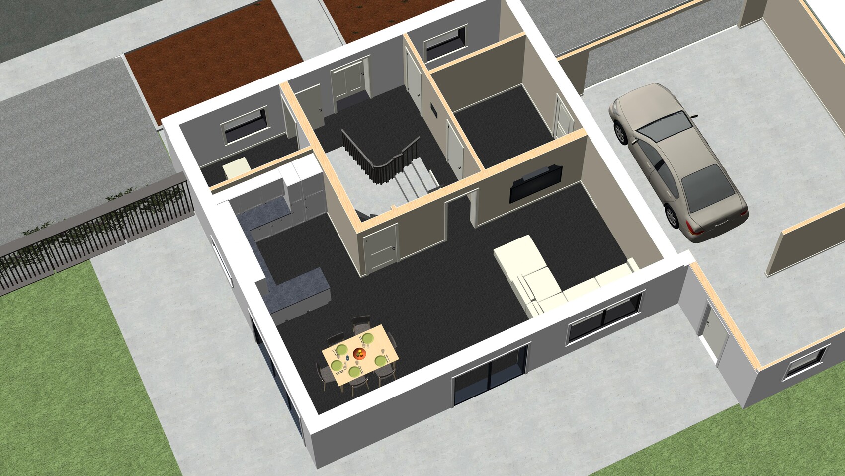

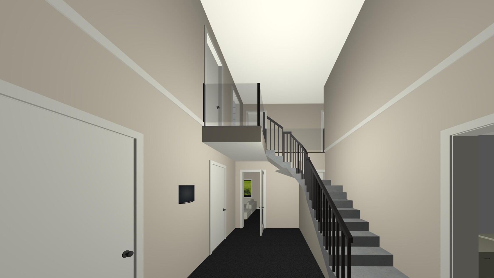

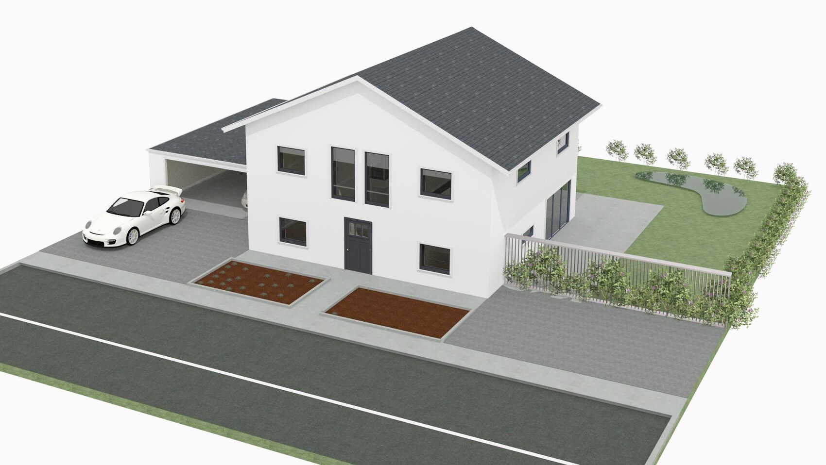

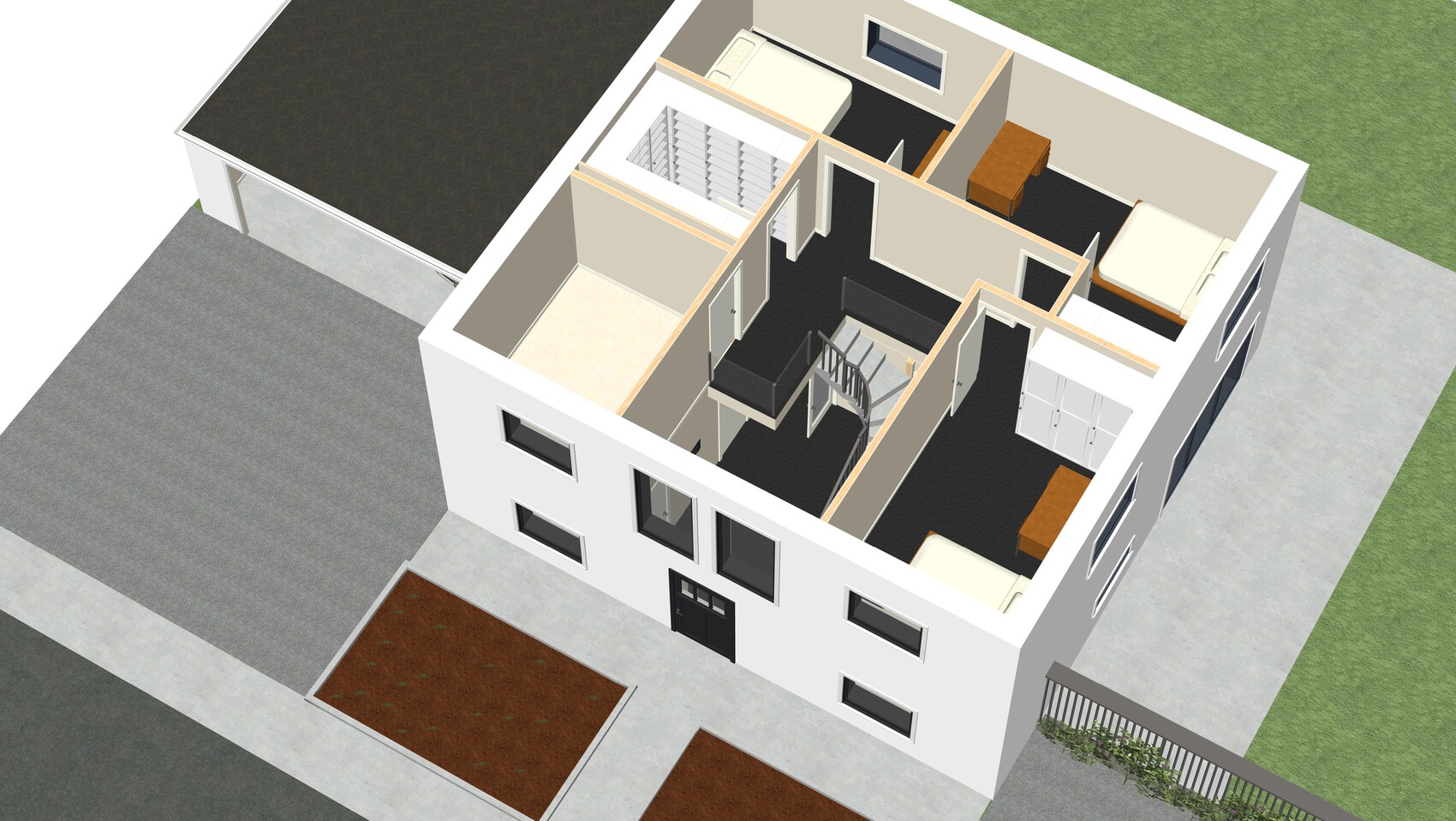

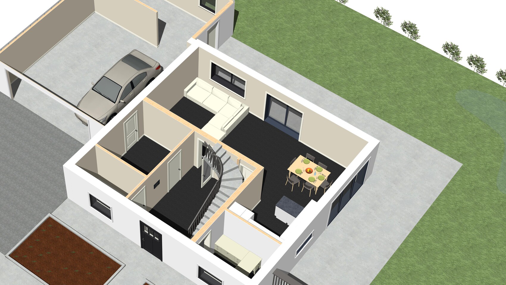

hegi___
1 Jan 2020 20:34
By now, the architect has started and created several drafts.
We will probably increase the width to 10m (33 feet) as well.
The floor area is now at 150m² (1,615 square feet), which is actually somewhat too large.
Therefore, there was still room for a gallery in the entrance area.
Interior view of a hallway with stairs to the gallery, glass railing, beige walls, and dark carpet.
Isometric 3D representation of a house: floor plan with hallway, stairs, bedrooms, garage.
3D view of a house floor plan from above with several rooms, stairs, doors, and furniture.
3D house floor plan: open living area with dining space, kitchen, stairs, bedroom, car in the driveway.
Isometric 3D view: open living space with dining table, kitchen, stairs, garden, and car in the carport.
Modern white detached house with gray pitched roof, side extension, glass fronts, courtyard, and garden.
Modern white detached house façade with dark pitched roof, garage, car, and flower beds.
Ground floor plan with garage, storage, living/dining room, kitchen, office, hallway, restroom.
Upper floor plan with bedroom, two children’s rooms, dressing room, bathroom, and hallway.
