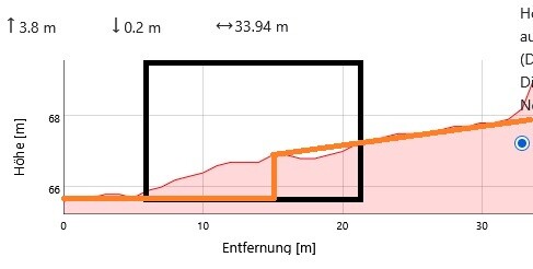

Based on the driveway and the garage floor, it’s as shown in orange in the attachment. What ground elevation would a surveyor typically use where the plot is built on or fully sealed across its entire width?
The motivation will be to have windows in the lower floor at the back on the hillside.
He does have that, correct. It’s just very dark, because above there is the raised terrace of the garden floor and even beneath the terrace, the terrain already slopes up toward the garden.
