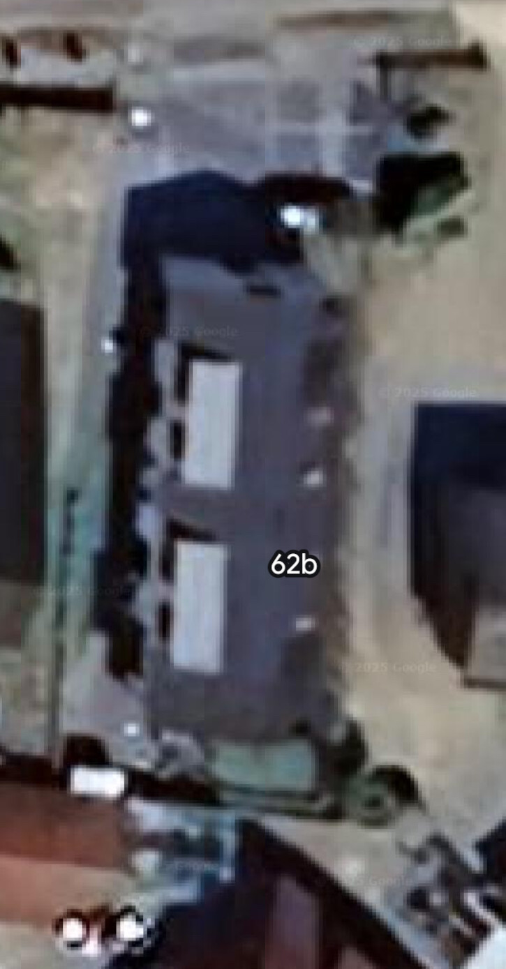

Do you know of any similar houses, possibly with a name to look up on Google or something like that? In our area, there is a very narrow plot that was developed like this:
At the top (north) is the street with parking spaces, the entrances are on the east side, and the gardens are on the west side. They are attractive houses. The entrances are set in bay windows, which are allowed by the regional building regulations. On the west side, there are two dormer windows for two bedrooms each. The plot is flat.
