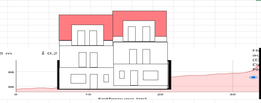

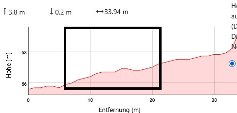

GregorBerger22 May 2025 09:21hanghaus2023 schrieb:
Could you please provide a height profile for the entire plot? Not just the building area.Attached. I’m quite surprised myself how accurate the data is. The steep rise on the far right of the profile shows the retaining walls leading to the higher neighboring property at the back. G

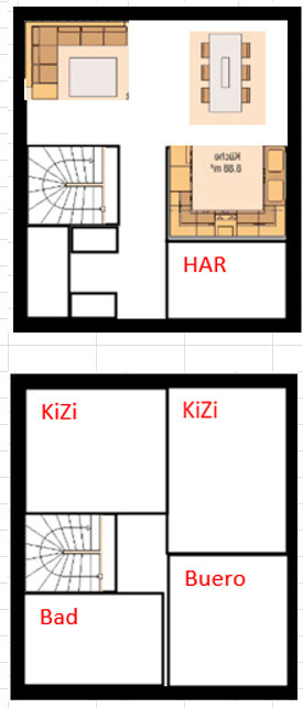

hanghaus202322 May 2025 09:55@ypg already calculated the living area without room partitions, etc., per floor to be about 53 sqm (570 sq ft), which, based on experience, results in approximately 45 to 48 sqm (485 to 515 sq ft) of usable living space including the staircase per floor. (It’s important to understand that a 3 m (10 ft) wall with a thickness of 15 cm (6 inches) uses about 0.45 sqm (5 sq ft) of space).
So, 2 floors would be around 90–96 sqm (970–1030 sq ft) plus the attic, which is the outcome of @hanghaus2023’s study in post 33, and technical rooms still need to be accommodated.
Just to give a clear idea of the dimensions involved.

GregorBerger22 May 2025 10:56ypg schrieb:
There is certainly a good reason why you haven’t found what you’re looking for with these houses: your space requirements. Well, there are quite a few houses with under 50 sqm (5 feet) of living space on the ground floor and 6 rooms. The difference is that they aren’t square and usually have more than just two floors like the typical "urban villa" style.
Yes, but at some point, you have to break the mental loop and consider whether a huge effort with many compromises is really worth it to achieve something that no longer matches the original wish. That’s true, but our wishes are flexible. The starting point was that the plot allows for 127 sqm (1365 square feet) footprint and 3 full floors (+ attic + possibly a basement on a slope). That results in something between 400 and 500 sqm (4300–5400 square feet) of total floor area – which is definitely more than enough for two families with a total of four home offices.
I don’t assume you’re planning to give part of the plot away to your friends out of kindness, so this must be a financial issue. How much was the plot? Half a million. And yes, exactly. You want to make good use of this centrally located, wonderfully situated plot. Not down to the last square centimeter, but certainly more than just for a 6-room single-family house. The neighbors have done the same, but not as a semi-detached house—they went for duplex or multifamily houses instead.
And how much of that cost is accepted by the building partners? One party will definitely get the short end of the stick here. ypg schrieb:
It’s becoming clear: the rear part will lack a floor that the front part has. That’s correct, but it’s not a dealbreaker. There is no requirement for the two halves of the semi-detached house to be completely identical.
And on these footprint dimensions, I don’t see your stated room program fitting. So you’d necessarily have to build upwards. That’s okay. I’m no enemy of stairs. The idea is also to have the home office on its own level, as far away as possible from the ground floor bustle.
Then you’ll just barely fit your room program. But I warn you: no one should come back saying that a straight staircase, a pantry, or a walk-in closet have always been a dream and that you want to realize one or two of those wishes. None of those are our wishes. Those would have probably come up in the floor plan form, but we’re not at that stage yet…
So, what about the building partners? Don’t they have any room program? They would have one floor less!
You can of course add a creative third floor and then an attic. I believe that choice was open? Roof pitch 35–45°, ridge direction flexible, dormer or inset up to 50% of the width.
The question I have is: what were you thinking when you bought the plot? I mean, there probably was no planned semi-detached house yet? Yes, there was. With a fallback option for a two-family house, a multi-family house, or a single-family house. The single-family would push our budget to the limit. The bank is willing to lend more money for a multi-family house because they factor in hypothetical rental income and tax benefits.
Also, in my opinion, the differences and disadvantages for the front unit are significant and not something you want to live with for the next 20 years. The division to the rear unit is very large. The “little guy” will be watching as the person in the upper unit passes by their house and 40 sqm (430 square feet) garden on their way to their own 200 sqm (2150 square feet) space. Beyond that, there’s an implied arrangement that you basically have to pay for everything for the other (slope maintenance, retaining walls, etc.). No friendship can survive that, mark my words! You’re correct about the situation, but that has been communicated and agreed with the building partners from the start. They can, however, withdraw with less pain (unlike us); we bought the plot alone first.
My suggestion: place a nice two-story house there. Use the garden on the upper floor for yourselves. That way, you also have space downstairs for a bike storage. You could possibly plan a granny flat. But you would have to borrow expensive money for the granny flat, which might not pay off. Here are the two residential units of a duplex with their ground floors and garden shares. That looks very interesting, but I don’t fully understand it yet. Two stories plus basement on a slope + upper floor (garden level) + second upper floor? Flat roofs are not allowed, so is there an attic on top? Where is the separation line between the two residences?
