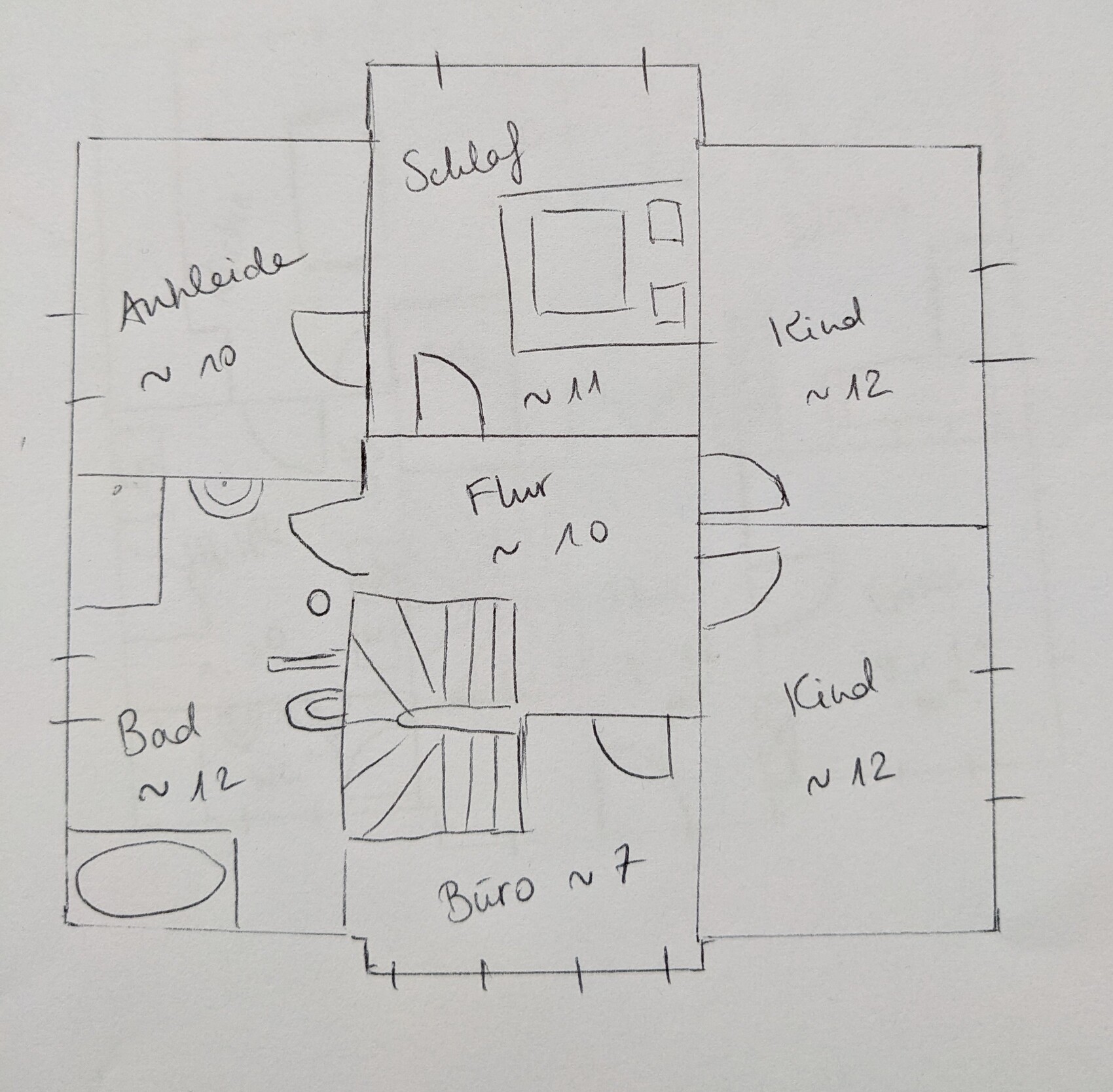

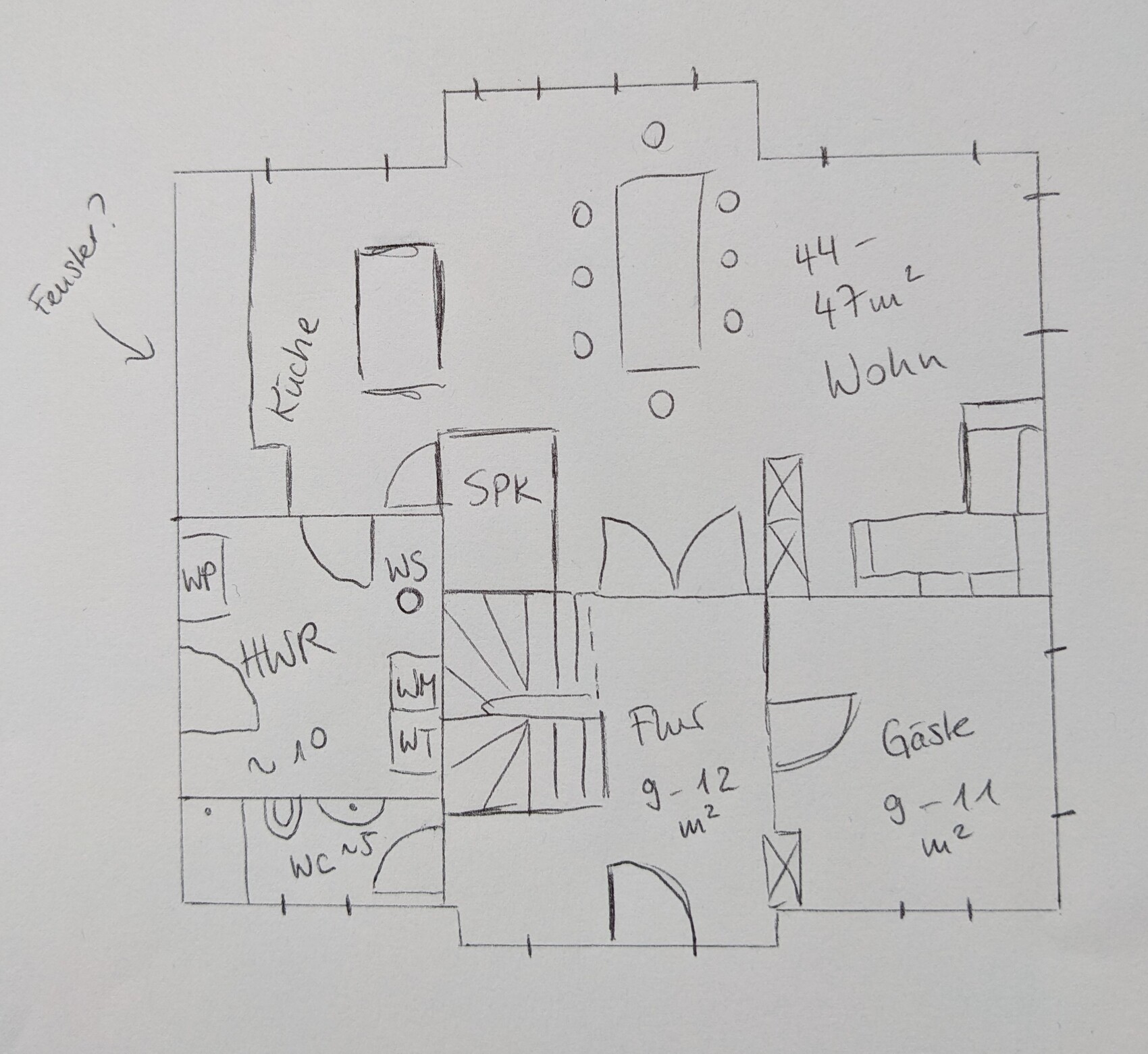

The client quickly sketched a floor plan by hand and actually didn’t want it uploaded (she thought it turned out too ugly), but I’m sharing it anyway since it’s only about the general layout of the rooms. The room sizes aren’t accurate, but this is just what we’re giving the draftsman so she can create a proper version. We’ve now decided on the option “hallway without windows” on the upper floor. A door with glass in the office should solve the “problem” — which we didn’t really see as an issue in other houses anyway. What do you think?
WS = laundry chute (since the long distances for laundry were rightly mentioned here). WP = heat pump. Washing machine = washing machine. WT = clothes dryer.
Sketchy floor plan of an apartment: kitchen, living room, hallway, guest room, WC, utility room, stairwell.
Sketchy floor plan: hallway connects bedroom, dressing room, office, and three children’s rooms; bathroom on the left.

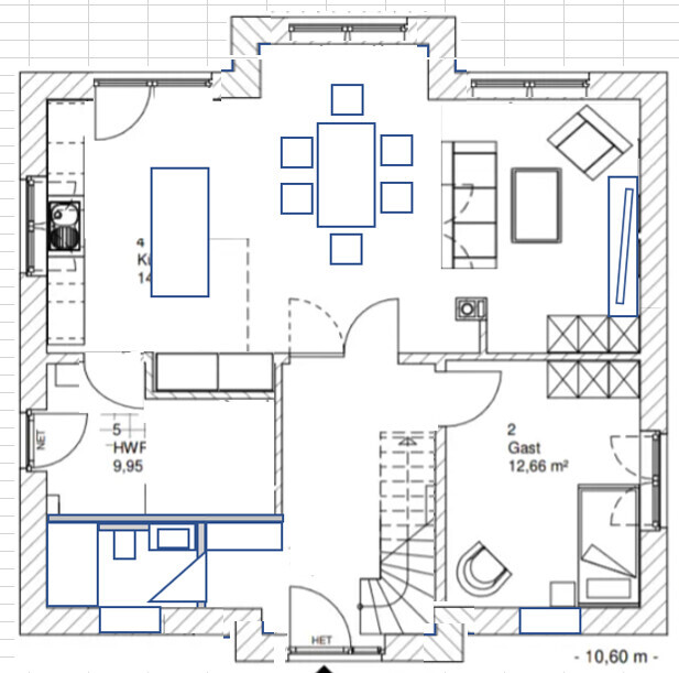

I have made some changes to the ground floor. The utility room can still be adjusted to include a pantry.
Grundriss eines Apartments: Küche mit Insel, Esstisch, Wohnzimmer, Flur, Gastzimmer, Treppe.

It may be frustrating, but 12m² (130 square feet) for a children’s bedroom is borderline. Especially when you have a walk-in closet of 10m² (108 square feet). It also says something about the priority given to the children when the wardrobe space is almost as large as the rooms where a 16-year-old lives.
K a t j a16 Apr 2023 08:06
I apologize in advance if I am asking questions that have already been answered. I haven’t followed everything closely. But why do you now have 2 children’s bedrooms?
Can the guest room not also serve as an office?
