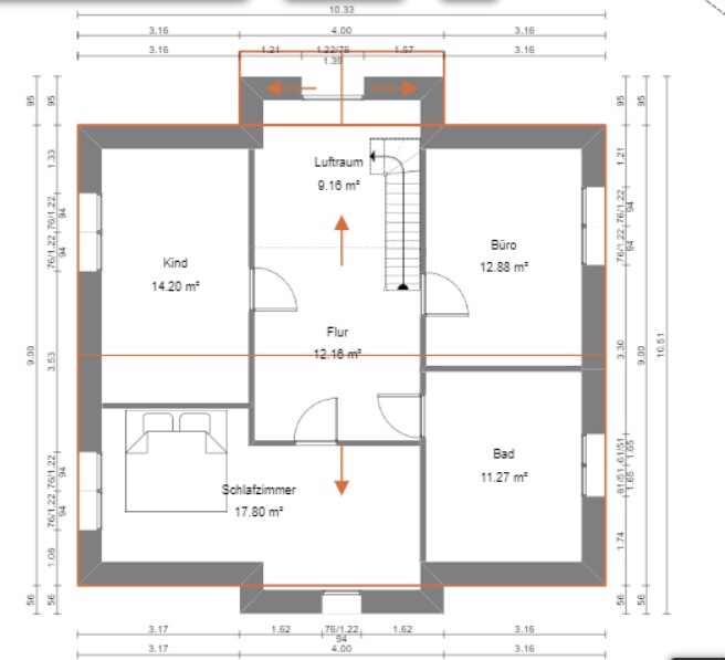

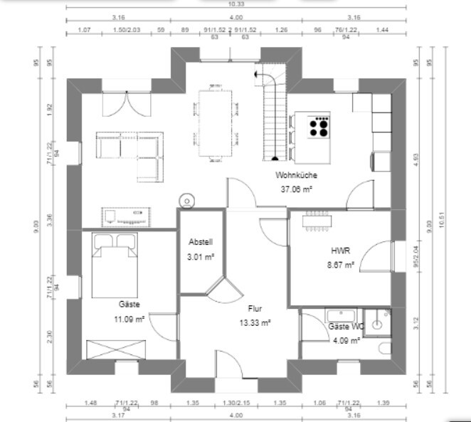

Floor plan attached. For the reasons you mentioned, ypg, we mostly stuck to the design of a general contractor and only made adjustments. The calculated room sizes shouldn’t be taken literally because the quick sketch platform doesn’t account for sloped ceilings. I’m not an expert drawer, but I think you get the idea and a professional would check it for feasibility. Windows and doors are roughly marked for now.

hanghaus202321 Jan 2023 10:55Your floor plans are quite unusual. A staircase in the middle of the open-plan living area that ends in the open space above?
And a kitchen with seating doesn’t fit there either.
The dining table would be cramped.
The sofa would be tight, especially with the fireplace.
Master bedroom... depending on the roof slope, the left side of the bed can only be accessed by bending down, overall the space for the bed is very narrow.
Overall, the floor plan wastes a lot of space on hallways, yet there is no proper cloakroom area on the ground floor.
A site plan with a north arrow and the fitted floor plan would be very useful.
