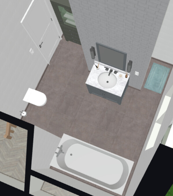

Nice-Nofret20 May 2023 12:06... and it would also be advantageous to move the door to the utility room about 70cm (28 inches) from the bottom of the plan; this significantly improves the kitchen layout.

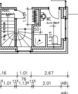

Oops, @ypg is absolutely right. The staircase is more than critical. The designer should realistically show it with a cross-section, etc. This won't work as is. Has any designer actually ever worked on this, or is it still a self-created draft? I think this is typically an unverified tracing of a self-created draft by the draftsman, relying on the structural engineer who, however, does not correct such aspects...

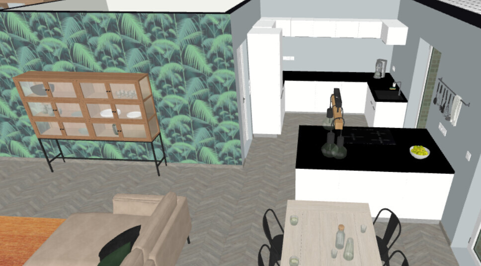

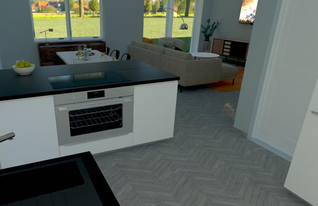

The pictures in #284, copied from the draftsman's drawing to test the 3D furnishing. ... I will never understand why anyone does a 3D proof if the head clearance issues don’t become apparent.

What is the door in the staircase for? You will need to access your small storage room differently. For example, through a passage from the utility room. This kind of thing, along with the odd cloakroom niche in the staircase, actually serves as the best illustration of 2. the value of an architect’s planning instead of just a draftsman’s, and 1. the nonsense of 3D design when used without proper understanding.
Five risers reduce the height by more than 90cm (35 inches), which can easily be figured out mentally (elementary school math word problem: Little Fritz climbs the stairs in a house with a clear ceiling height of two and a half meters (8 feet 2 inches) – how tall can Little Fritz get without hitting his head when the floor slab extends over more than five steps?).

So: everything is fine. Plan your bathroom as you imagine it… but design the stairs according to the minimum standards and include the required stairwell opening, so they are at least safe and you can get furniture upstairs.

By the way, I asked about the furniture because I find it hard to picture the open-plan living space. The dimensions for kitchen and living area seem a bit tight, even though the room is large. Also, there is no cloakroom. Enough has been said about the clutter around the stairs.

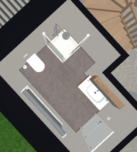

I’ll try not to leave out any points this time, since there was (thankfully) a lot of feedback 🙂 Regarding the bathroom and toilet seat: of course, the toilet seat itself wasn’t decisive for the planning 😀 It was more about why we preferred our plan over the version suggested by @hanghaus2023. And that was just one point among others (such as the shower overlapping the bathtub or expecting a wet floor in the middle of the room).

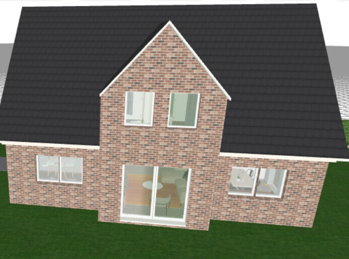

The floor-to-ceiling height is 2.75m (9 feet) in the shell construction. The guest WC does have an oversized window, that’s true, but that’s due to our wish for a symmetrical exterior view 🙂 See the pictures.

As I said, the toilet seat wasn’t a requirement, just one of the reasons why we weren’t entirely convinced by your proposal. I don’t think our preferences are all that unusual, but every family is probably different (see the shower discussion)... So far, there are no section drawings. I’ll share a detail from the professional plan; I’d rather not upload the full plan without prior consent, as there are different needs regarding copyright and so on.

I think that has to do with my software, which can only display the staircase as it currently is. Take a look at the professional floor plan — it looks to me like it should be fine?

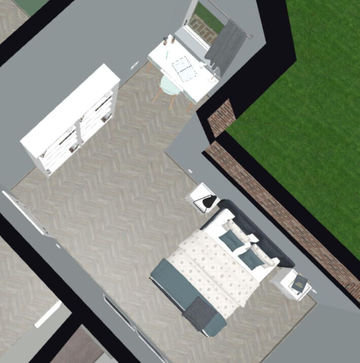

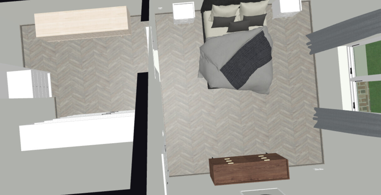

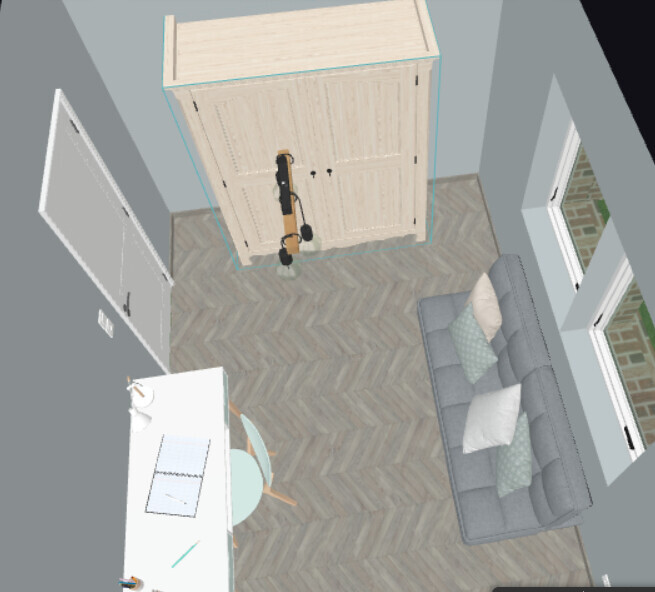

We used the 3D planning to check if our furniture fits in the house. And to try out a jungle wallpaper and other silly little experiments 😀 And of course, simply to help visualize everything. Whether there’s enough head clearance under the stairs will hopefully be checked by the experts (e.g., the structural engineer who approves it).
