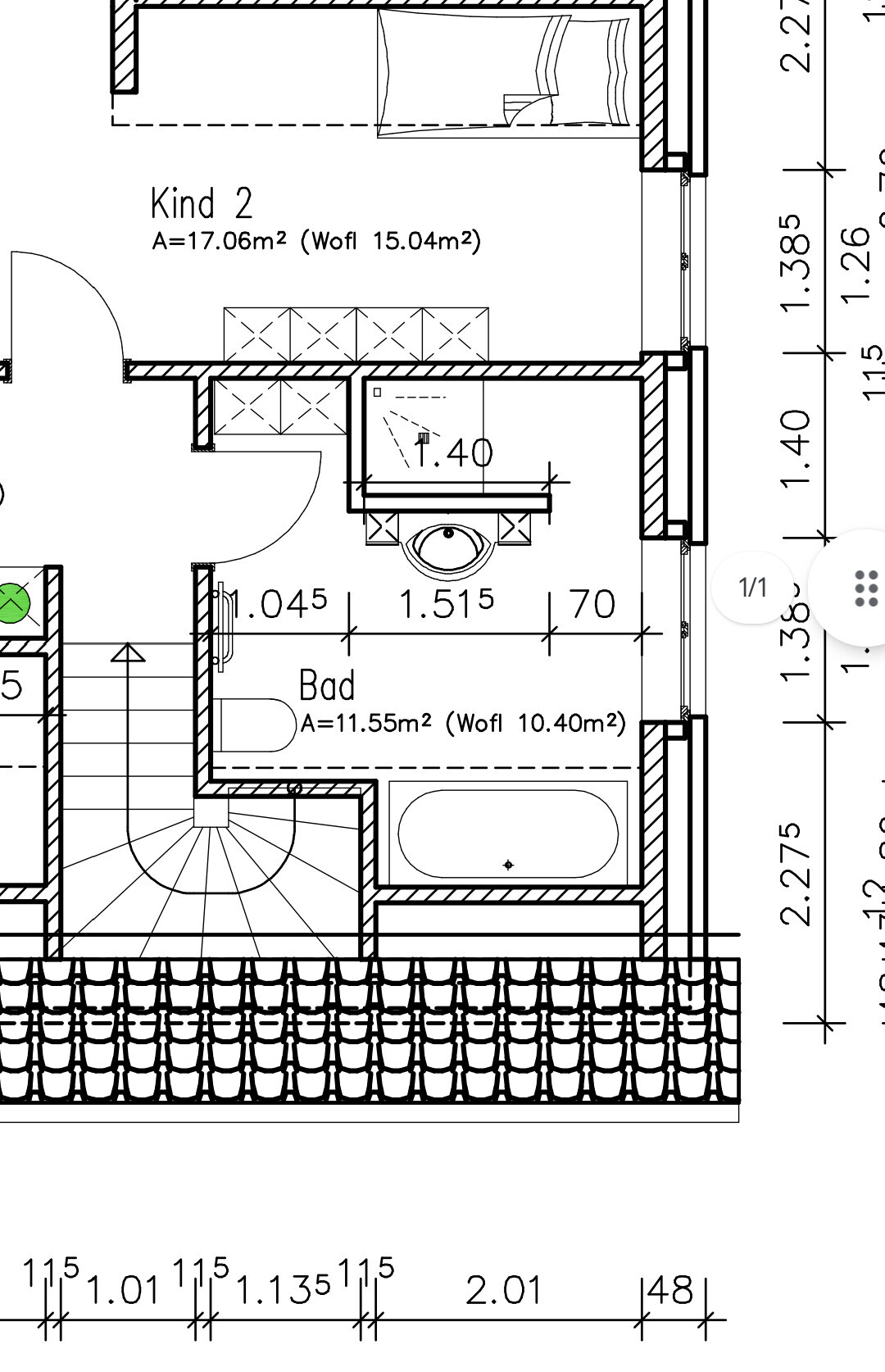

schmeissrein schrieb:
The draftsman has given the bathroom a sense of dignity 😀 we are very satisfied! Yes, the bathroom looks very tidy and should work well. Apparently, even more changes were made when you compare it to #242.
Personally, I would swap the shower entrance so that the sink is placed by the window. This has advantages, but possibly the disadvantage that the center of the bathroom might get wet from the showering area. However, this can be reduced by using a shower mat.
Advantages: users of the sink won’t block the middle of the bathroom, there is more natural light, and those showering don’t have to pass directly in front of the window. I also see that the towel rack is planned to be within reach near the toilet.
