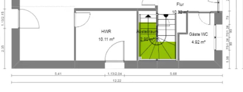

@hanghaus2023 Thanks for your input! We prefer not to have the toilet and the sink next to each other (I’d like to link a rather unpleasant article where researchers visualized the germ cloud stirred up during flushing, so we like to keep some distance from our toothbrushes 😀I’m wondering how the tens of millions of people have managed so far with their toilets close to the sink. Somehow, I get the impression you have some unusual planning requirements. Why don’t you mention them beforehand? That would save everyone some effort.What is the ceiling height on the ground floor? A cross-section could help. Have I missed one so far?
hanghaus202320 May 2023 09:57I have looked at it again, and your argument doesn’t hold up. Your toilet is 1.5 m (5 feet) away from the sink. If YOU place the toothbrush holder on the left side, it’s actually even a bit further away from me. :p
Of course, you can also fully separate the toilet, which is even possible in my design. If someone has such particular preferences, they should plan a separate WC.
You can also go downstairs, where you have a separate toilet. 😉
hanghaus202320 May 2023 10:13This is the most nonsensical thing I've seen here in a long time.
Access to the storage room? The door won’t open because there is a staircase in the way.
The strange niche next to the stairs is unusable. What is the layout for the ground floor toilet supposed to look like? Is there already a plan for it?
Why don’t you show us the plan from the draughtsman?

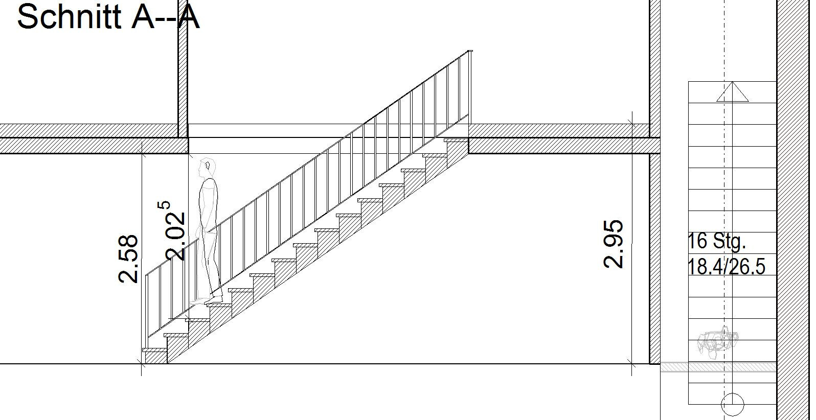

hanghaus202320 May 2023 10:22kbt09 schrieb:
Yes, this small snippet of the drawing isn’t helpful at all. An appropriate cross-sectional drawing would be useful.
To demonstrate what it’s about:
Even with 2 to 3 step overlaps, headroom becomes critical, especially when walking down the stairs.Referring to DIN 18065 doesn’t help here either. It states a minimum clearance height of 2 m (6 ft 7 in).Similar topics
