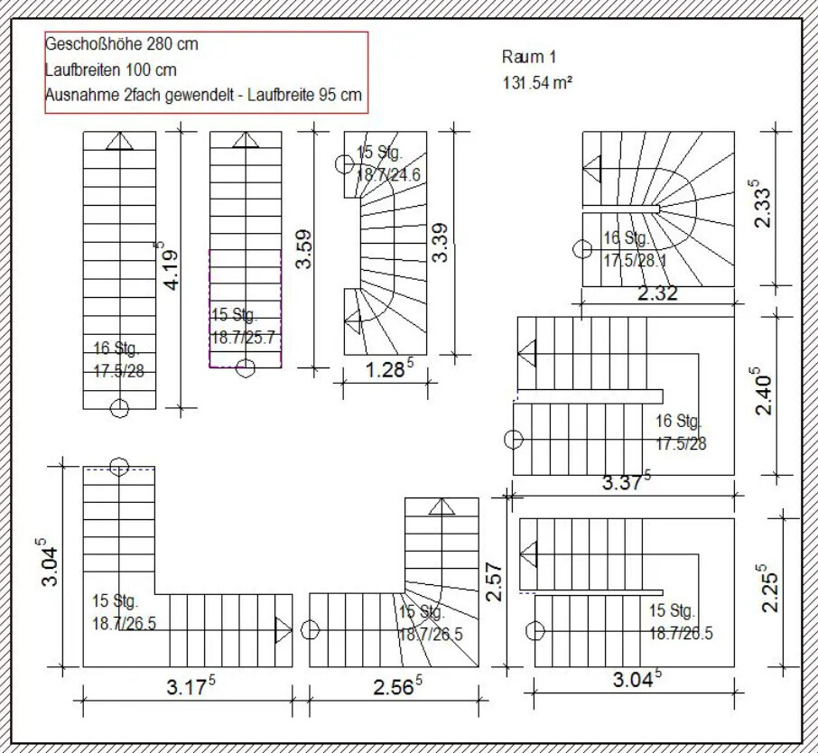

I would never design a single-family house with living spaces upstairs with a length under 3.70m (12 feet).
Technical floor plan of a building with stairs, dimensions, room 1 (131.54 m²).
Available here:
