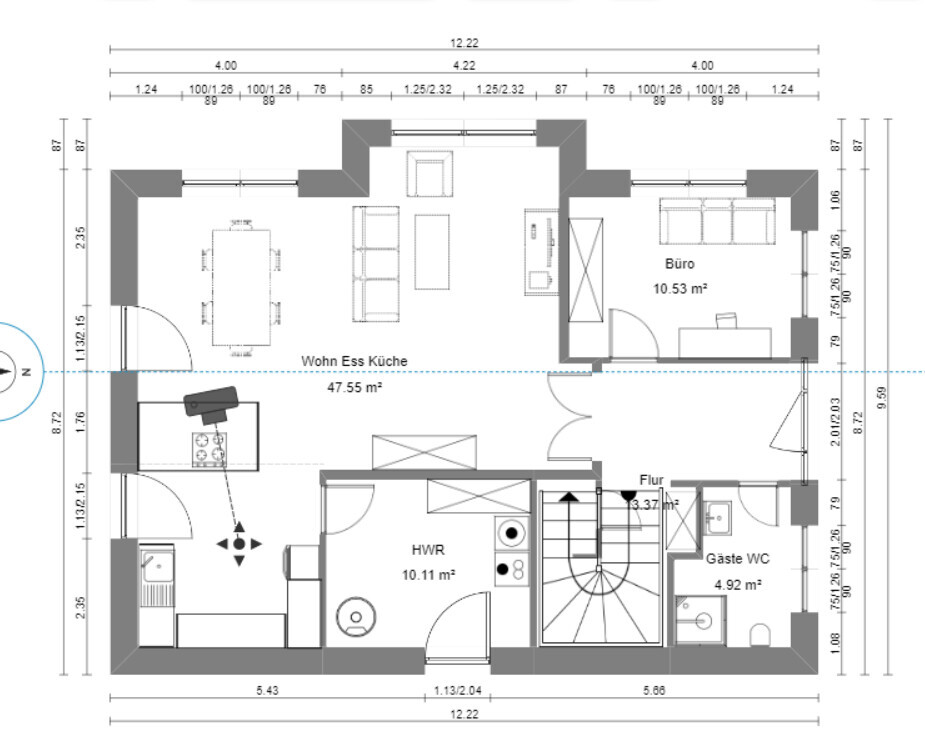

Could you please provide a sketch as well? A furnished floor plan?
We are less interested in the patterned wallpaper and more in the dimensions and distances 🙂What, how can you not be interested in those 😀? Please don’t pay too much attention to the staircase here, there was no shape like the one we have planned.

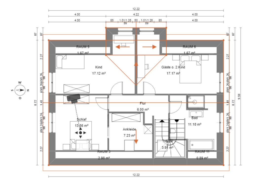

@schmeissrein ... you’re not seriously expecting anyone to provide a feasibility assessment of your staircase based on the snippet labeled "professional drawing" from post 300, are you? The precise measurements are missing, and it looks either very tight or quite steep with a maximum tread depth of 25 cm (10 inches). What is the floor-to-floor height, not the rough construction height, of the house?

@schmeissrein ... Surely you don’t seriously expect anyone to give a feasibility assessment of your staircase from the snippet labeled "professional drawing" in post 300. The precise dimensions are missing, and it either looks very tight or quite steep with a maximum tread depth of 25 cm (10 inches). What is the floor-to-floor height, not the raw construction height, of the house?No, I don’t expect that from you, but from the construction team later on 🙂 I thought the drawing might help reduce your concerns somewhat, but of course, our contractors need to judge it. The floor-to-floor height should be about 256 cm (100.8 inches), but I wouldn’t bet on that number, sorry. I’ll know more once the sectional drawings come in.
Well, at least the staircase with the shortened starting side fits better than one with equal tread lengths. I think this clears up some of the misunderstanding.
Whether the staircase works was probably not @schmeissrein’s question (I don’t recall), but rather a consequence of the program’s incorrect drawing.
What I personally don’t like about the house, whether you take anything from it or not, is up to you:
There is no east-facing window. The utility room is therefore unpleasant to enter—why would anyone want to access the house through it? I take off my shoes first and then handle the groceries, which are mostly stored in the refrigerator. The kitchen is far too dark. I also find the dining area much too dark.
The kitchen layout feels too divided and therefore the work triangle too large.
The walk-in closet accessed through the bedroom doesn’t make sense. The door is positioned just under the 2-meter (6.6-foot) line.
I’ll leave the bathroom out since that has already been discussed.
