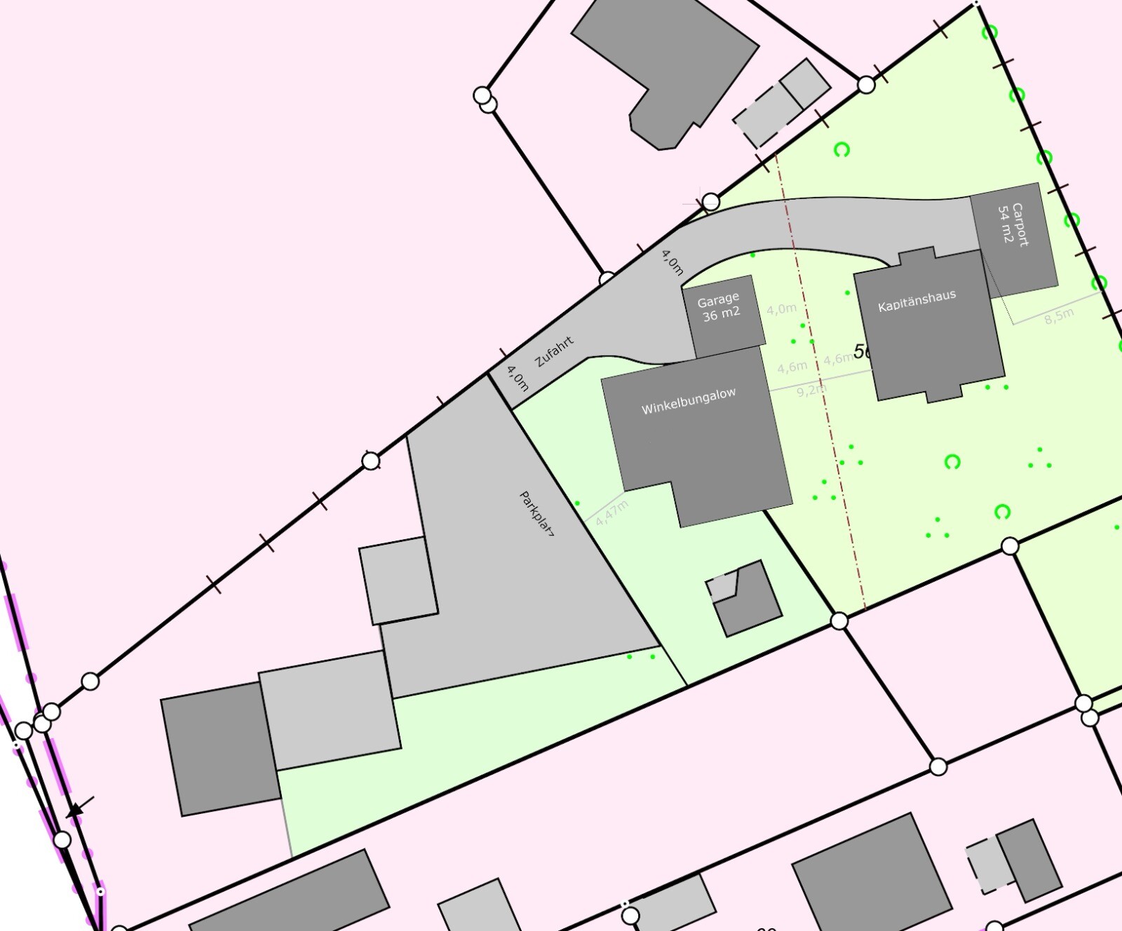

It’s not necessary either; the draftsman just noted it there for now, and I uploaded it so people could get an idea of the connection situation. Whether the house is later shifted a few meters (yards) to the side and rotated slightly doesn’t make a significant difference for that.On the contrary, if you hadn’t been so stingy with the plan excerpt, we could have already had a more creative discussion about this.https://www.instagram.com/11antgmxde/
On the contrary, if you hadn’t been so stingy with the plan excerpt, we could have offered more creative advice by now.To revive this topic: less stinginess is coming. We have now obtained several quotes, developed and discarded floor plans, and finally oriented the houses on the plot. Progress is slow for various reasons, but I’ll spare you the details.
Angled bungalow: Entrance, hallway, bathroom, and guest toilet on the north side. Kitchen faces west. Living room towards the south/east by the terrace.
Captain’s house
Ground floor: Hallway facing north. Utility room and guest toilet in the northeast. The entire south side is an open-plan space. Upper floor still unclear... Two captain’s gables look nice but make floor plan design surprisingly challenging.
What do you professionals think? 🙂
schmeissrein schrieb:
The upper floor is still unclear... two gambrel gables look nice, but they make the floor plan design surprisingly difficult. No one needs a second captain just for the reverse maneuver. I don’t understand the second part of the sentence.https://www.instagram.com/11antgmxde/
Ah, "need" and need... Of course, you don’t really need it, and we seriously considered leaving it out. But the front gable creates that "I always look forward to coming home to my beautiful house" feeling, and the rear gable provides a nice small bay window in the open-plan area and a room upstairs facing south without sloped ceilings. The downside with the floor plan upstairs is that either the north gable has the corridor, which wastes space, or there is a very small room (which we don’t really need) that blocks the possibility of natural light in the corridor. I think it will probably be the latter, as natural light in the upstairs corridor is likely not that important. But for now, the focus should be on the orientation of the houses 🙂
