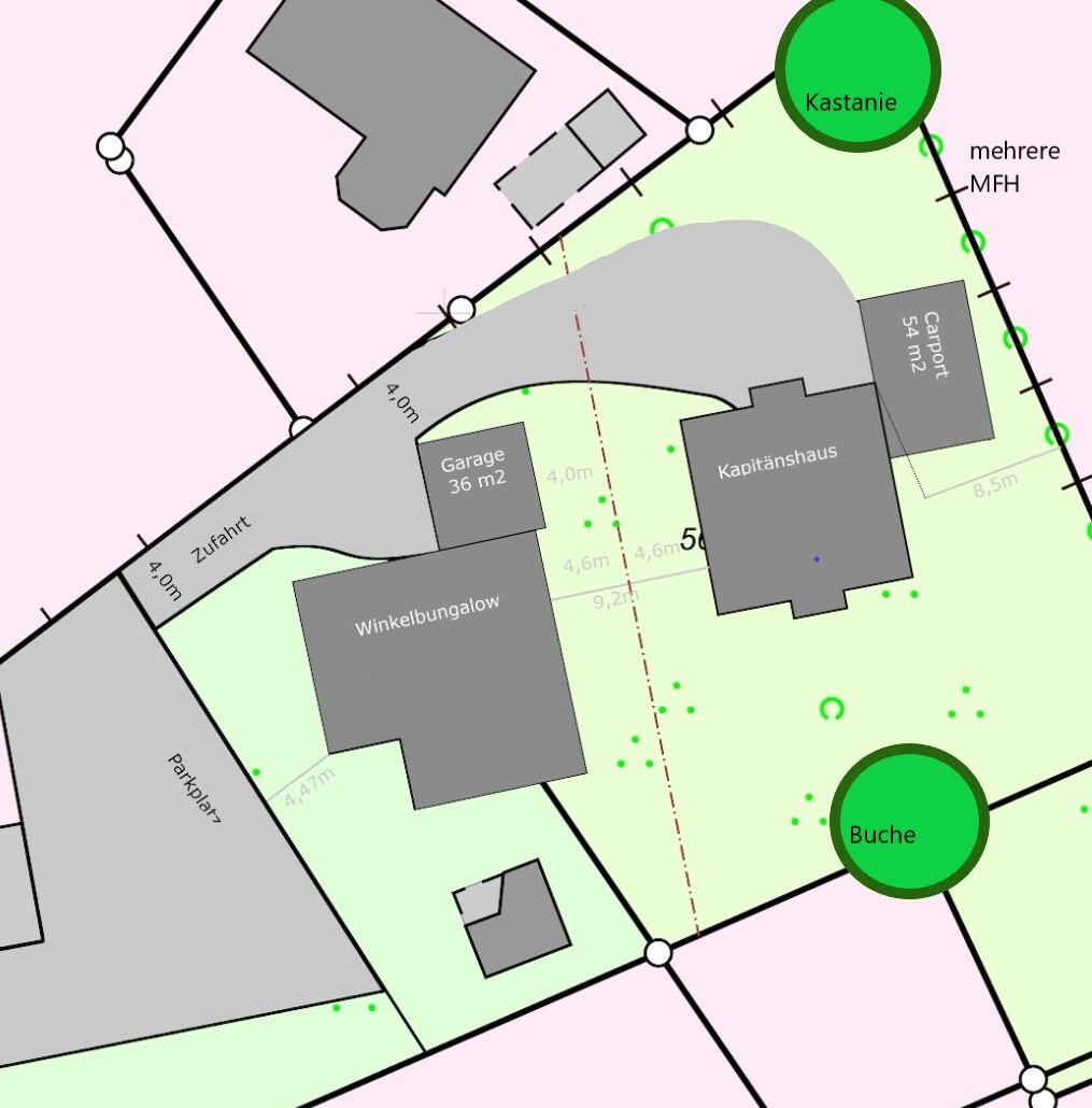

@Nida35a I received the exact reaction labeled "angry" to my post, so I definitely assumed there was anger involved 😀 That’s okay if someone is annoyed by an original poster, but then I’d rather skip the topic instead of snapping at them if I consider them hopeless anyway. Here is the plan with the trees on it 🙂 We just need to find a reasonable spot between the two.
@hanghaus2023
I made the driveway a bit more rounded and wider; do you think it’s enough space to turn around? We’ll still move the carport slightly north. Right now, I’m mainly concerned about the orientation regarding the cardinal directions.

Stefan0015 Apr 2023 12:34How do you drive the cars into the carport? Is it 6 x 9 meters (20 x 30 feet)? In that case, you would definitely need to have the driveway accessible from the narrow side.
Then there is the question of the setback distances. It looks to me like it is less than 3 meters (10 feet) from the neighboring property. Is it allowed to fall short of the setback requirements, or would a full boundary construction (i.e., directly on the property line) be necessary?
