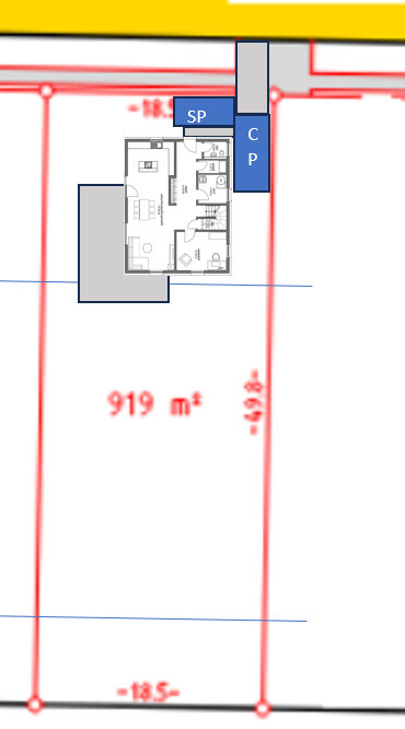

hanghaus202328 Aug 2024 12:42H
HäuschenAmFeld28 Aug 2024 12:52Thank you, Hanghaus, for the visualization; it actually doesn't look too bad.
ypg is right, of course—there wouldn’t be much space for our guests’ cars in this design. That could be problematic since the street itself doesn’t offer much room, and a sidewalk is planned in front of the property, which means no parking there either.
hanghaus202328 Aug 2024 12:58H
hanghaus202328 Aug 2024 13:07With one more parking space, the house needs to be slightly shortened. Instead of 11 m (36 feet), it would be 10.5 m (34.5 feet). This way, in an emergency, a car can park in front of the entrance. Alternatively, the entrance could be moved to the east side.
HäuschenAmFeld28 Aug 2024 13:14Then the carport would also have to be set back, right? Otherwise, I don’t see how I could access the parking space(s) without getting a dent somewhere on the car.
