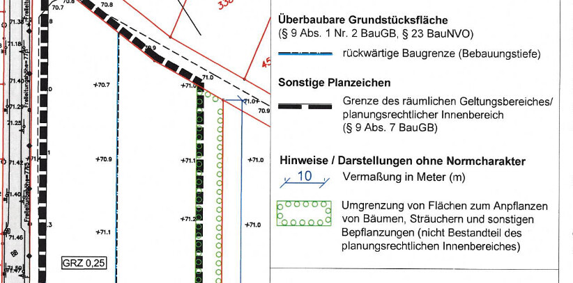

HäuschenAmFeld28 Aug 2024 11:33Hello everyone, there have already been lively discussions here, which I’m glad about!
I will try to attach a section of the regulations. The individual areas are marked there, so you can better see what I mean. Up to the blue line is 20m (65.6 ft).
Therefore, the idea was to position the house as far forward as makes sense to create a large garden, even if we plan a terrace at the back of the house. Of course, I am open to other suggestions.
What I have noticed while reviewing various floor plans is that many houses with rather elongated rectangular layouts are not aligned like our plot. They are designed so the long side likely faces the garden (living-dining area), which I don’t find ideal for our plot.
The parking spaces on the right side of the house were planned only because the driveway will be directly at the right edge of the plot. This way, you can drive straight in and have short distances for groceries, etc. Parking on the left in front of the house (with the main entrance facing the street) would also be possible. (Or something entirely different, but then you have a lot of “wasted space” by the street — we wouldn’t want to sit or spend time facing the street, for example.)
These are exactly the considerations we have, and I am glad to hear some real experiences already. It shouldn’t be too cold because you often sit for a longer time if bigger repairs or conversions are planned on the bike, or even when cleaning and oiling the chain—where you inevitably work with water and cleaning solution. We certainly don’t need 20°C (68°F) for that, but 0°C (32°F) is too cold, especially since cold rises from below. The advantage of the garage/carport solution is, of course, that you don’t have to carry the bikes through or into the house—unless they are hung on the wall there, which the homeowner likes but the homeowner’s partner finds rather inconvenient.
The large technical room would be great. Warm enough, you can quickly wash your hands properly, etc. There would also be space for the future homeowner to hang her dirty stable clothes somewhere other than the hallway. Unfortunately, only riders find the smell of the stable pleasant. The downside remains that the house would have to be bigger than “necessary.”

K a t j a schrieb:Of course, the plot measures exactly 18.5 x 49.8m (61 x 163.4 ft), with the shorter side facing the street.
Unfortunately, I can’t read the dimensions of the plot. Could you please share them again?
ypg schrieb:The construction at the front was planned this way because the supplementary development plan allows building only within the first 20m (65.6 ft) from the street, and we cannot use the last 7.5m (24.6 ft) at the back as garden since it must remain a compensation area where hedges and trees have to be planted.
With so much space, I would never plan so sparingly at the front of the plot.
