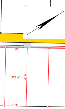

Hello everyone, from an enthusiastic lurker.
My partner and I were initially looking for an existing property and had already viewed several, but hadn’t found anything convincing. Mostly, the houses were either too small or much too large, requiring extensive renovation and modernization. By chance, we came across an offer for building plots in a location that suits us, and we have reconsidered the idea of new construction. First of all, here is my completed questionnaire:
Development plan/restrictions
Plot size: 919m2 (with restrictions, e.g., a compensation area with specific planting must be created over more than 7m at the rear part of the plot)
Slope – no, or at most minimal
Site coverage ratio: 0.25
Floor area ratio: (could not be found in the documents I have)
Building area, building line, and boundary: front 20m facing the street
Edge development: no

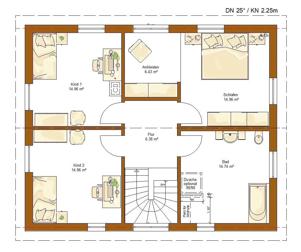

Who designed the plan:
- House company, it is a standard floor plan example
What do you like? Why?
- Everything fits well, kitchen connected to living/dining area (possibly the kitchen could expand further over a kitchen island?)
What do you dislike? Why?
- The upper floor doesn’t quite fit yet, the door to the “workshop” is missing, and we haven’t looked in detail at windows and patio doors; we are still at the rough layout stage.
Price estimate from architect/planner: no detailed figures yet, but something like this was presented within our budget. However, when calculating with the commonly assumed 3000€/m2, I don’t see how it fits; this matches our feeling that the house might be too large for us.
Personal price limit for the house, including equipment: around 400k for everything except the plot
Preferred heating technology: air-to-water heat pump with underfloor heating, we would like to use photovoltaics
If you had to compromise, on which details/features
- Could give up: basement, fireplace, space on the upper floor, workshop room (if we can find another winter-suitable solution), exterior landscaping except for a rainwater cistern
- Cannot give up: 2 offices, 2 bathrooms or at least 1 guest bathroom

hanghaus202328 Aug 2024 17:07@ypg I am simply showing how the house can be positioned. The floor plan used was just a placeholder. It didn’t come across to me that the OP wants to continue planning with a 10m by 8m (33ft by 26ft) layout.
hanghaus2023 schrieb:
@ypg I’m just showing how the house can be positioned I know. But if I say that you shouldn’t be so sparing at the front, and you start applying the restrictions after 20 meters (about 66 feet), while also messing around with the parking spaces in such a way at the top of the plan that it’s surprising anyone could ever park there without ending up with dented doors or even being blocked in, then it’s time to be straightforward and guide the process back on track.
So far, there is already a big question mark over the house itself, which means the front yard/forecourt should be left as rubble for now.
I would say: once you have a clearer idea of the house’s direction, you can continue refining the rest.

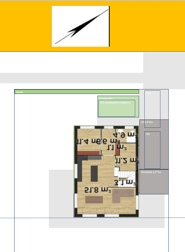

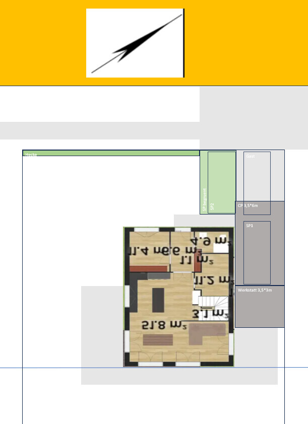

hanghaus202329 Aug 2024 09:53I took a closer look at it. My parking situation is due to the narrow 3 m (10 ft) driveway. With a 10 x 8 m (33 x 26 ft) house and a wider driveway, it would definitely be easier. I illustrated it with cars measuring 2 x 4.5 m (6.5 x 15 ft), but it should also work with 5 m (16.5 ft) wide vehicles.
@ypg I took the liberty of copying and mirroring one of your floor plans. Adjusting it to 10 x 8 m (33 x 26 ft) should be no problem for you.
hanghaus202329 Aug 2024 10:01hanghaus2023 schrieb:
@ypg I took the liberty of copying and mirroring one of your floor plans. Adjusting it to 10 by 8 meters (33 by 26 feet) should not be a problem for you. Yes, I had to chuckle. The design looked somewhat familiar to me.
With a 10 by 8 meter (33 by 26 feet) house That’s just a rough estimate of what the footprint of an affordable house could be.
As long as the original poster doesn’t engage with model homes or a homebuilder and comes back, I don’t think much more can be done.
The answer to the question was focused. Everything else now depends on a buildable house.
Personally, I don’t see any issue with a 3 meter (10 foot) driveway, especially since there is room to spread out on the property. I definitely wouldn’t arrange my parking spaces in a row, but rather let them be comfortably placed on one area. A gravel surface in front of a property offers quite a bit of flexibility.
