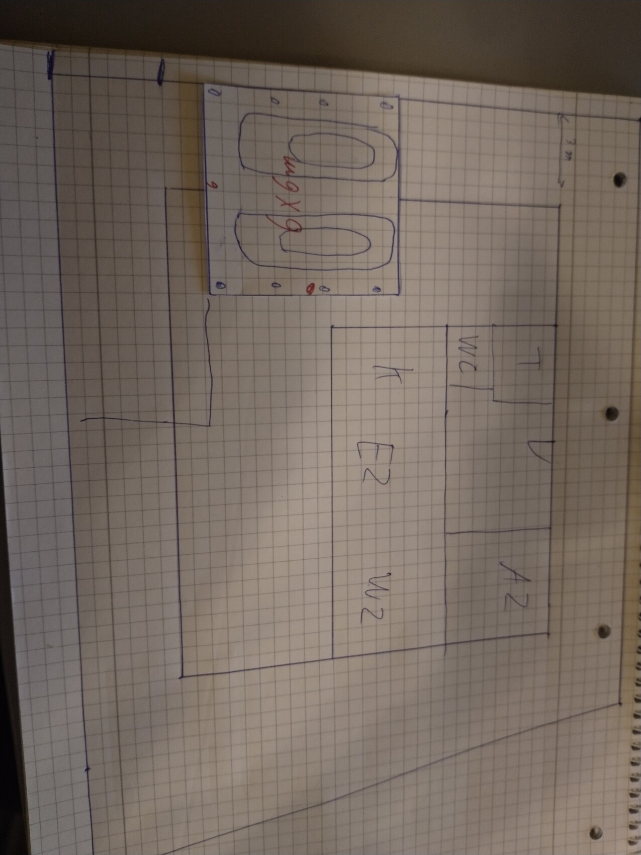

Planner: A pre-designed standard solid construction house from a builder company
(Since advertising / links are not allowed, I roughly sketched it; please forgive any errors)

I also find the floor plan unsuitable. If a car is parked on the 3-meter (10 feet) perimeter strip, you (and the delivery person, etc.) wouldn’t want to have to walk around it to get to the front door. That’s tight and inconvenient. The front door is better placed on the west side—ideally in front of the car.
What’s especially unfortunate about this layout is that neither the open-plan living area nor the office has windows facing east or west! You probably have the best (because unobstructed) view to the east, but you can’t see it. The west side of the house will likely be shaded most of the year by the neighboring house to the west, since the sun is quite low in that direction. However, you’ll surely find a spot in the garden with west-facing sunlight. By the way, you also get southern sunlight in the east-facing garden 😉 It only gets "dark," meaning without sun, in the afternoon when your own house casts a shadow. So I would mainly orient the house towards the east and south.
Do the cars really have to be able to turn around, or can you "learn" to reverse? Parking two cars in a row is probably not desirable, right? I’m currently considering how and where to arrange things best so that you don’t sacrifice your "small" garden with too much parking space. Although 450 m² (4,844 ft²) is considered a huge plot here in Munich. You should see what’s standard here nowadays. There, you really feel cramped. 😱

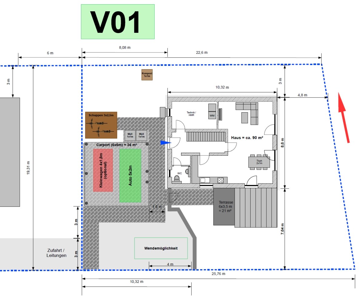

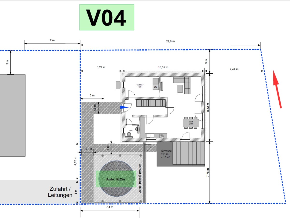

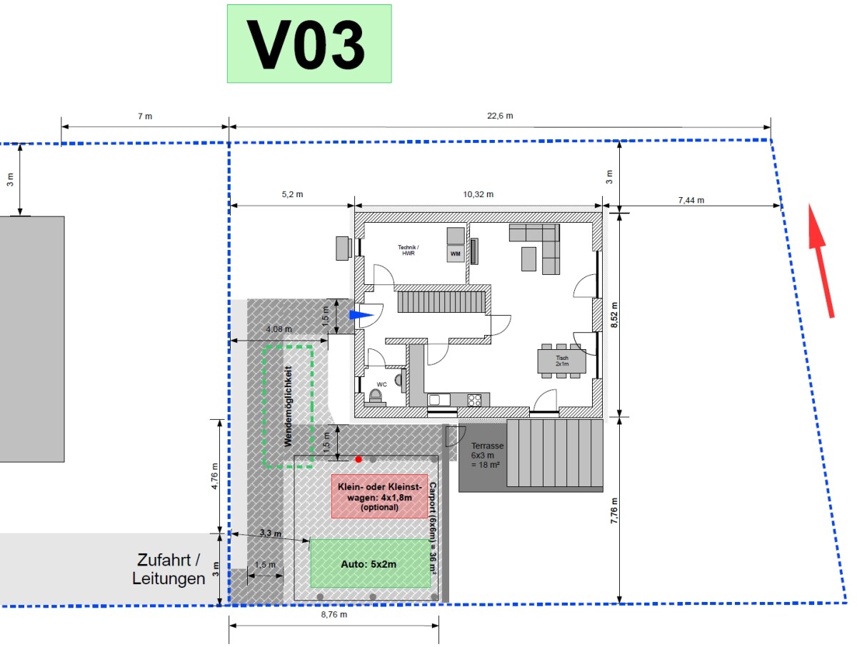

ChronoMax21 Mar 2021 21:38Hello,
Thank you for the ideas and suggestions. Could you please take another look at the following proposals? Version 01 mostly reflects what was suggested.
Changes to the plot: It is actually around 465 m² (5000 sq ft), and a distance of 12 meters (39 feet) must be maintained from the western neighbor’s house. This means the house should be set back 5 or 6 meters (16 or 20 feet) from the western boundary, depending on where the new house is placed.

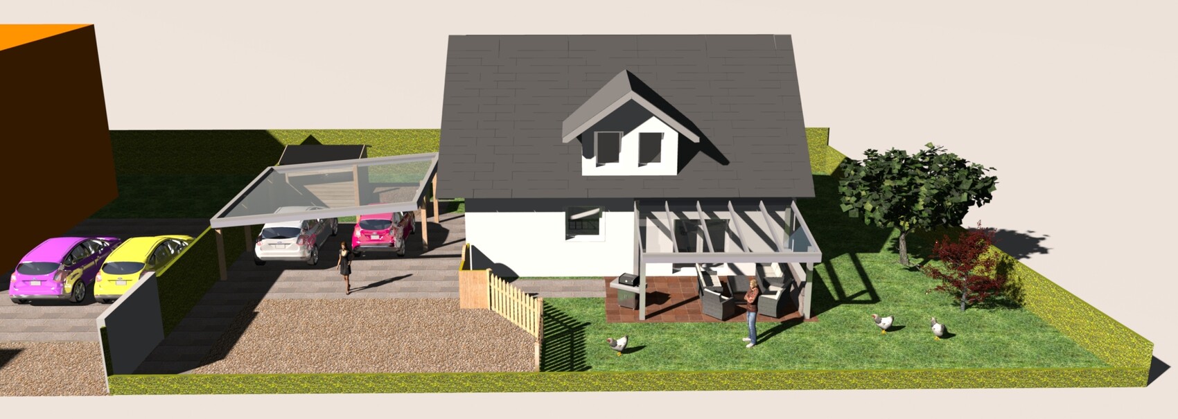

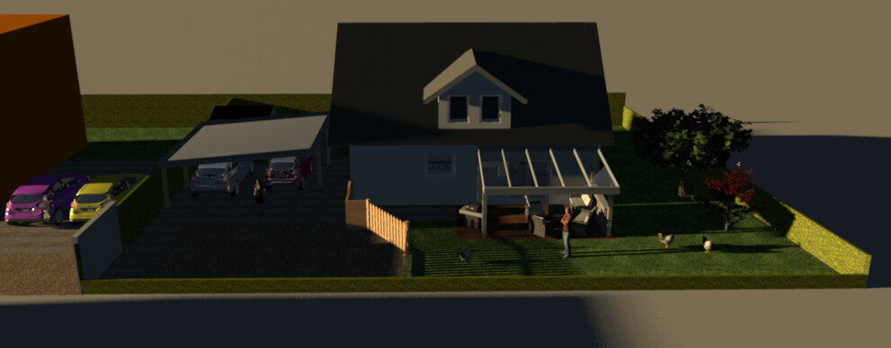

V01 in 3D
V01 in 3D: Evening around 7 PM in summer
V01 in 3D
