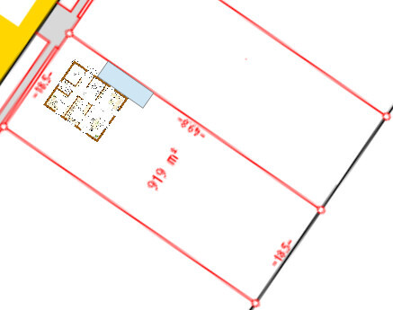

Plot plan with red boundary line and yellow area, building plot sketch

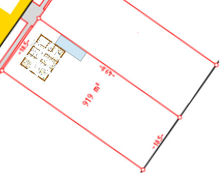

11ant26 Aug 2024 19:00
I quickly placed the ground floor plus a 3x9m (10x30 feet) garage on the plot (optimized for the short route to the utility room and a straight driveway):
Site plan of a plot with building area, red outline and measurements
Plot plan with red boundary line, building area marked in blue and measurements
K a t j a26 Aug 2024 19:45
Unfortunately, I cannot read the dimensions of the plot. Could you please provide them again?
