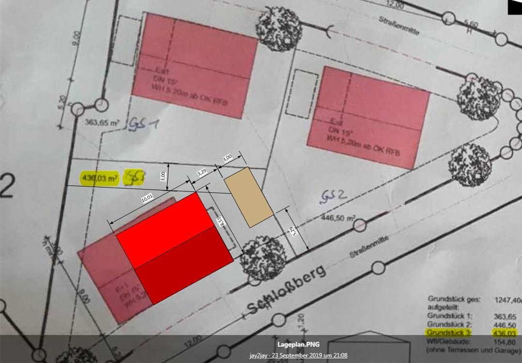

Between "this looks feasible" and "the measurements are off" there could be a causal relationship. Otherwise, I would generally approve it on my part.
In my assessment, this is a recently subdivided plot where both neighbors have the same builder contract, so coordination through them is possible; and judging by the aerial image, it appears to be a moderately sloped site.
[ATTACH alt="hbf-musb.PNG"]38402[/ATTACH]
I see the most likely location for a house about 9 m deep (30 feet) and 11 m wide (36 feet) marked on the site plan. I recommend the original poster review the link in post #7 again, as we’ve already discussed this in detail there. At the garage location mentioned in post #27, I would prefer a carport, otherwise the lot would have a dirty corner next to the garage.

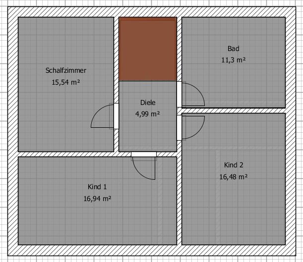

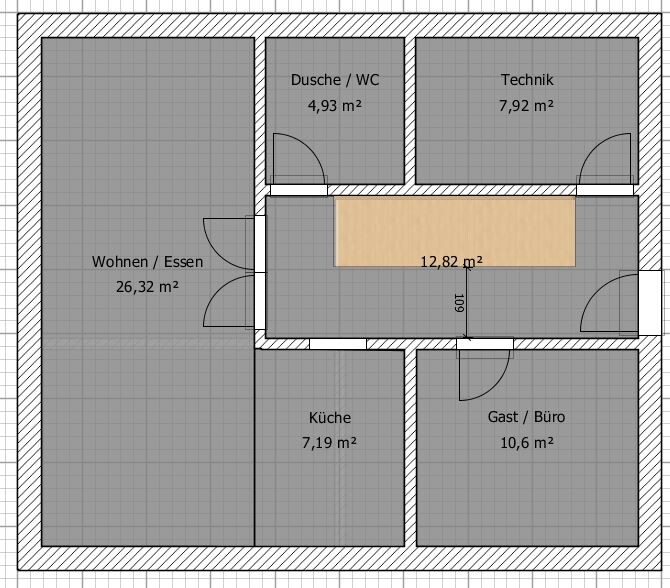

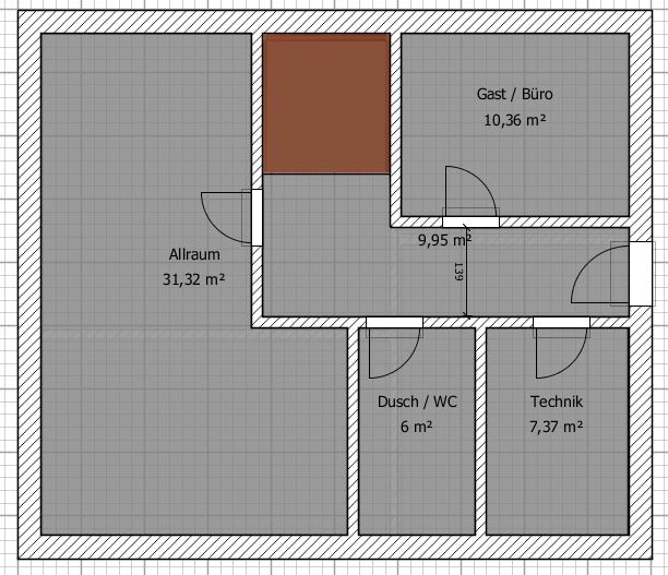

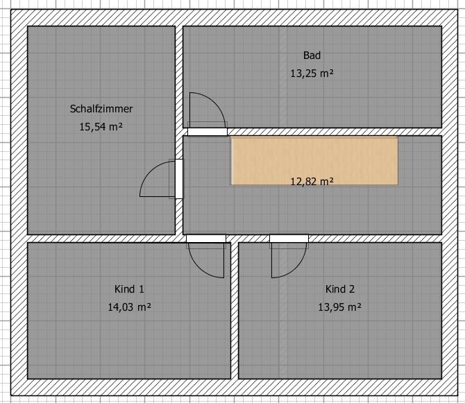

I quickly sketched two floor plans with dimensions of approximately 8.5m x 10m (28ft x 33ft).
The first is based on the Streif Haus WD1000 standard design, the second is a possible optimization for a more elongated house. For the second sketch, I also see the potential to adjust the dimensions to around 8m x 11m (26ft x 36ft) to position the house further towards the northeast.
(1) Ground Floor
Floor plan of a living and dining area (12.82 m²) with kitchen, guest/office, shower/WC, and utility room.
(1) Upper Floor
Floor plan of a house with 4 rooms: bedroom, bathroom, two children’s rooms, central room 12.82 m².
(2) Ground Floor
Floor plan of a room: open space 31.32 m², guest/office 10.36 m², shower/WC 6 m², utility room 7.37 m².
(2) Upper Floor
Floor plan of an apartment: bedroom, child 1, child 2, bathroom, hallway; brown room above the hallway.

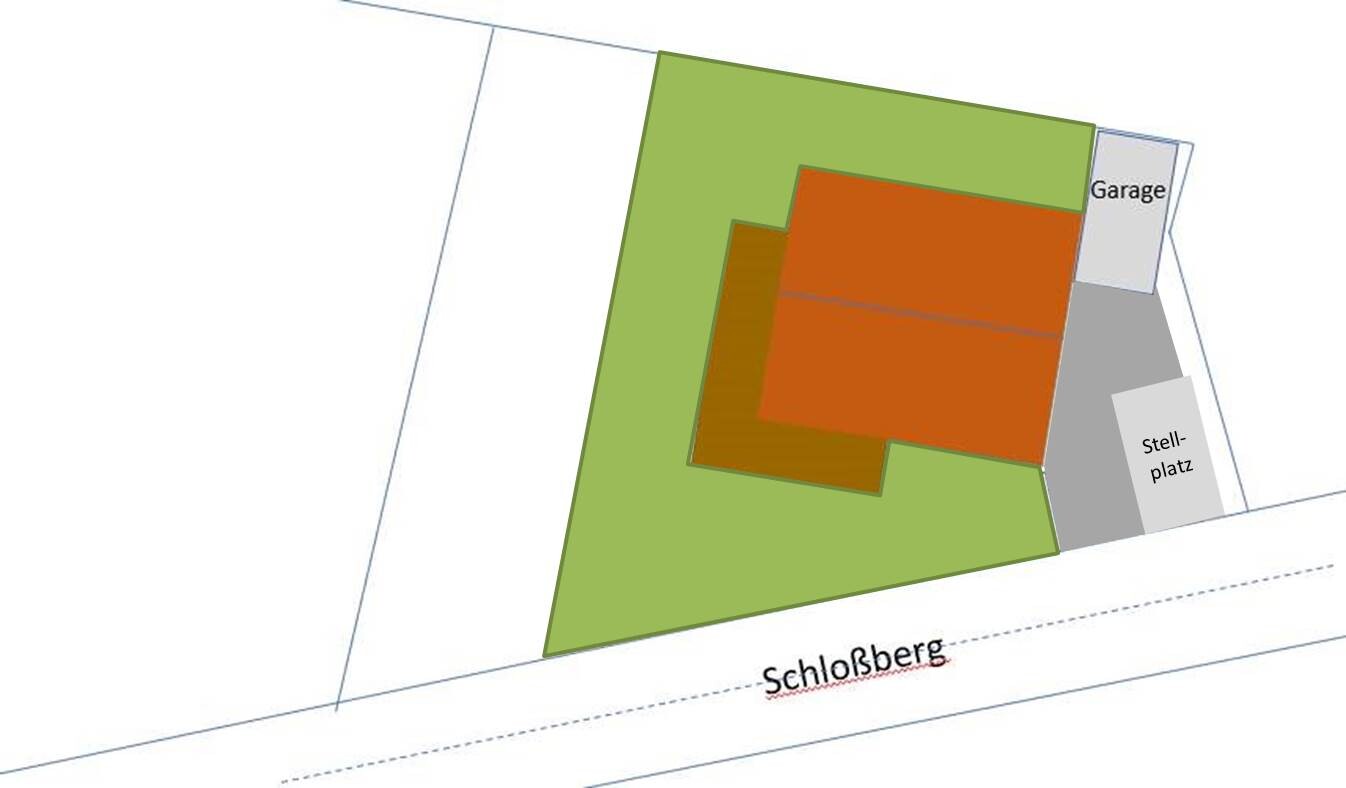

Regarding the parking space, has it been clarified whether the second parking space can be placed in front of the carport/garage?
In your sketch, it would look like this... (but at this point, an accurately scaled site plan would really be helpful!)
Site plan of a property: orange building, green area, garage, and parking space at Schloßberg.
You have a small, rather challenging plot to build on. However, even that is quite a luxury for the greater Munich area—I think many participants here might underestimate this. Another downside is that you cannot optimally plan this "special" plot with an architect but are instead forced to fit into the Streif Haus framework. It’s understandable that the Streif Haus draftsman has little interest in modifying their standard designs, but unfortunately, that works to your disadvantage.
