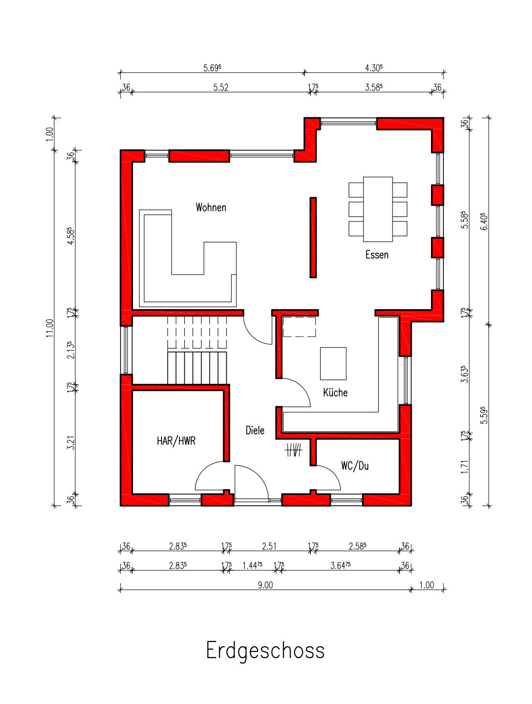

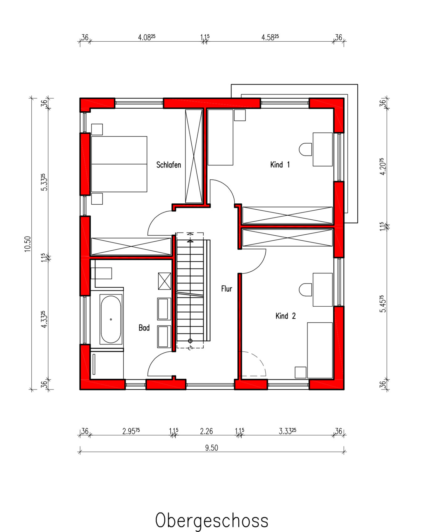

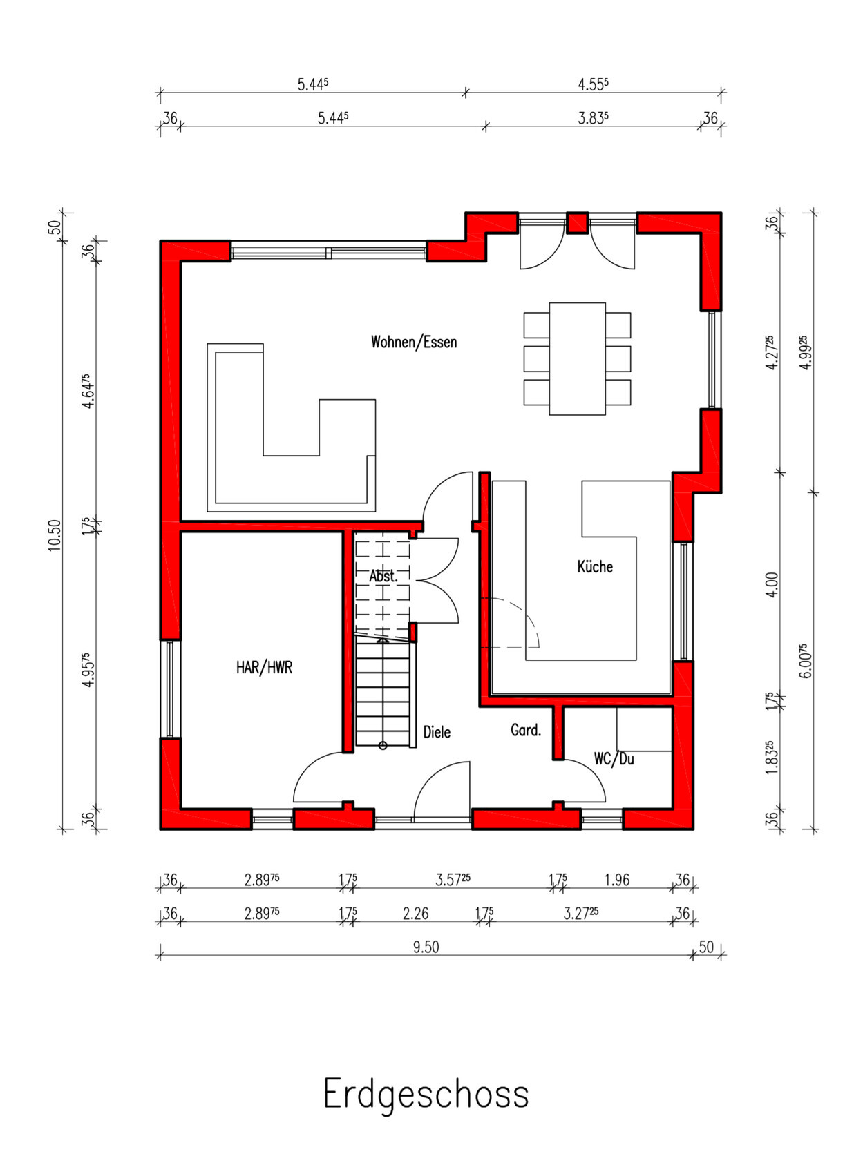

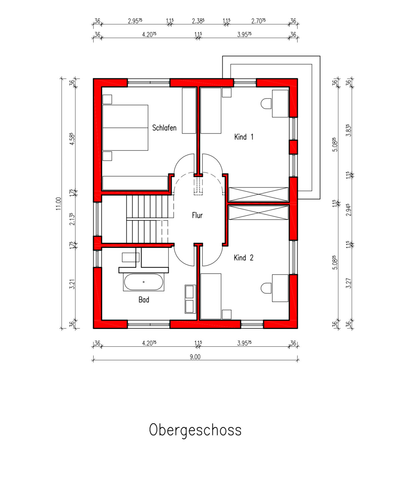

After an endless search, we, a couple with two children, are finally ready to build a new house. We have been on the waiting list for the plot for years. It’s not ideal because it faces east, but there are hardly any other options. Now the planning begins, and we have two rough design options. We need to decide on one and would appreciate subjective opinions as well as arguments for and against each.
Plot size: 576 sqm (6,200 sq ft)
Slope: none
Site coverage ratio: 0.4
Floor area ratio: 0.7
Building envelope, building line, and boundary: usual 3 m (10 ft) from neighbors, 1.5 m (5 ft) from the street
Edge development? Only detached single-family houses
Number of parking spaces: 9 m (30 ft) garage plus parking space in front
Number of floors: 2
Roof type: gable roof, 35 degrees
Style: modern
Orientation: east
Maximum heights / restrictions
Additional requirements
Homeowners’ requirements
No basement, 2 floors
Number of occupants, ages: 4 (33, 33, 3, and 1 years old)
Space requirement on ground floor and upper floor: approx. 75-80 sqm (800-860 sq ft) each
Office use: family use or home office? Small home office
Guests staying overnight per year: none
Open or closed architecture?
Conservative or modern design?
Open kitchen? Yes, but separation possible with sliding doors, for example. Kitchen island or peninsula: yes
Number of dining seats: 8 (up to 14)
Fireplace: no
Music/stereo wall: no
Balcony or roof terrace: no
Garage or carport: yes, 9 m (30 ft) garage
Additional wishes / special features / daily routine, including reasons why some things should or should not be included
Who created the design?
- Planner from a building company
- Architect: yes
- Do-it-yourself: yes
What do you like in particular?
Bay window
Large children’s rooms
Front entrance is a must-have
What don’t you like?
No lighting from the west
The floor plan is too uninspired and resembles a townhouse layout
Price estimate according to architect/planner: 350,000 (without additional costs or earthworks)
Personal price limit for house including fittings: maximum reached
Preferred heating system: ground-source heat pump (deep drilling) + controlled ventilation system
Why is the design like this?
The desire for a front entrance because on the north side the garage is not wide enough for both entrance and parking space, plus a seating area in the south. This limits the width to 10 m (33 ft) including the bay window.
Unfortunately, it seems too standard
What is the most important fundamental question about the floor plan in 130 characters?
Which of the variants would you choose and why?
Where are the critical points?
Are there more creative ideas or completely different approaches?
Both attic floors are not good for storage—what is the lesser evil?

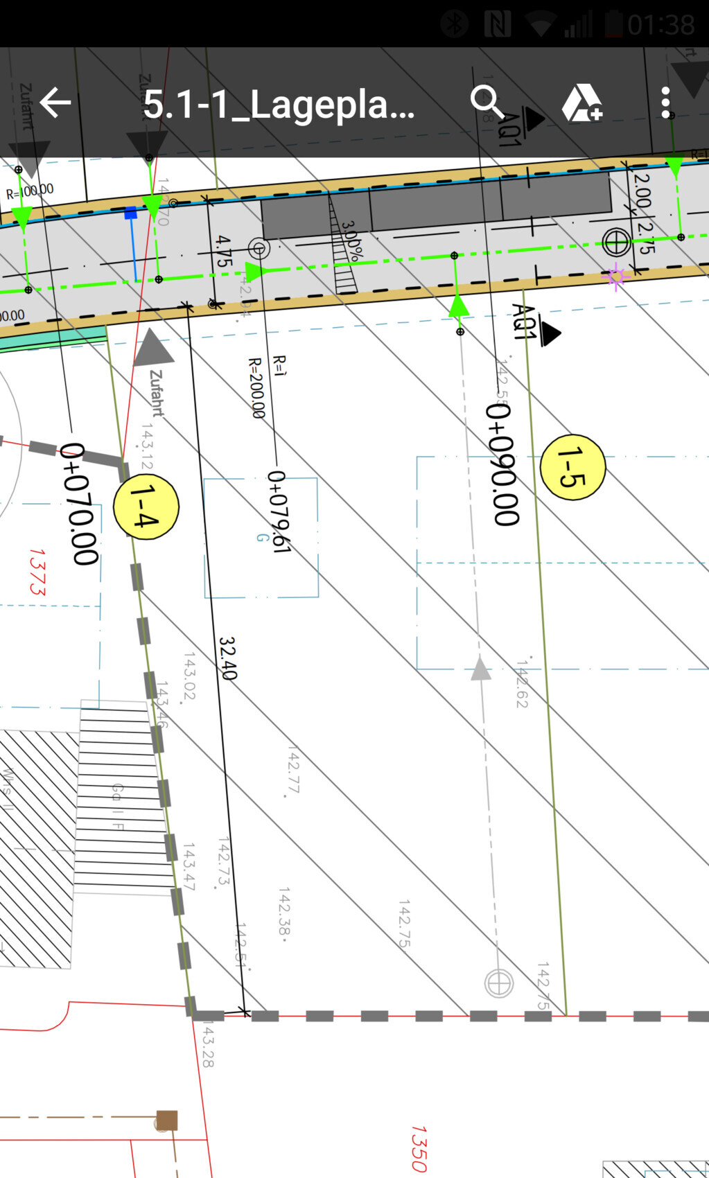

For orientation: the site plan shows bottom as east, access via the street at the top (west), garage on the right (north).
East boundary: 16.6 m (54 ft)
West boundary (in front of house): 18.75 m (62 ft)
Terrace desired on east and south sides
Thank you very much, I look forward to your feedback.

Stockum2019 schrieb:
Too uncreative floor plan, floor plan resembles a terraced houseTerraced house floor plans are usually quite good if you have the detached house version and can build wider. You want to place your carport somewhere anyway.
And now this is your task: try drawing the house on the site plan and add the carport, etc. Please also include the north arrow, otherwise on page 2 this will just be guessing. Reading it strains the eyes.
I find an east orientation one of the most challenging, so it really helps to include the neighboring buildings and things like

Honestly, I think the floor plan is very good. I would prefer the platform version. I would probably use the full width (10m (33 feet)) to give the hallway a bit more space for furniture. Also, add a large window in the living room on the north side.
With a budget of 350k, you can’t expect any extravagances. You have nice southern sunlight in the house, and the rooms are appealing in size and layout. The carport can go on the north side. I would buy it as is.
If you want a designer home, you should quickly take out an additional 100k loan. Why? Just so your neighbors are amazed by how special you are? Nonsense!
Attic conversion isn’t feasible or important with a 350k budget anyway.
kaho674 schrieb:
Honestly, I think the floor plan is very good.I also like it, but the issue with the west side would bother me a bit. Still, you can’t have everything.

j.bautsch14 Aug 2019 09:08I don’t think the design of the platform stairs is bad either and would prefer it.
I also think it’s good, but the issue with the west side would bother me a bit, too. But you can’t have everything.Yes, especially if the entrance has to be on the west side.Similar topics
