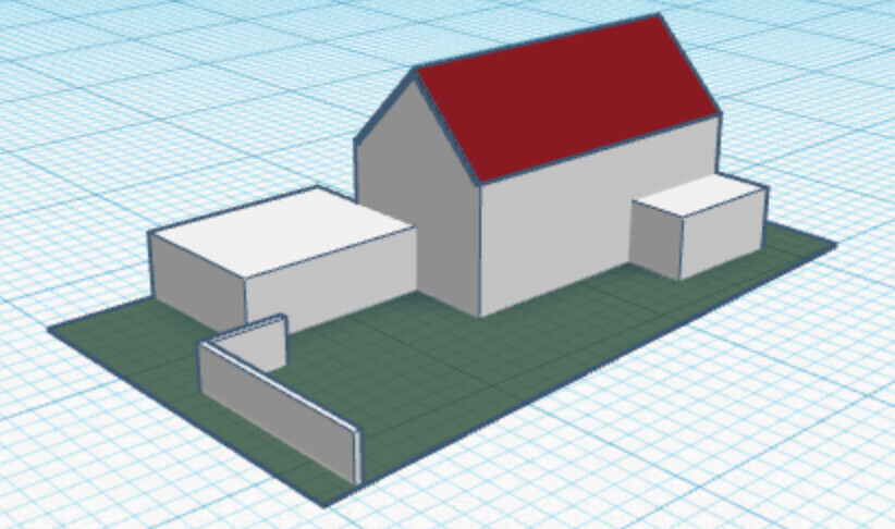

derdietmar19 Aug 2019 21:28Hello,
unfortunately, there is still too little information about the basic conditions. @11ant is not wrong; new requirements call for a new approach. If buildings on the plot only need to comply with the required setback distances and no local development plan provides other specifications, I would suggest the following solution:
Positioning
Positioning
- House positioned entirely in the northeast
- House longer and narrower instead, with the southeast corner possibly as an extension
- Garage positioned entirely in the northwest, possibly with the required distance from the road (often specified in the development plan / planning permission)
- Wall as a boundary fence towards the road
- Kitchen and dining area in the southwest
- Living room in the southeast extension
- Utility room in the northeast
- Technical room, storage, and toilet in the northwest
- Entrance and cloakroom in the west
