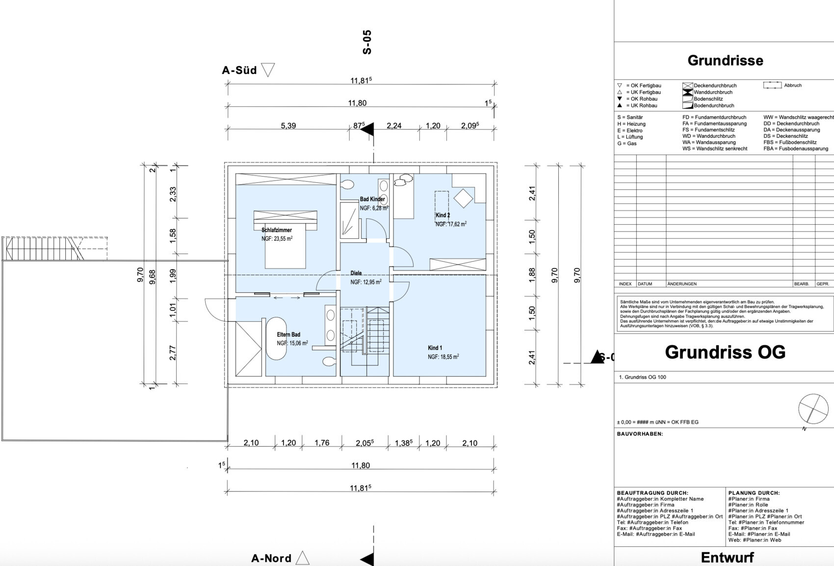

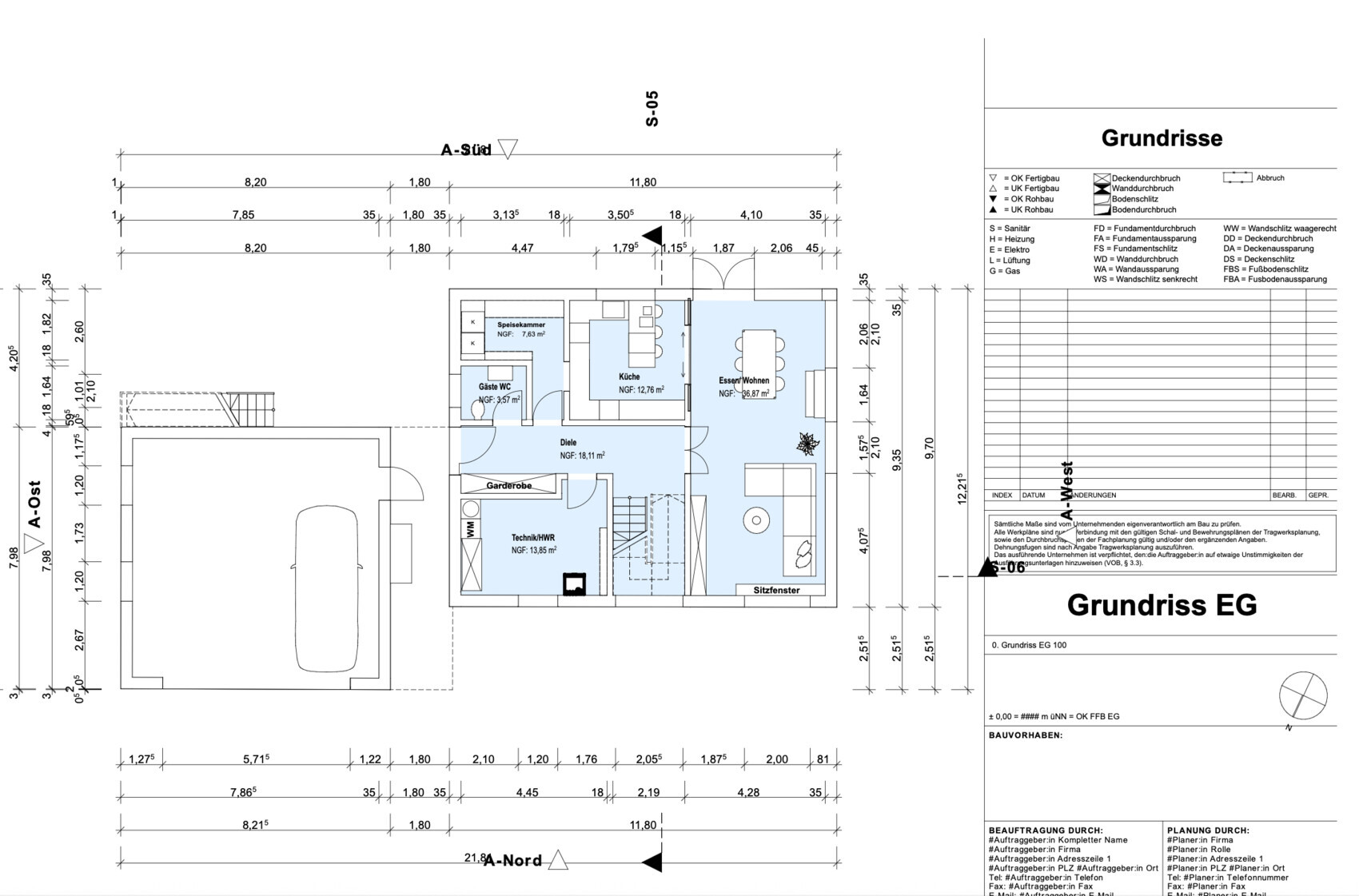

We are a young couple (26 and 28 years old) currently planning to build our single-family home. Two children are planned for the future. We have already purchased the suitable plot – it is located on the edge of a field in a small village, so it is a very quiet location.
At the moment, we are about to commit to a construction company that will handle both the building permit (planning permission) and most of the construction as general contractor. However, we would like to carry out some trades as self-performed work.
We designed the floor plan together with a friend who is studying for a Master’s degree in architecture. So far, these are still draft drawings, which we now want to turn into permit-ready plans. However, we have reached a point where we feel “stuck” – we literally can’t see the forest for the trees. Unfortunately, we don’t like the floor plan 100%, some rooms are missing, and we are unsure how to proceed.
Therefore, we would appreciate any input, ideas, or suggestions for improvements – but first, here is an overview following the question checklist:

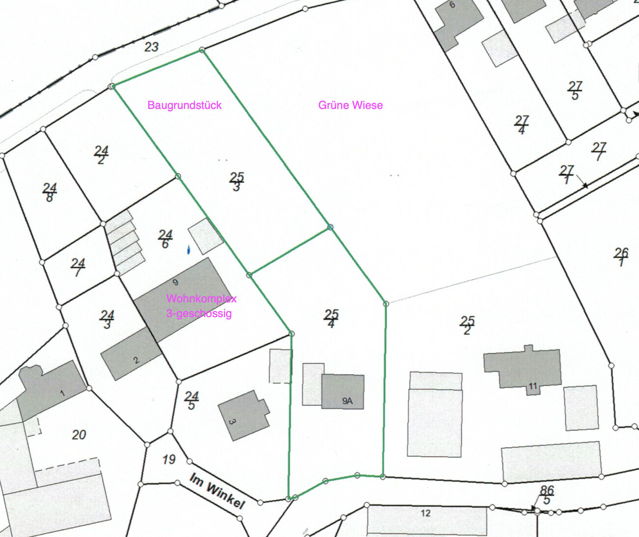

Plot & Development
Our Preferences & Requirements
Building Style & Construction
Rooms & Layout Concept
Building Services (planned)
Special Features & Current Challenges
What we like about the draft:
We were uncertain for a long time whether the gable or the eaves should face the field. The current plan has the eaves facing the field – this seems more generous towards the garden. We are open to opinions on this!
What currently bothers us:
Garage idea:
Budget & Self-performed Work
What could we possibly do without?
What we do not want to give up:
About the development of the draft
Our main question(s) to you:
Final summary
We are trying to create a modern, well-thought-out, and suitable home for our needs – with a realistic budget and self-performed work where it makes sense. It is important to us that the house is special but not excessive or “over the top.”
We look forward to any feedback – whether on room layout, building services, facade design, roof terrace, or details.
Plot & Development
- Size: approx. 1,600 m² (17,220 sq ft)
- Dimensions: approx. 26 m (85 ft) wide × 60 m (197 ft) deep
- Topography: flat plot, no slope
- Location: edge of field in a small village
- Neighboring buildings:
- Northwest: Residential complex with two full stories + converted attic
- Northeast: large open meadow
- Development plan: none
- Requirements from building pre-application (preliminary enquiry):
- No explicit restrictions
- Recommendation to build towards the front (street side)
- Kitchen:
- Open, but separable with glass sliding door
- Pantry directly adjacent to the kitchen, ideally integrated into the kitchen cabinet front
- Dining/Living area:
- Open and spacious
- Dining table for 6 people, extendable to 10–12 people
- Master area:
- Bedroom with direct access to walk-in closet and separate bathroom
- Children’s rooms:
- Two equivalent children’s bedrooms
- Bathrooms:
- Children’s bathroom on upper floor
- Guest toilet on ground floor, ideally with shower
- Office/guest room (currently not included in the draft)
- Utility room:
- For washing, drying, and hanging laundry
- Technical room:
- Housing building services, possibly integrated into garage
- Garage:
- Simple design
- Technical room + separate toilet as an “external WC” can be integrated (as an idea, not yet part of the plan)
- Roof terrace over the garage desired (to enjoy unobstructed views of the sunset and the field)
- Heat pump
- Photovoltaic system
- Ventilation system
- Smart home technology
- KfW-40 standard (energy efficiency standard)
- Good orientation of rooms according to cardinal directions
- Simple, modern design without bay windows or building projections
- Long side of the house facing the garden = more openness to the south
- The office/guest room is completely missing
- The laundry area is not ideally planned yet – e.g., where exactly do we dry clothes in winter?
- Covered entrance area – but will it be too dark there?
- Children’s bathroom vs. office/laundry room: We are considering giving up the separate children’s bathroom to instead integrate the office or laundry/ironing room there. On the ground floor, the guest toilet could be made slightly larger and include a shower – in case mornings get busy or guests want to shower on the ground floor.
Garage idea:
- Relatively simple garage, only the technical room should be insulated and have a concrete floor slab
- The rest of the garage could remain paved and uninsulated
- Roof terrace on the garage with views over the fields – our heartfelt wish
- Total house cost including garage: €550,000–600,000 (without landscaping)
- Self-performed work:
- Earthworks
- Roofing
- Flooring
- Electrical work
- Painting
- Landscaping: currently approx. €15,000 planned for basic paving
- Overall budget including fixtures: €650,000–700,000
- If necessary, we could do without the separate children’s bathroom – although of course that would reduce comfort.
- Instead, a larger guest toilet with shower on the ground floor, and use the upper floor room as laundry space.
- Generous, well-equipped kitchen – we love cooking.
- The roof terrace on the garage – the view is really unique and very important to us.
- Currently, we are probably on the fourth draft
- Originally, the house was larger and had a gallery and open staircase – but that was not affordable
- The garage was initially attached directly to the house – now it is detached with a covered walkway
- Do you have any ideas on how to integrate the missing office without losing the spaciousness of the design?
- Could the covered entrance become too dark?
- What do you think about orienting the eaves side to the field instead of the gable?
- Are there sensible alternatives for better positioning the laundry/drying area?
- Do you see ways to better tailor the room program to our needs without exceeding the budget?
Final summary

Absolutely. The bedroom should be left and not crossed afterward. Everything else doesn’t work very well in daily life.
You identified the problem well, but the solution is not ideal.
As mentioned before, I would completely redesign that. And if nothing else works, I’d add a separate access to the kitchen instead of routing through the pantry.
This again depends on the building services.
Air-to-water heat pump, split unit: a suitably shaped 10–11 m² (108–118 sq ft) space should work.
Air-to-water heat pump, monoblock: it might be tight.
People are strange. I suspect that, if built as planned, almost everyone would use the bathroom route rather than coming from outside.
I can’t really judge whether the roof terrace idea will work well—that’s not my strength. But in terms of routing, most will probably go through the house.

The walking distance in the master bedroom is a good point—so maybe a layout like bedroom -> walk-in closet -> bathroom makes more sense?
leah1003 schrieb:
Thank you very much for the detailed reply! I really appreciated it—I’ll try to respond now:
Originally, we hadn’t considered access to the pantry. The idea came up because we thought about having to carry groceries around the whole loop via the hallway, living room, and kitchen to unload. With direct access, you could quickly put the bags in there.
The utility room could probably be designed smaller—maybe 10 m² (about 108 sq ft) would suffice. This room needs to accommodate the building services and preferably also two drying racks for laundry.
We also thought about the access from the upper floor to the roof terrace for a long time. There will also be access from outside via an external staircase. We thought that if you’re sitting on the terrace upstairs, you’d have a quick way to the toilet.
