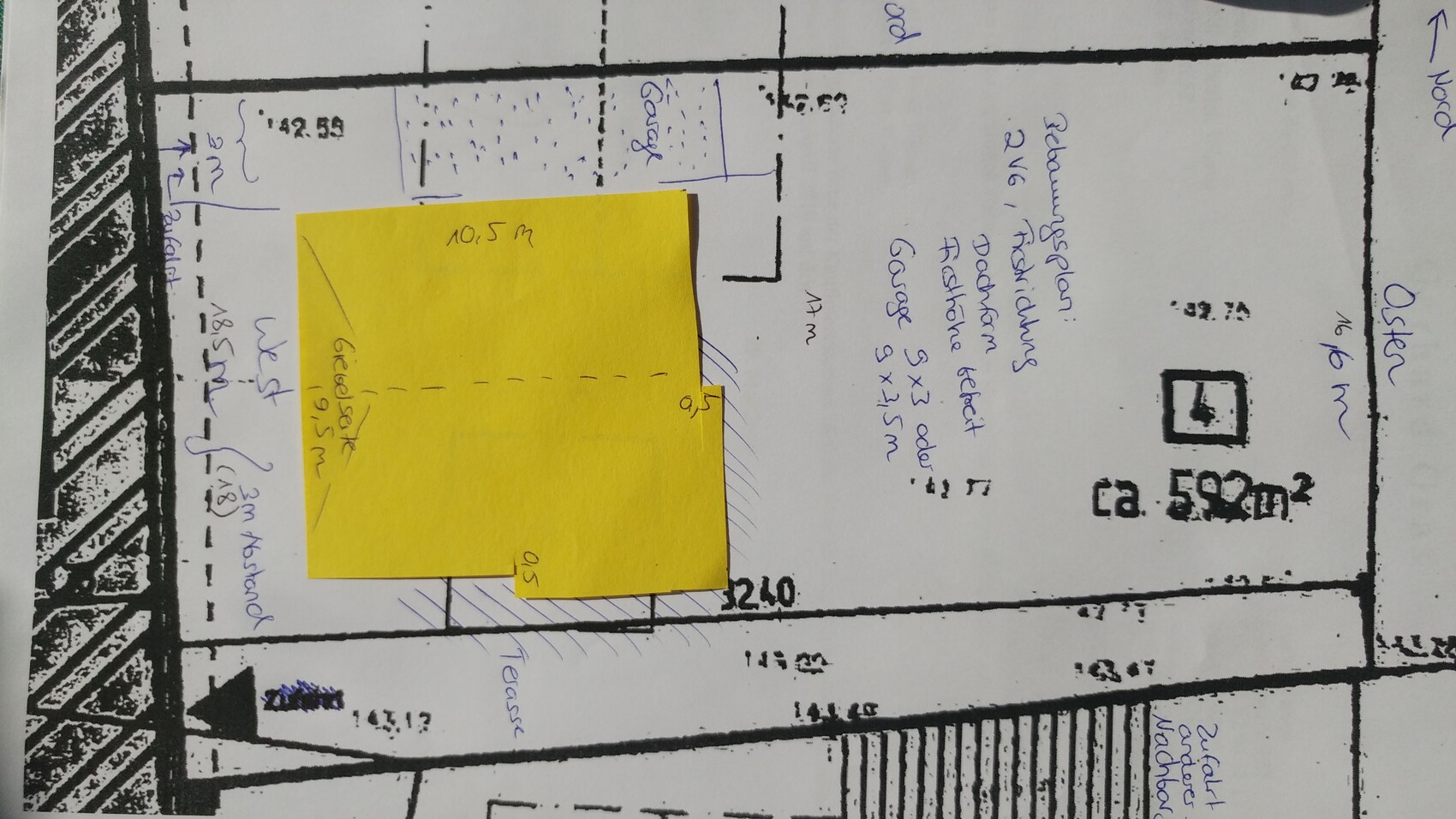

For orientation: the site plan shows bottom as east, access via the street at the top (west), garage on the right (north).
East boundary: 16.6 m (54 ft)
West boundary (in front of house): 18.75 m (62 ft)
Terrace desired on east and south sides

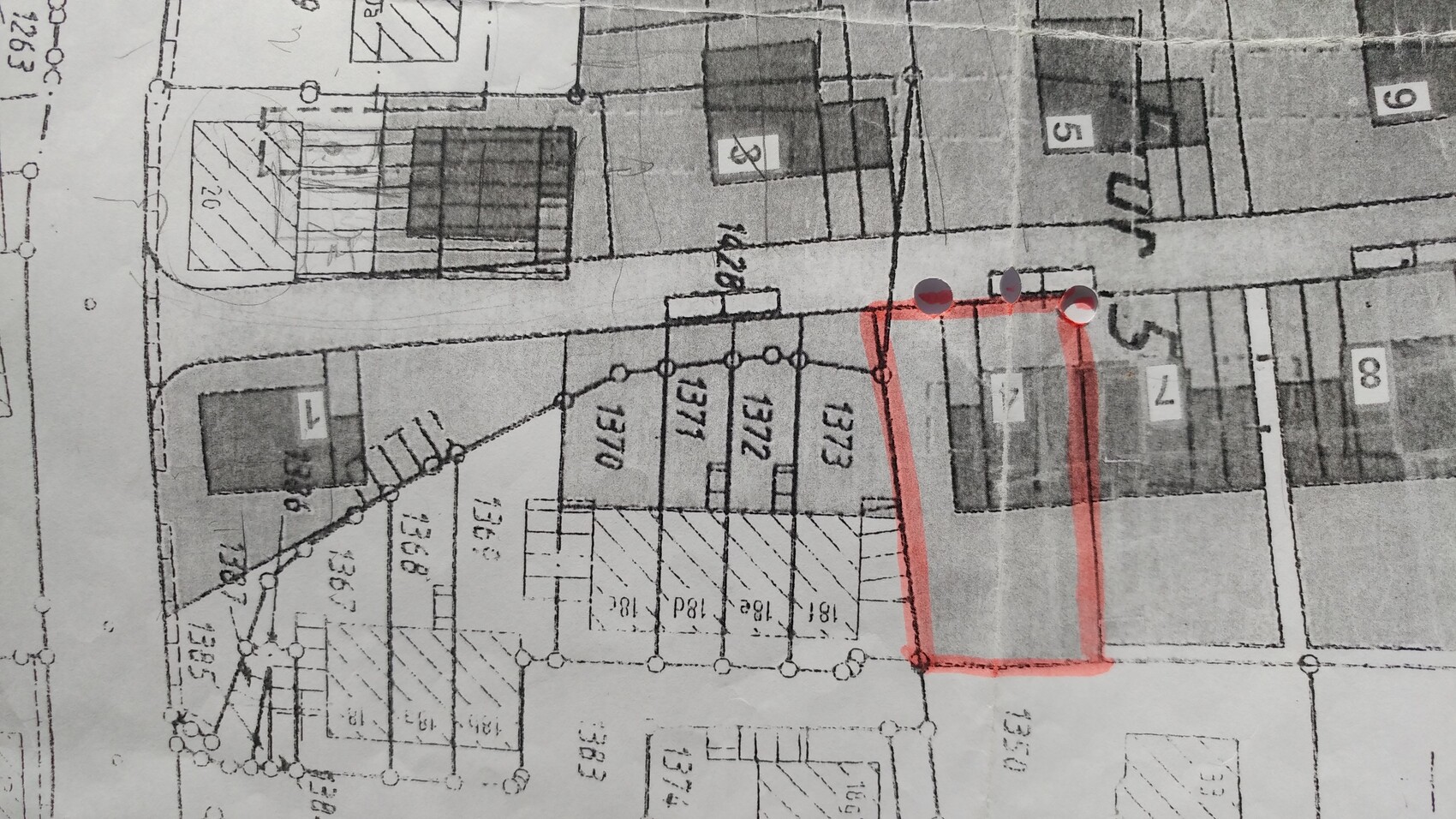

Stockum201914 Aug 2019 16:56What is your suggestion? The idea of causal chains may be valid, but the planning has been developing for some time, specifically for a south-facing plot. Now we have been awarded the east-facing plot... and are somewhat fixed on the original plan.
Stockum201914 Aug 2019 18:08Good evening, here is the site plan. I am actually interested in exploring ideas, but I find it hard to move away from a straight staircase and a front entrance. However, I don’t have any strong reasons for this, except that the width of the plot doesn’t really allow for other options. Moving the house further back is not so easily doable, but it might be possible. The development plan from the 1960s doesn’t fit any plot as is, so the city has waived building boundaries, roof shapes, and other requirements. The original access road is on the south side, but we would prefer it on the north side. This has also been approved.
Having a seating area or the main garden in front of the house feels strange... too exposed.

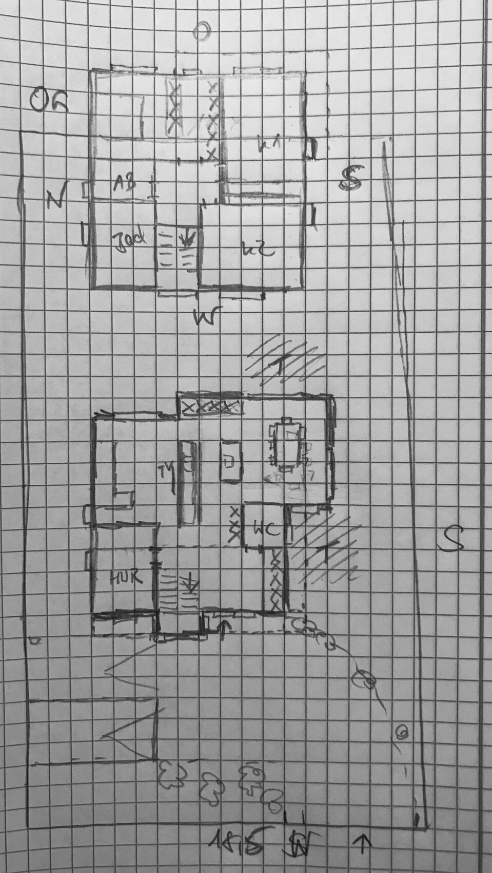

A thought experiment from me at my best (a blunt pencil )
A podium staircase in a glass bay window that lets the western light into the whole house.
At the back, there is a modern bay box, and on the top floor, the building extends to the south and west.
Or something like that.
Terrace on the east and south. Garage with carport in the northwest with driveway in the southwest. Covered entrance.
I just read that the kitchen can be closed off. Well, then the restroom can be designed as a narrow room, however...
I’m also not sure if the staircase to the attic is accessible oops:
