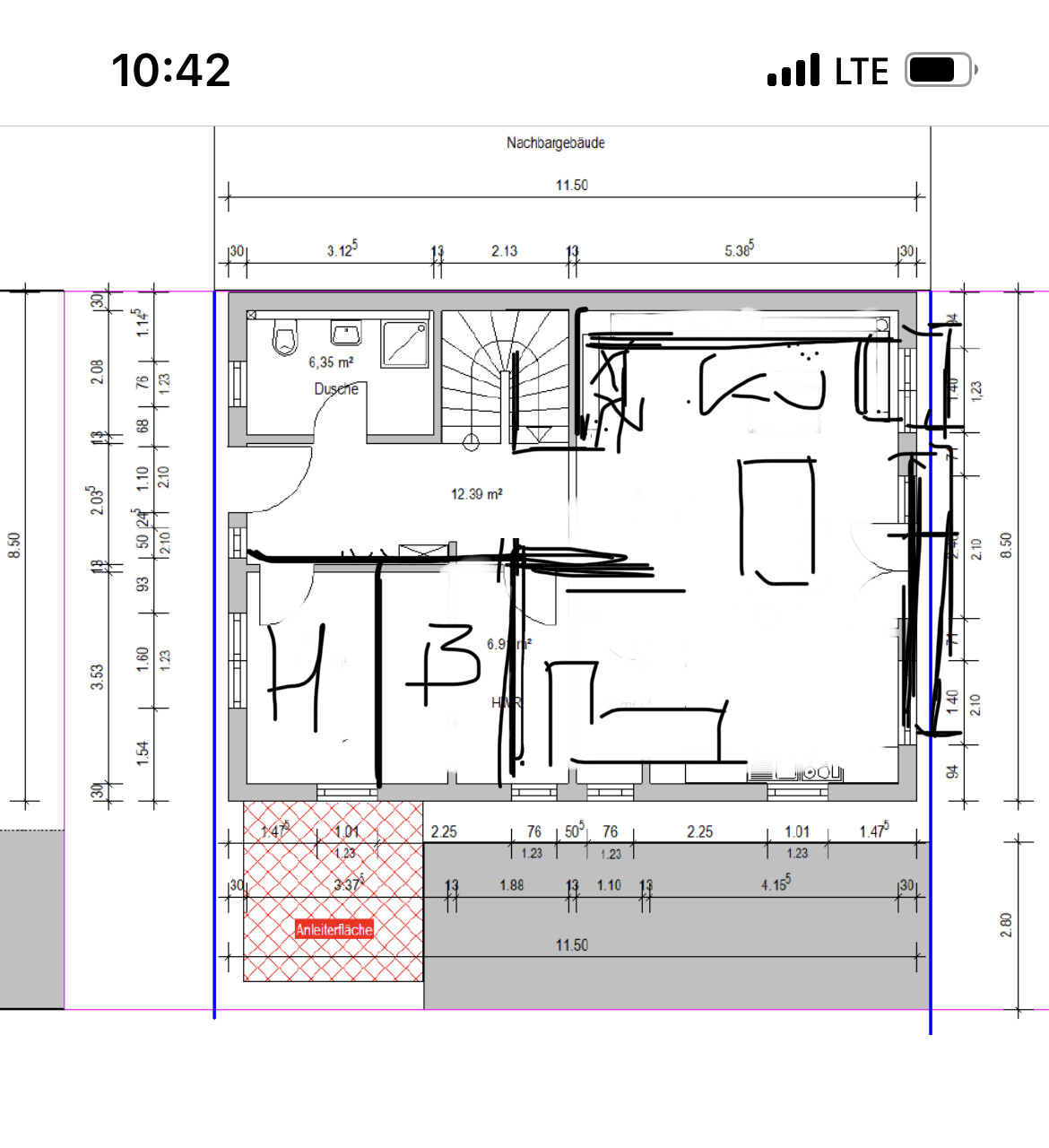

I was thinking of a bay window, one meter deep, 4–5 meters wide (4–5 meters). Or across the entire width of the house, open at the top. A conservatory, so to speak.
Wolfson schrieb:
I’m currently designing the house with Sweet Home 3D and noticed exactly the same. Here, we are considering shifting the wall slightly towards the kitchen.
Show us!
Two-dimensional house floor plan with rooms, stairs, doors and dimensions
Maybe like this: smaller office with a partition wall that can be moved “in old age.” Because “in old age” you don’t need as much lounge space, and the dining area can be reduced. (If you even choose to do ground floor sleeping “in old age”… :rolleyes 🙂 The all-round solution severely limits you for the next 20 years.
Storage room under the stairs.
A guest could sleep on the sofa or in the children’s room, whatever… or at a hotel… second workspace… let’s be honest: people will sit at the dining table anyway. (Or in my suggestion with the conservatory. You can’t and shouldn’t expect a fairly compact house to adapt perfectly to every situation. That would restrict daily life too much.)
But don’t forget that you could also create a backup room in the attic for guests or as an office: it will be a bit cozy, but it’s possible. You could have a narrow, cheaper secondary staircase installed above the existing one. There could also be a roof window to bring in light from above, if the stairs to the attic have no risers.
I would place the fireplace on the west side; otherwise it will get too warm for everyone.
