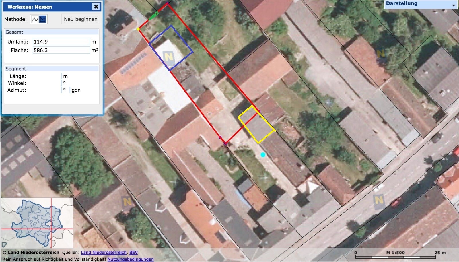

The plot is inherited, near Vienna in Austria, with very good transport connections. The final decision to build there is not yet made, about 90% certain.
The existing building will be demolished. Further use is impossible.
In the plan, which is oriented to north:
red: the plot, access via green path, the house would currently be at the blue position. Existing building in yellow as garage and cellar replacement.
On the western boundary of the plot, there is a neighboring building, tall agricultural storage halls.
Two full floors possible.
"Closed building style" is a must, meaning at least one side must be attached to a neighboring building, on the other side at least a wall/gate or similar.
The plot is at its narrowest point, at the very north, exactly 12m (39 feet) wide. A drive-through possibility would be nice (also because of the existing garage), therefore a maximum house width of 9m (30 feet).
Size of the plot: 630m² (6781 ft²)
Slope: none, only very slight inclination
No basement, an additional garage is available/planned, see the yellow marking on the plan.

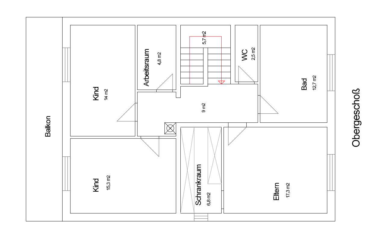

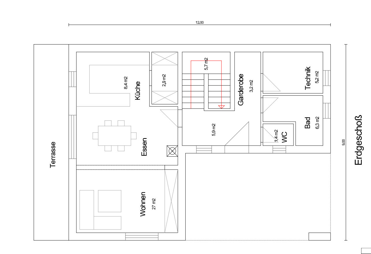

Current house design:
From the planner of a timber construction company
We are actually quite satisfied with it, this is the 3rd iteration... The entrance area/wardrobe might need some fine tuning. One child’s bedroom would be used as an office.
About 155m² (1668 ft²) of living space.

Plot:

We are also building something narrower (8.30 x 13 meters (27.2 x 42.7 feet)). Construction is planned to start in the first week of November.
I would replace the pantry with kitchen cabinets. There are cabinets designed for beverage crates and broom/cleaning supply storage. This makes the open-plan kitchen feel more spacious.
The toilets on the ground floor and upper floor are very small and cramped. What is the purpose of a bathroom on the ground floor?
The walk-in closet is too narrow. There is hardly any space between the two rows of cabinets.
Is the utility room intended to be an office or a laundry/utility room?
Furnish all rooms once with your existing and planned future furniture.
It’s hard to believe that the two floors shown belong to the same house. Upstairs, there are spacious children’s rooms with a balcony as an expensive extra, as well as more than 14sqm (150 sq ft) for the bathroom in total.
Downstairs, living/dining/kitchen areas are squeezed into 35sqm (375 sq ft). The utility room at 5.2sqm (56 sq ft) is barely large enough, if it’s even sufficient. The pantry with 3sqm (32 sq ft) for 2 to 2.5 meters (6.5 to 8 feet) of shelving space is, again, a waste of space. Meanwhile, there are roughly 8sqm (86 sq ft) of bathroom space on the ground floor – what is that for?
Try measuring the furniture. Corner sofa with dimensions of 1.75 by 2 meters (5.7 by 6.5 feet) – good luck fitting that in. The dining table is less than a meter (3 feet) deep and a chair just 20cm (8 inches) wide... quite misleading.
By the way, it’s not 155sqm (1,670 sq ft), I calculate 142sqm (1,530 sq ft). Or were stairs and possibly the balcony included in the calculation?
The house will probably be placed with its long side against the neighboring house? It would be helpful to have this site plan as a sketch with dimensions and a proper north arrow (so all the information is in one place), including the length of the neighboring house, etc. Also, sketch the planned house and garage, as well as where there is still space for a driveway.
What is the large covered corner on the ground floor intended for?
kbt09 schrieb:
What is the purpose of this large corner with a roof on the ground floor?That is the carport.
