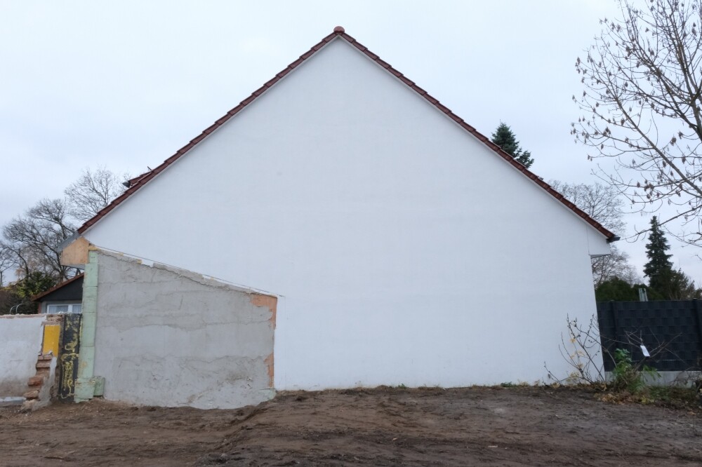

  • Neighbor’s house must be underpinned. The neighbor’s basement is set back 1.5 m (5 ft) from the boundary where the attachment will be made. In this area, concrete supports of 3 - 3.5 m (10 - 11.5 ft) depth serve as underpinning for a former terrace and shed.

  • Neighbor’s gable wall to be attached:
  • White house facade with red gable roof; left building area with plaster work, unpaved yard.

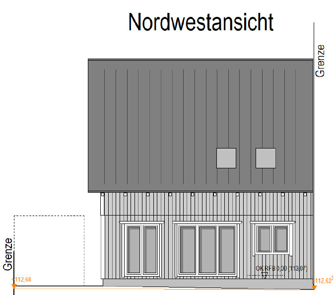

    • External appearance largely identical:
    • Two house views of an architectural exposé with solar roof panels and windows.
      Northwest view of a house with gray flat roof, vertical cladding, window front and doors.

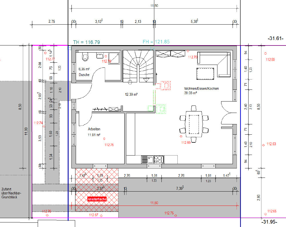

    • Floor plans (furniture shown is only illustrative; our actual furniture looks different):
      • VERSION 1) with externalised building services, shown with basement, idea is to build with garage. Currently, a carport is planned but will not be realized. Instead, ideally the garage:
        • GF:
        • Floor plan of a house: living/dining/cooking, working, shower, staircase and access

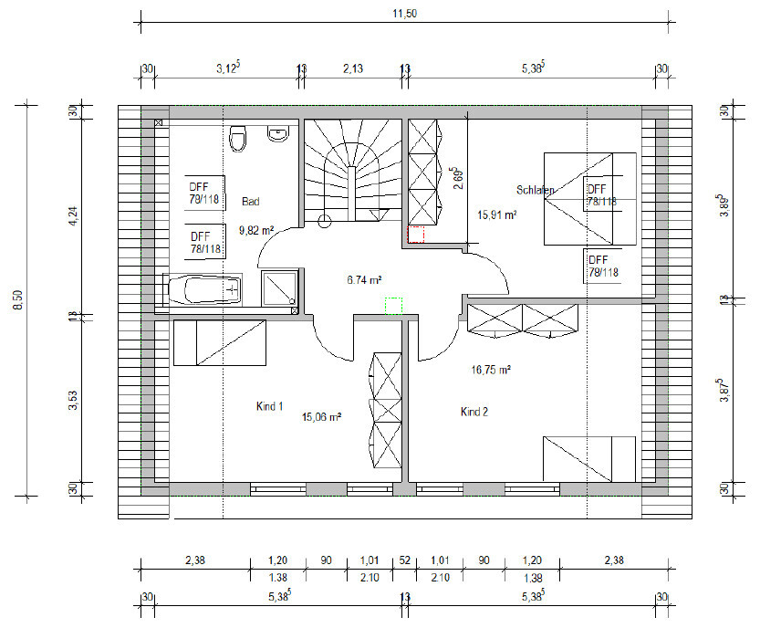

        • UF:
        • Floor plan of an upper floor with bathroom, bedroom, two children’s rooms, hallway and stairs.

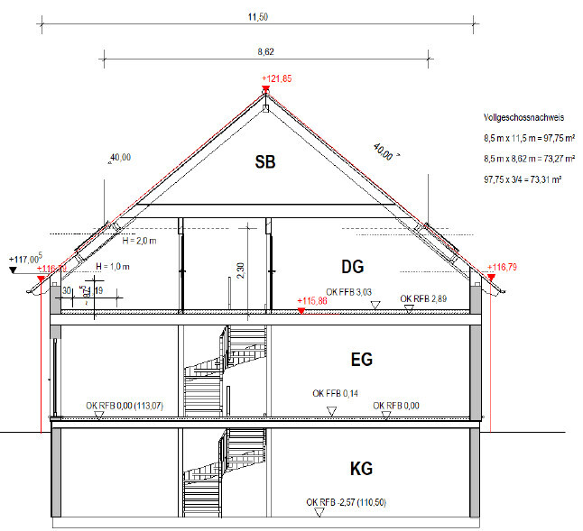

        • Section: height is fixed, it is just slightly (about 2 cm [1 inch]) below the neighbor’s height. Attic accessible either by stairs or ladder/fold-down stairs (staircase shown in version without basement):
        • Cross section through a multi-story house: basement, ground floor, attic, roof structure, stairs, roof form.

        • GF:
        • Floor plan of an apartment: shower, study, utility room and generous living/dining/kitchen area with furniture
        • Upper floor identical.

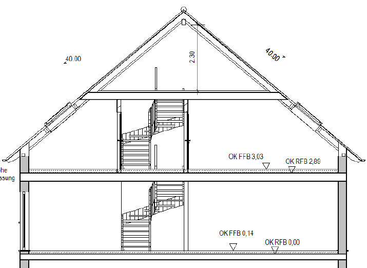

        • Section, here with stairs to attic:
        • Cross section through a two-story house with roof structure and stairwell

    Cross section through a two-story house with stairwell, roof structure and dimensions.

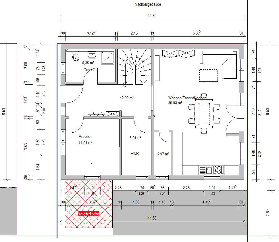

driver55 schrieb:
Just briefly…
With only 39 sqm (420 sq ft) for living/dining/cooking on the ground floor, the other rooms have to be smaller to allow the living/dining/kitchen area to be larger…
Addition: And the hallway/stairwell is or becomes dark…
Wolfson
7 Jan 2022 17:20
driver55 schrieb:
Just briefly…
with only 39 sqm (420 sq ft) for living/dining/cooking on the ground floor, the other rooms have to be smaller so that the living/dining/kitchen area can be larger…
It seems the architect did not correct the calculation; it was 39 sqm (420 sq ft) in the version with the utility room. In the version with the basement (or garage), it would be around 50 sqm (540 sq ft).
Wolfson
7 Jan 2022 17:23
driver55 schrieb:
Addition: And the hallway/stairwell is/is going to be dark...
Yes, we are aware of that. Lighting is definitely a big challenge.

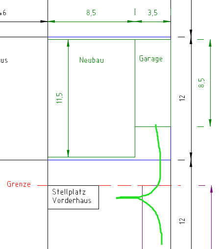

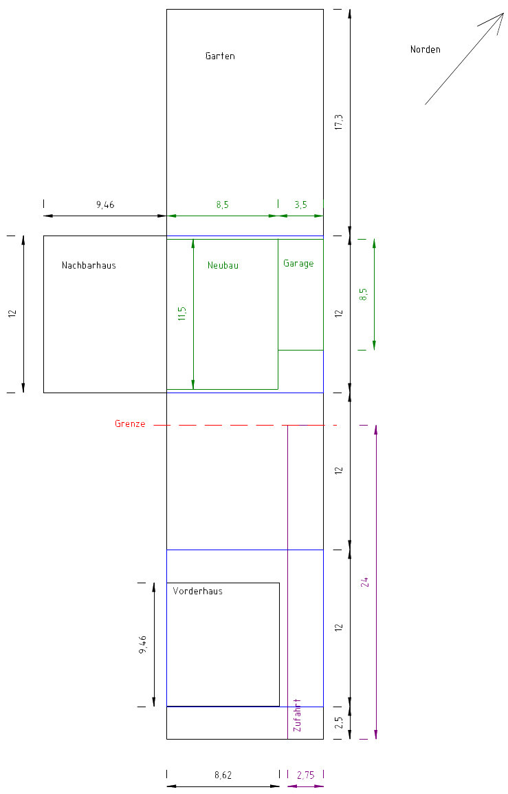

A garage with a width of 3m (10 feet) is already quite narrow, but 2.8m (9 feet 2 inches) is really tight. Inside, you won’t have more than 2.6m (8 feet 6 inches) of usable width. I would recommend testing this out. The distance between the house and the garage seems a bit odd to me, because with such a small gap, you won’t get much light into the house. As a passageway, it’s almost too narrow, and this width is also lost from the garage itself.
How did you plan the driveway to the house? I can imagine going forward through the 2.75m (9 feet) “tube,” but how do you get back out of the property? Reversing out seems challenging. Turning around in front of the house?

I probably didn’t explain this well enough: the plan shows a carport originally designed by the architect, but we don’t want to build it like that, for the reasons you mentioned. Instead, we want to build a garage spanning the full width as drawn in the sketch at the top of the first post.
Regarding the driveway: yes, this is a problem we have already considered. We might get lucky because a parking space must also be created for the front house, and it’s most likely planned right at the boundary with our property. This could allow us to use that space to turn around if two cars fit within the 12m (39 feet 4 inches) width:
Floor plan of a new build house with garage and parking space in front of the house.
11 Jan 2022 14:05
Did I miss something? Why such a huge garage now, if it really limits your car movement to just driving straight ahead? How is the property boundary designed on the northwest side? Is it a soft or hard boundary?
The house wall there also restricts any maneuvering with the steering wheel, even if it is 3.50 meters (11.5 feet) wide (okay, that’s manageable, but still…).
If the front part of the property gets its parking space where you marked it, then maybe you could create a shared driveway WITHOUT a green strip, so you both always have enough space to turn around. Maybe even a carport or a carport extension with a storage room behind it for bikes and trash bins?!
The currently planned garage will probably block the last natural light on that side of the ground floor, won’t it?
Has it been discussed whether you are allowed to build further out toward the garden? For example, perhaps just a narrow conservatory (flower window) on the ground floor that also captures light from above?
What is the purpose of the workshop?
What is northwest of the property?
If there is no construction on the northwest side, it seems that the back area there is quite open and free?
