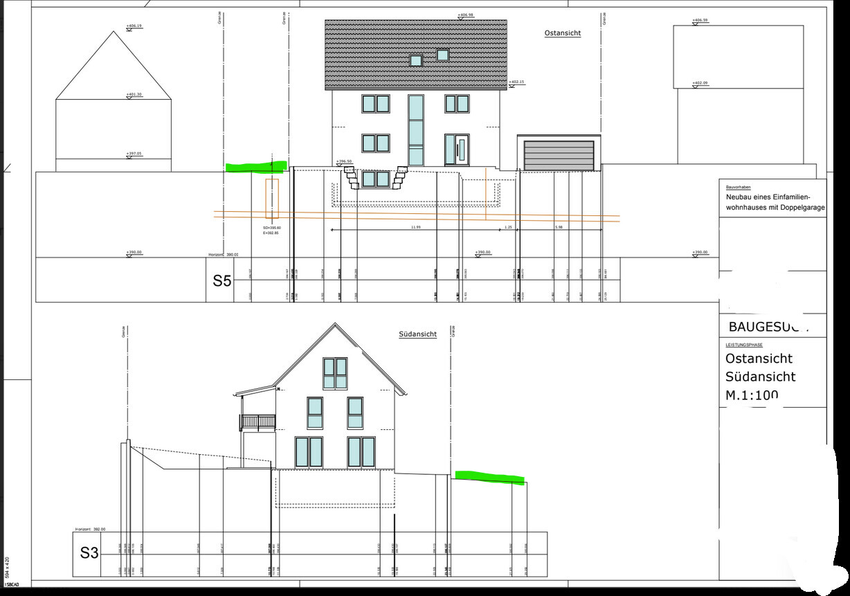

First, here are the site plans: (public roads marked in green. There are two roads adjacent to the plot: on the east and south sides.
East and south view of a single-family house with garage; architectural drawing, scale 1:100.

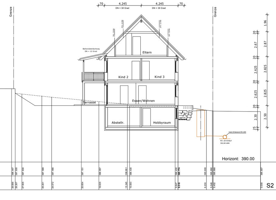

Here is the section through the building: We are also considering leaving the attic open so that one can see up to the roof ridge and use the exposed beams as a design feature. Note the lower basement that clearly serves a utility purpose.
Section through three-story house with parents, child 2, child 3, dining/living, hobby room and terrace

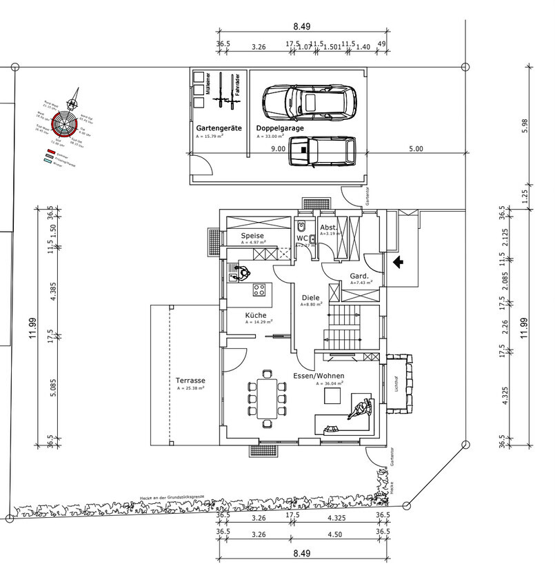

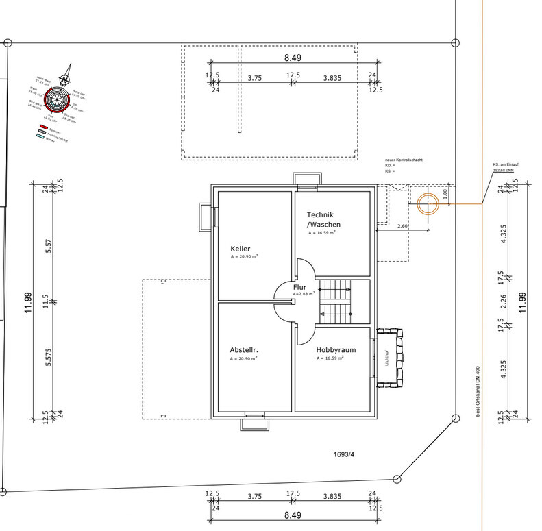

Now the floor plans from bottom to top:
Basement:
Basement floor plan: cellar, technical/laundry room, hallway, storage, hobby room.
Ground floor:
Floor plan of a house with double garage, terrace, kitchen, dining/living area, and cloakroom.

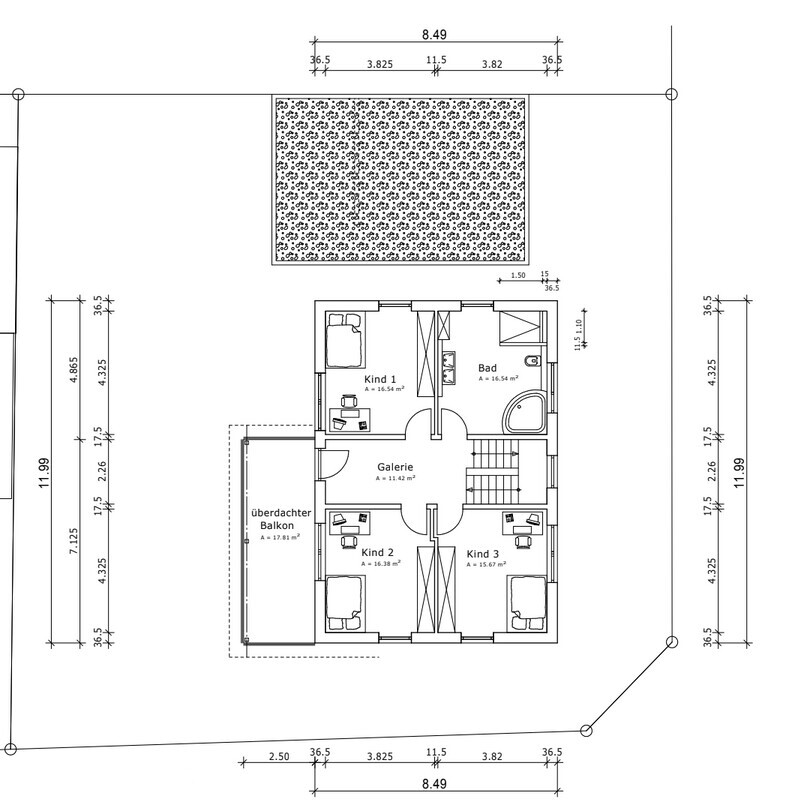

Upper floor:
Floor plan of a house with three children’s rooms, bathroom, gallery, covered balcony and outdoor area.

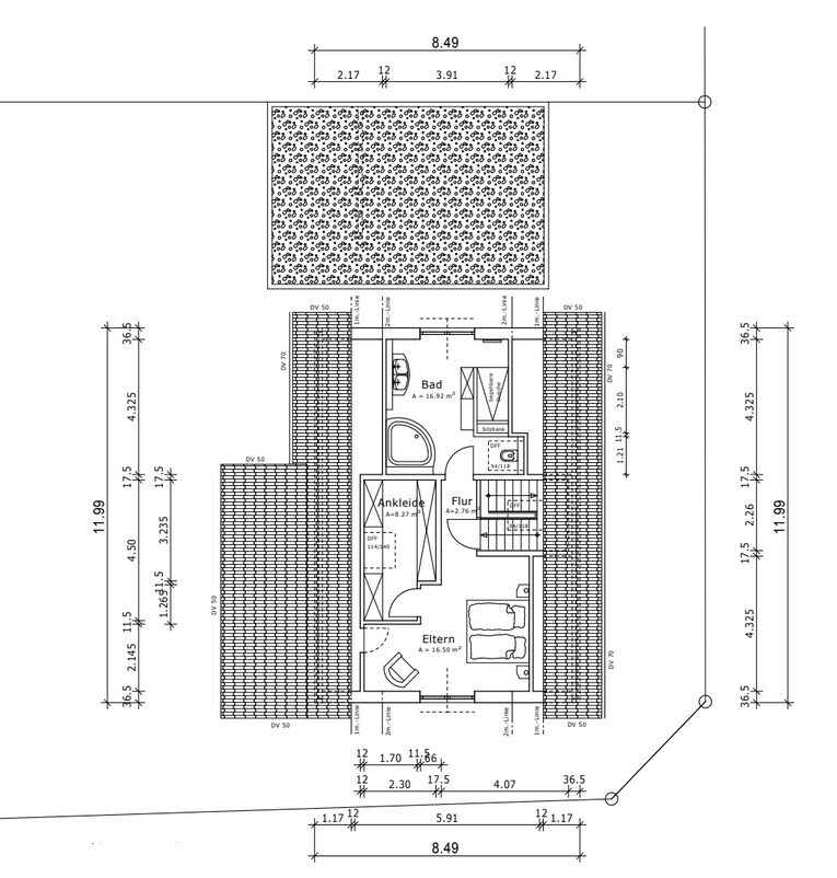

Attic:
2D floor plan of a house with bathroom, master bedroom, dressing room and hallway, surrounding terrace area

East and south view of a single-family house with garage, steps, and balcony.

A pitched roof with a slope of "approximately 50°" must be built.
38 and "approximately 50" is not just a significant difference in clothing size.

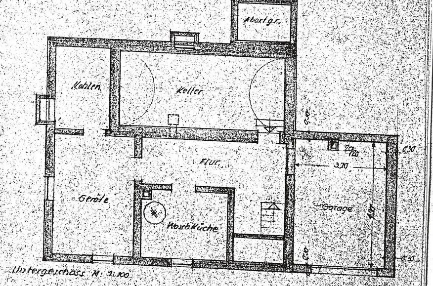

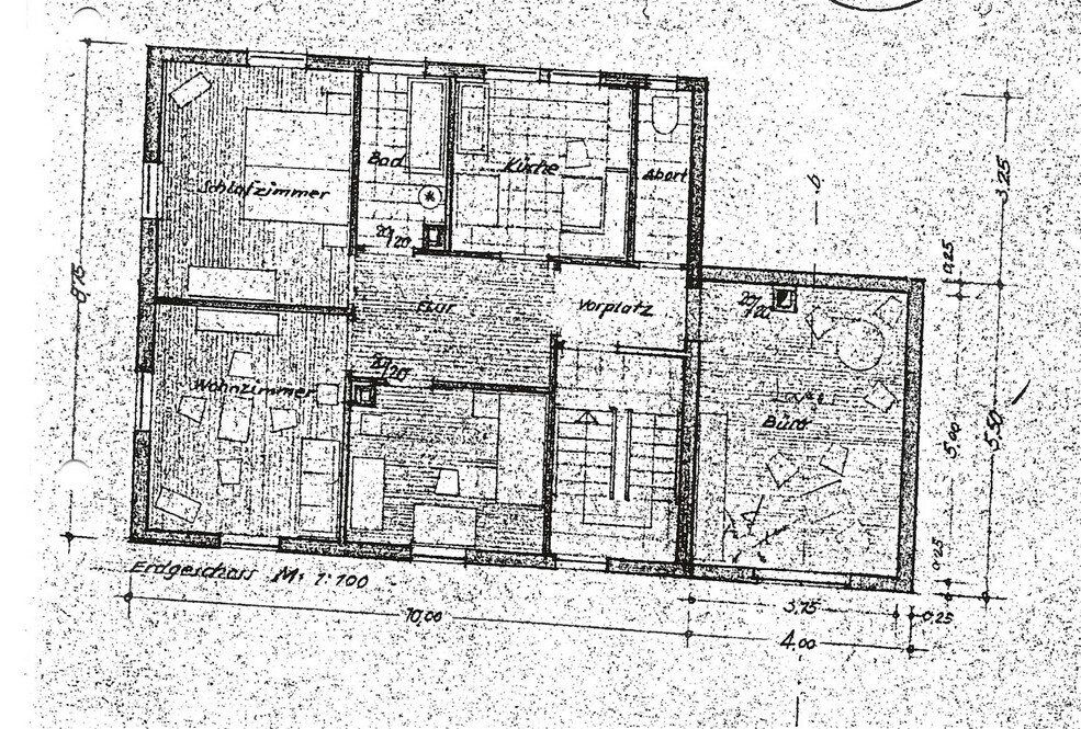

A full basement is still under consideration. We could probably manage with a partial basement. The planner said that by removing half of it, we could save around 50,000€ (about $54,000).
If the dashed line represents the current terrain, then I don’t see a basement at all here. Do I really have to translate the 11ant >basement rule still into German as a foreign language?
KJaneway schrieb:
Thinking out loud: leaving out the basement means the technical room, storage, and hobby room have to be moved upstairs. Also, we will need to buy fill material since the basement excavation is already done.
Draw in the existing basement—how dilapidated is it really?

A small input regarding the basement consideration: we had a similar situation in our planning – two full stories plus a penthouse and a basement underneath. Since that results in a pretty large house in terms of square meters and cost, we started trying to reduce the size of the house, make it narrower, etc. But it was a dead end to compromise the beautiful, functional floor plan because of the basement.
Then we thought about why we actually needed the basement with its four rooms – mostly for technical equipment and storage. We don’t have any underground hobbies – just expensive storage space.
So we got rid of the basement, kept the above-ground floors in their perfect size, and even added some space for technical/utility rooms and storage.
We celebrate that decision every day, that we don’t have a basement hole under our stairs that only collects clutter, is dark, and requires maintenance and cleaning. Laundry is done on the ground floor near the technical area, and we have a nice, cozy closet and storage room on the upper floor, without any mustiness or anything like that…
That was one of the best decisions in our planning process.
From our perspective, forget about a partial basement – any material you save there has to be spent elsewhere on supports, foundations, etc. And the excavation hole for a partial basement is initially just as large as for a full basement. You still need stairs, so even if the basement is half the size, you don’t save half the cost.
My general contractor even said he could reduce the basement size if I wanted, but the price would remain the same…

From our point of view, forget about a partial basement. The materials you save there you’ll have to spend elsewhere on supports, foundations, etc. [...] You still need a staircase anyway, so even if the basement is half the size, you don’t save half the costs.
No, only about 30% – see also: "Partial basement: The solution between yes and no?".

I would also turn the master bathroom into a small shower bathroom. The family bathroom is on the children’s floor.
We will definitely look into that. Gaining space in the attic would be great. On the other hand, we have already grown a bit fond of this wellness area. Isn’t it said that you should first plan what you want and then cut back according to budget? At least, that’s what I heard in the video by Mr. Zink (linked as a second opinion on the 11ants site regarding the basement rule).
The closets in the attic could be moved into the rear attic space so that behind the 2-meter (6.5 feet) height on the floor there is still decent storage area. As mentioned earlier, opening the dressing room from the hallway.
Do you mean converting the sloping roof areas that are too low to stand in into closets? That’s exactly our plan. We even considered placing the bed on the gable side under the window.
There is nothing to change on the children’s floor at the moment. The gallery offers additional workspace or a play area. Whether to put a TV for the kids there or a craft table, there is definitely room to develop.
Also our plan: a play corner, a scratching post for the cats, etc.

b) The kitchen: it’s way too small for 5 people. You can tell from the little figure. Only one person fits there.
I also find the entrance area too small for 4-5 people.
I think that with a small extension and revision of the upper ground floor plan, the house could gain — possibly without a basement.
By the way, I see the main access to the terrace rather through the kitchen.
Hmm, yes, one could add a small extension from the kitchen to the garden. I will sketch that out. This could be turned into a balcony on the upper floor and the balcony could run along the building side from the south end to the north end. With a 1 to 2-meter (3 to 6.5 feet) extension, the kitchen could easily be enlarged by 5 to 10 square meters (50 to 110 square feet) and become less narrow. We are still considering whether we really want the pantry or prefer to invest the space into the kitchen. It would still be a narrow room but definitely improved by a better side length ratio.

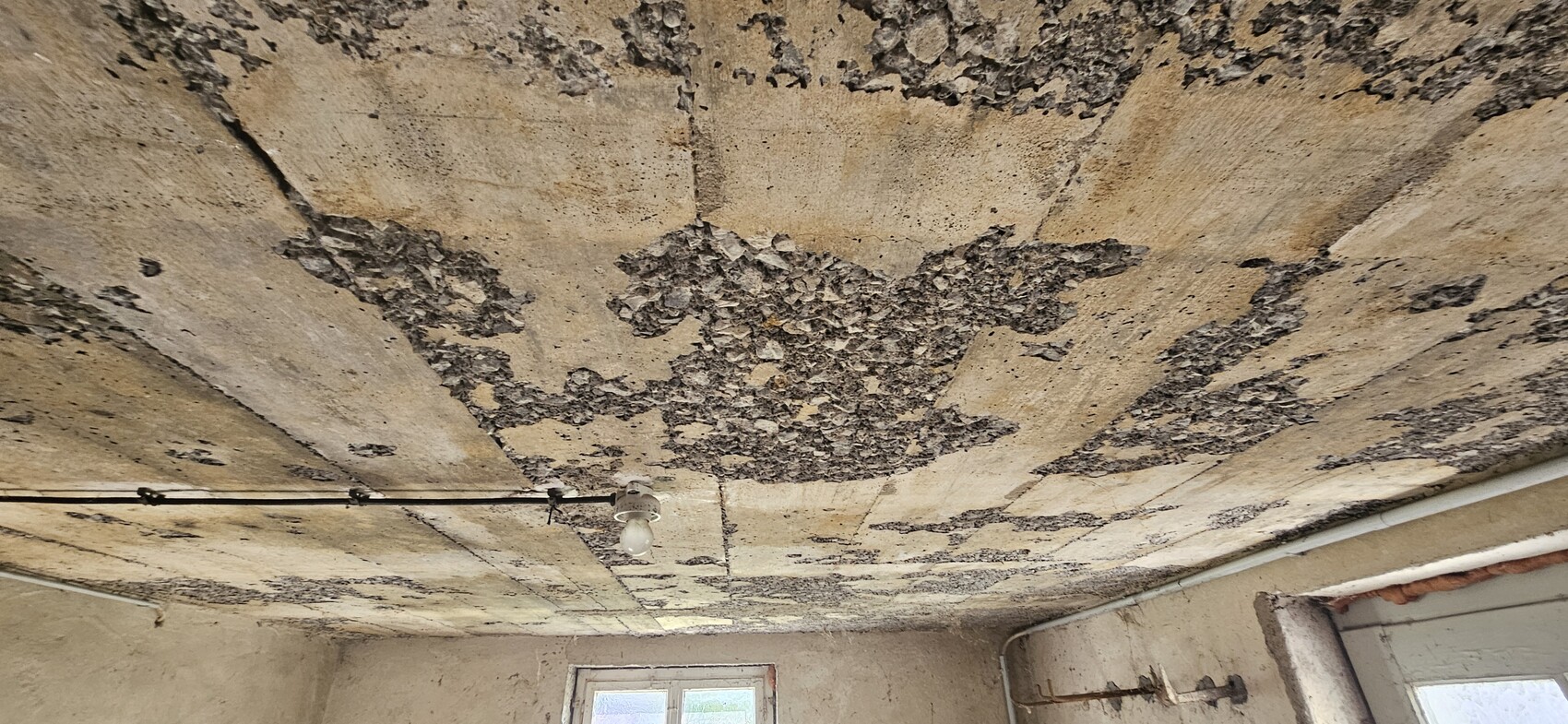

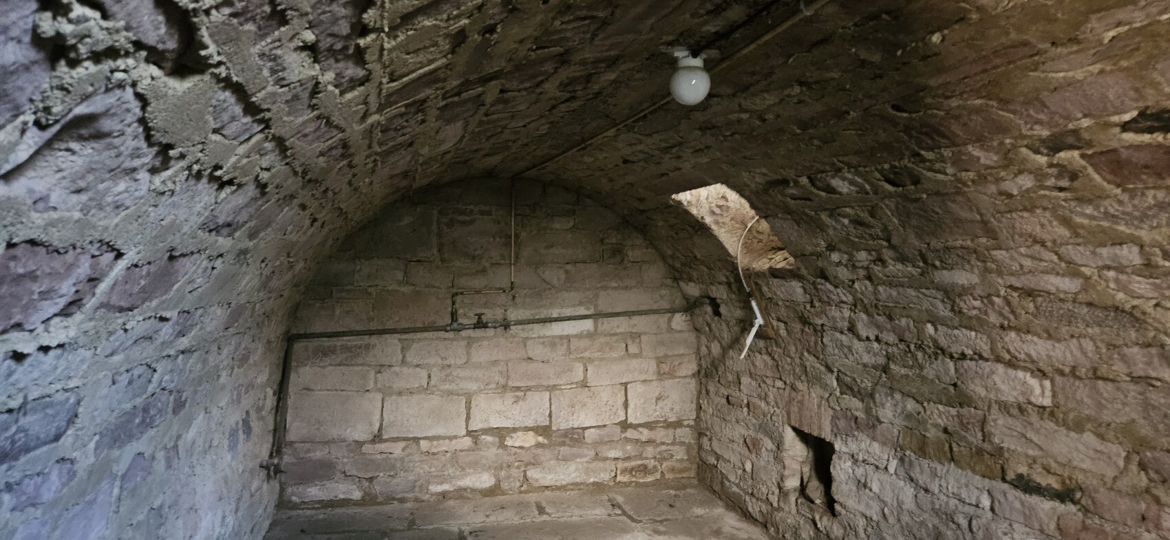

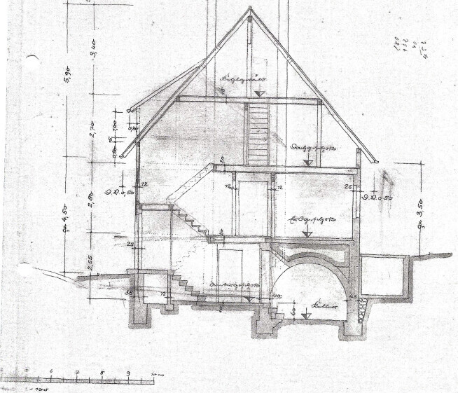

To skip the basement, I would need about 15 square meters (160 square feet) utility room on the ground floor, additional storage space on both ground and upper floors, and the hobby room on the upper floor. Here, one could extend the rear addition (2 meters / 6.5 feet) up to the top floor. That would generate about 25 square meters (270 square feet). Additionally, the house could be extended by 1 meter (3 feet) directly next to the garage, adding roughly 30 square meters (320 square feet). A total of 55 square meters (590 square feet). That would cover 15 square meters (160 square feet) for the utility room, 10 square meters (110 square feet) added to the kitchen, plus 15 square meters (160 square feet) each for hobby and storage rooms. Could work. Am I thinking in the right direction? Or have I misunderstood something?
38 and "about 50" is a big difference — not only as clothing sizes.
Hmm, I need to ask the planner again here. He first planned a house with a 38° roof pitch and changed it to 45° for the second draft. But the plan still says 38°, so maybe a typo. We were actually hoping for a steeper roof to have a bit more clear height > 2 meters (6.5 feet) in the attic.

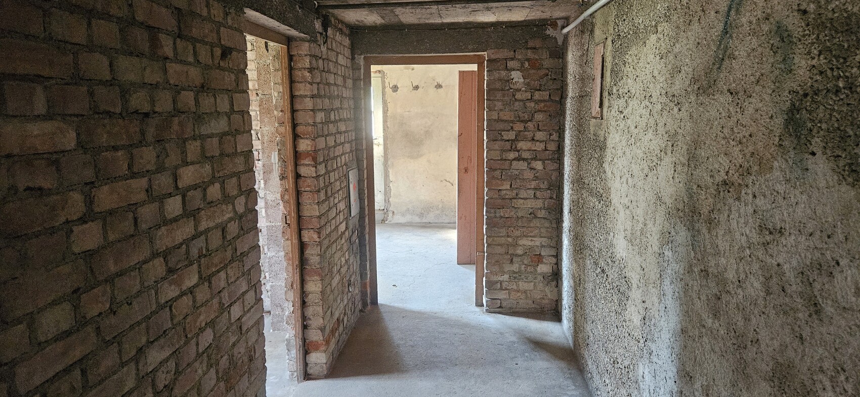

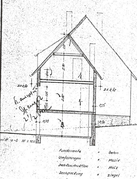

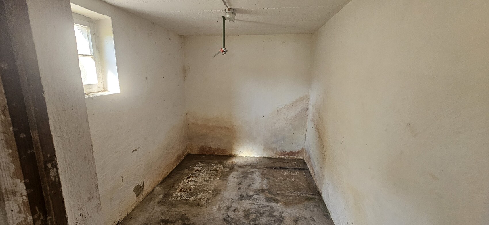

If the dashed line is the current terrain, then I don’t see any basement here at all. Do I really have to translate the 11ant > basement rule into German?
The dashed line is the terrain. I have read your website thoroughly, though I didn’t understand everything and internalized even less. After all, I don’t deal with this daily. We are facing the decision: basement and smaller house, or no basement and larger house. Financially, according to your basement rule (if I understand it correctly), the second option is more sensible here. However, the plot is not very large and we want a lot of open space. In the end, the decision leans towards the basement (= more space but also somewhat more expensive). But it might be worth revisiting.

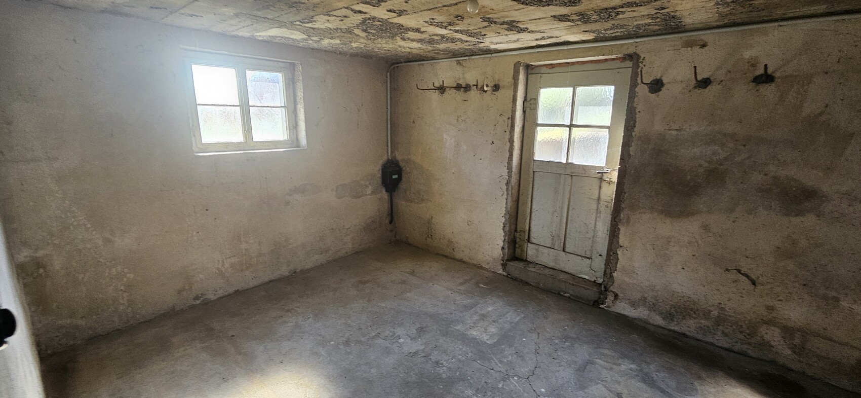

Draw the existing basement once — how dilapidated is it really?
See the attached screenshots and photos. Thanks also for this question: it actually makes me reconsider the basement. As I understand it now, the new basement would be almost entirely below the level of the old basement. According to your basement rule, a basement here wouldn’t make sense — at least not economically. Let’s see what wins out: the wish for a basement or a larger house. I have the impression it will also be expensive to keep the old basement as it’s quite high, and presumably you can’t build two full floors plus a steep gable roof above it without overly exceeding neighboring buildings.
How many deities are you praying to that this will be enough?
Our deity here is the head of the local demolition company who walked through the building with me and raved about how simple it is. He sent me an offer of €30,000 for site setup, demolition down to the top of the foundation, disposal, and gutting. The plot will be handed over leveled. Backfill material would be charged separately. The builder must disconnect the electricity (this will add about €2,500 — offer from the network operator including civil engineering is also available).

Overall, we have already fallen in love with the basement because it provides more room on the plot (= smaller house). But I also see that the ground floor is quite cramped: small entrance hall, small storage, small toilet (that’s sufficient), small kitchen — whether with or without pantry. We like the upper and attic floors in principle (apart from minor details that still need optimization).

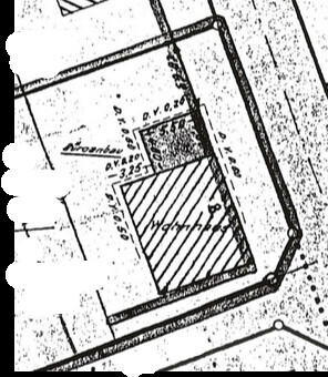

Pictures of the old house and photos of the basement: (the small site plan is 1:500)
Section drawing of a house with foundation, walls and roof
Cross-section through a multi-story house with stairs, floors, basement, and roof structure
Floor plan of a house with living room, kitchen, bathroom, hallway, and staircase
Floor plan of a basement floor with hallway, basement rooms, stairs, and garage
Floor plan of a building with marked area
Interior view of an unfinished building: brick walls, doorways, rough concrete floor
Ceiling with flaked plaster, damp spots, hanging light bulb, window below
Dark stone vaulted cellar with arch, visible pipes, light bulb on the ceiling, opening on the right wall
Concrete basement room with small window, door, hook rack and old electrical box
Small vacant basement room with damp spots on floor and walls; window on the left
11ant11 Jul 2025 14:50
KJaneway schrieb:
Isn’t it usually said that you should first plan what you want and only then start cutting the budget? At least that’s what I heard in the video by Mr. Zink (linked on 11ant’s site as a second opinion regarding the basement rule).
Secondly, I wouldn’t have linked Mr. Zink if he just echoed my opinion, even if only in Bavarian dialect. Rather, I deliberately included his perspective to provide insight into different experiences and somewhat differing recommendations from another professional.
And first, the (avoidable if you closely follow my advice!) common practice of progressively reducing scope based on the budget is the economically most significant reason why critical decisions (including size calibration) need to happen during the design freeze: so that you don’t start a reduction process in the costly later design phases!
KJaneway schrieb:
I have also read your website thoroughly, though I haven’t understood or internalized everything, which is natural since I don’t deal with this daily. We are currently deciding: basement plus smaller house, or no basement and a larger house. Economically speaking, according to your basement rule (if I understand it correctly), the second option would make more sense here. However, the plot isn’t very large and we want a lot of outdoor space. In the end, we leaned toward the basement (= more space but somewhat more expensive). It might be worthwhile to revisit this decision.
The basement rule does not include a second option — which one would that be?
Economically (and it is designed for no other purpose), the rule concludes that a basement on this plot is a luxury. However, this refers to the raw plot; in this specific case, I recommend a sympathetic review of keeping the existing basement!
Anyone who reads my website thoroughly should notice that there is a comment function at the bottom of each post for readers’ questions (and there is also an editorial hotline with landline rates noted at the top of the site).
KJaneway schrieb:
Thanks also for that question: it made me reconsider the basement. As I understand it now, the new basement would be almost entirely below the level of the old one. According to 11ant’s basement rule, that would mean no basement is economically viable here. We’ll see what wins out: desire for a basement or a bigger house.
I get the impression it could be expensive to keep the old basement, especially since it sits quite high and you probably can’t build two full upper floors plus a steep pitched roof on top without significantly surpassing the neighboring buildings.
The existing basement is a not fully underground basement by contemporary standards, which gives the house a raised plinth. If I recall correctly, we are dealing with a §34 plot here — so the existing building volume should be a strong benchmark for what is permissible.
KJaneway schrieb:
Admittedly, that’s probably true. In forum discussions, one often jumps back and forth between questions related to different planning phases.
I meant that the question of the building form and arrangement should have been discussed with the planner before any drawings were produced!
During the planning phases of Module B, the planner’s billing accelerates noticeably, so the essentials must be firmly established before entering the expensive phases!
KJaneway schrieb:
Okay, that’s already the second comment about the exterior appearance. Do you have a search term or example image I can look at to see how it’s typically done? I gather that the house shape itself isn’t the problem, but rather the look created by the windows. In the end, we also feel there are too many floor-to-ceiling window elements.
Too many floor-to-ceiling elements are a hallmark of the current trend — designing as if you’d won the lottery. On the garden level, I typically propose only two exits: one to the terrace and one from the kitchen to the herb garden. On floors that require fall protection, every floor-to-ceiling window is a (decadent) luxury — which is exactly why they are overused in these “replacement villas.”
By “apartment building look,” I assume you mean a facade that suggests that the floor plans on each level are the same. I see this neutrally, as a matter of taste and not a flaw. A cheap or cheap-feeling appearance can usually be avoided at the finishing stage.
