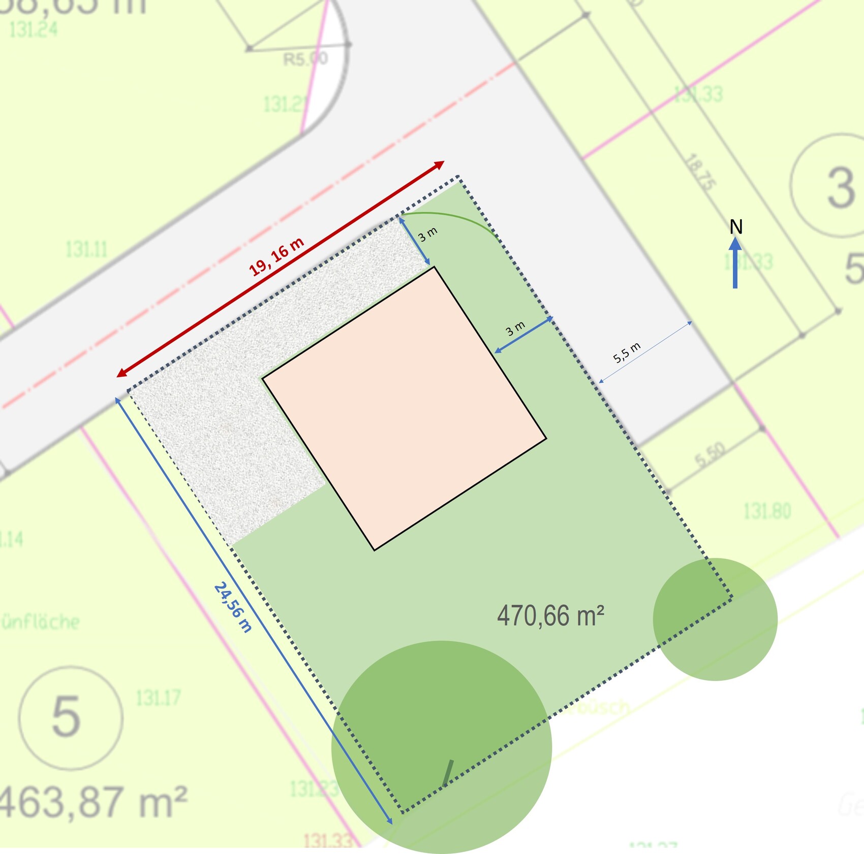

After recently purchasing our plot of land, we are now facing the challenge of planning a suitable house for it. At first, it may seem like a simple task to pick a ready-made prefabricated house off the shelf or from the vast options available online. However, given the many personal requirements and available variations, you quickly realize it’s not that straightforward.
The plot is located on a private road right next to a cul-de-sac, almost ideally facing southwest with an unobstructed view of a field. There are no immediate neighbors to the left and right, as both adjoining plots remain undeveloped. We currently live in 95m² (1023 ft²) across two rooms. Since there are now three of us, we simply need a third room. Our living room is open-plan and, including the kitchen with an island, measures 45m² (484 ft²). We would prefer not to reduce this space with the new build.
Although we have provided our builder with a fairly clear picture of our wishes and what might be considered first-world problems, the implementation so far does not feel quite like what we envisioned.
Zoning plan/restrictions
No zoning plan, §34
Plot size – 470m² (5059 ft²)
Slope – no

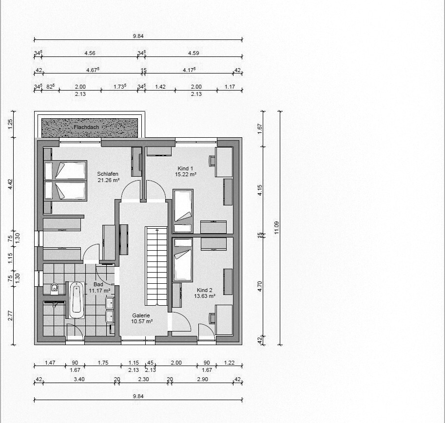

How can we maintain privacy on the upper floor despite the open-plan design?
We find the window arrangement in the bathroom too exposed.
The gallery window on the upper floor is a nice feature, but there will be a house directly opposite.

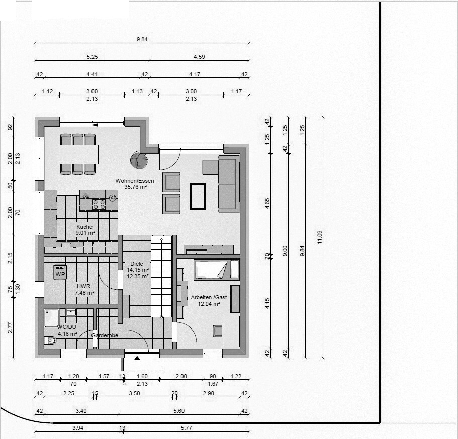

Large open living, dining, and kitchen area, bay window to extend the living space
What do you not like? Why?
Entrance area including wardrobe, guest bathroom, utility room – feel too small/cramped for everyday family life with children
It feels like a lot of storage space doesn’t fit well with the construction style – or is that possible?

House width was reduced by 50cm (20 inches) from 10m (33 ft) to provide enough space on the narrow plot for a 6m (20 ft) double carport.
How can a two-story house be designed on this plot to minimize wasted space while maintaining an open layout with enough privacy and storage—especially in the hallway?

Site plan: building on green area, plot 470.66 m², north at top.
Floor plan of a single-family house: kitchen, living/dining, hall, office/guest, wardrobe, WC/shower, utility room
Floor plan of a house with bedroom, bathroom, gallery, and two children's rooms.

8.84m versus 9.84m (32 feet) – if the planner placed the entrance facing the street, it probably doesn’t add any value. I would access it from the side, which has many advantages here.
Basically, you now have a terraced house: the west side has no windows at all... why not? West side is important. In summer, the sun sets in the northwest... you have that orientation on your plot!
This current floor plan is actually one of the most commonly discussed here, although always with different dimensions and minor changes, but that’s the point.
You should try furnishing the rooms with existing furniture: the dining area isn’t very wide. But it might work with slim chairs.
Living room: 2.90m (9.5 feet) narrow at the back, 4m (13 feet) wide at the window. Funnel-shaped and the armchair faces the street – more of a disadvantage than a benefit.
So consider how it will be furnished – with the back to the window or giving up a 3-meter (10 feet) sectional sofa?

Back to the house: The walk-in closet has only 75cm (30 inches) between the wardrobes? That’s too narrow. How does the bedroom feel? Not great – openings everywhere.
How wide is the bedroom? The dimensions aren’t visible. The upper floor lacks a storage room. The toilet in the bathroom takes away space from the small room. There are only corridors.
The children’s rooms have no windows on the sides... 🙁

I would make it slimmer, entrance from the east, a long open-plan area with the kitchen facing south.
A double half-turn staircase saves space.
