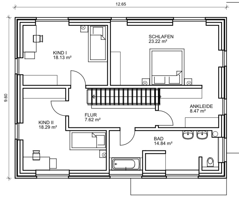

we are currently working on our floor plan and are starting to get a bit frustrated.
We have now had an optimal floor plan created for us.
We are very satisfied with everything except that the child II room feels too narrow.
The depth in the entrance area (child II) is about 2.5 m (8 feet 2 inches). The depth in the lower section is about 2.37 m (7 feet 9 inches). For comparison: child I is approximately 3.58 m by 5.0 m (11 feet 9 inches by 16 feet 5 inches).
According to our draftsman, this is due to the fact that, according to the current DIN standard, stairs must have a minimum tread depth of 260 mm (10 inches). This makes the staircase significantly longer than in the floor plans we previously reviewed.
Maybe someone here has a good idea on how to still improve this situation.
We appreciate any suggestions.

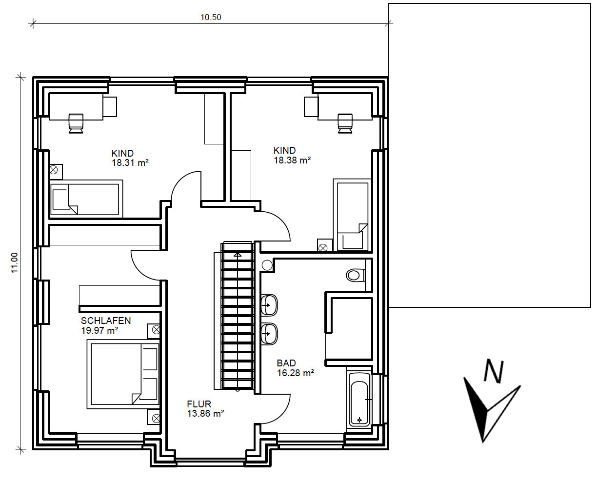

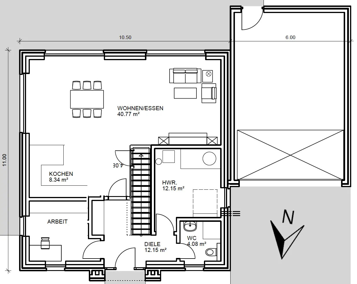

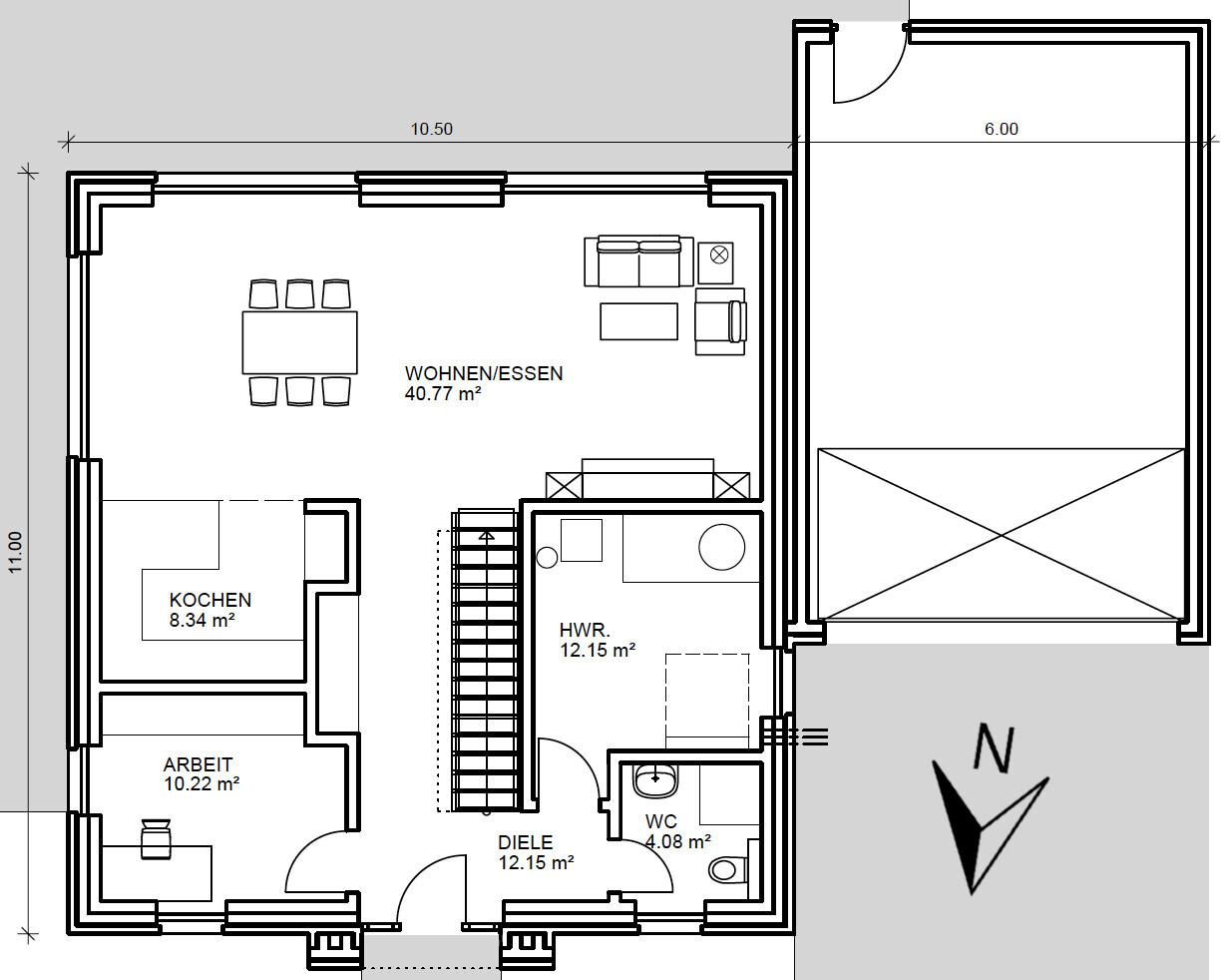

We have completely discarded the last floor plan and returned to the original design. The following plan has been developed as a result.

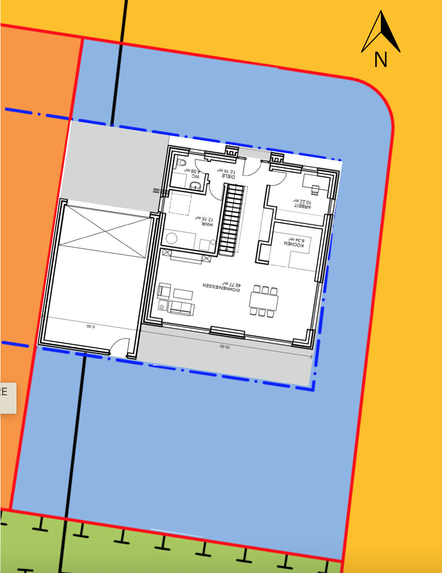

Peppoderwilde4 Feb 2023 08:28I placed the floor plan onto our plot (corner lot). I think I had the north arrow wrong on the first floor plan :p Now it’s correct. We would definitely prefer a straight staircase. Which staircase design do you think would fit better here? The kitchen could still be redesigned a bit. We don’t have any ideas for that yet. 🙄
Peppoderwilde4 Feb 2023 09:23At the front area of the building plot, approximately 16.5 m (54 feet) wide, and at the rear area of the building plot, approximately 17.0 m (56 feet) wide.
I don’t find this design wrong in terms of the dimensions. You could open up the kitchen more – but the added value wouldn’t be dramatic.
The double garage takes up a lot of your valuable building space. How important is it? Are there alternatives, such as a compact carport closer to the street? Is there a minimum setback from the street required?
