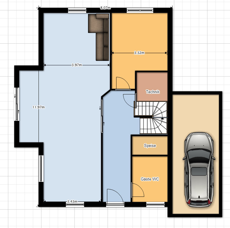

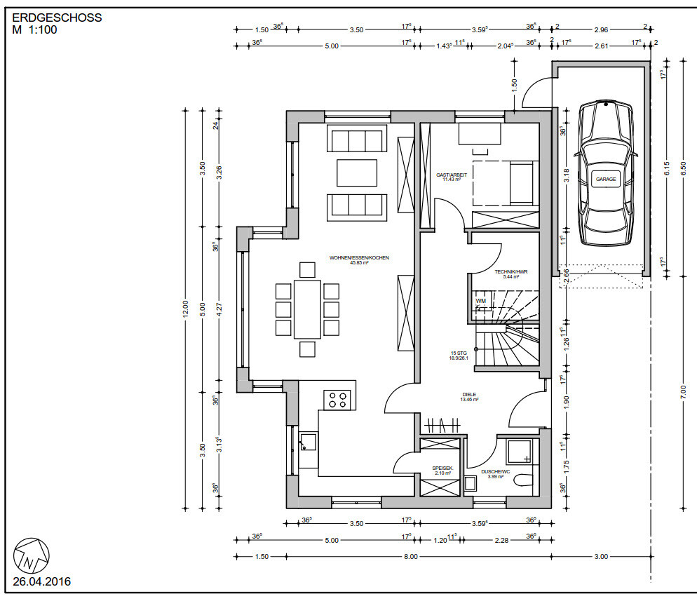

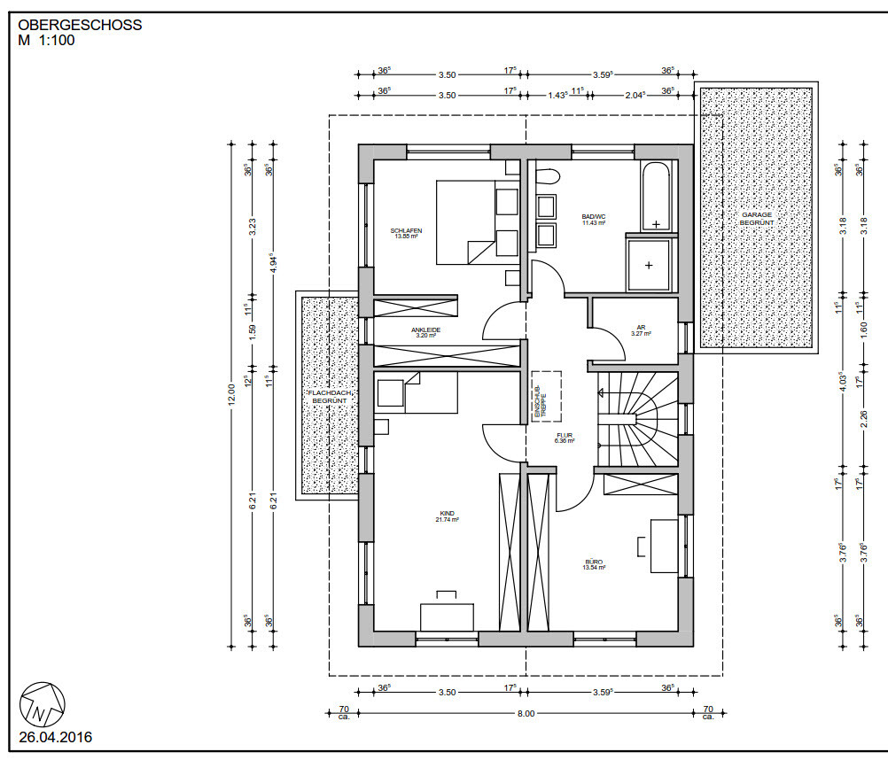

Painkiller30 May 2016 11:07Hello everyone,
We are fortunate to have acquired a plot in a new development area. However, the building envelope seems to be designed more for a duplex than for a detached single-family home. Since our neighbors and we would prefer a detached single-family house, we are looking for solutions and improvements to the architect’s floor plan. As our family owns a construction company and we are receiving a “discount” because of this, we are somewhat tied to the architect, even though the design doesn’t always maximize the potential.
Therefore, I would like to ask you to take a look at the floor plan. I have also attached another draft of my own. I am open to suggestions and opinions.

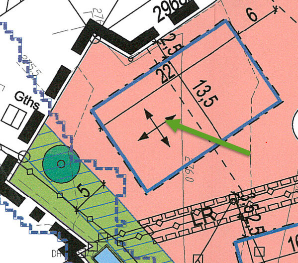

Development Plan / Restrictions: Development plan attached
Plot size: 446m² (4799 sq ft)
Slope: none
Site coverage ratio: 0.4
Floor area ratio: 0.8
Building envelope: 11 x 13.5m (36 x 44 ft), but due to setback, max. 8.5 x 13.5m (28 x 44 ft)
Building line and boundaries: –

What do you especially like?
Orientation of living rooms towards south/southwest, space utilized under the stairs
What do you not like?
Side entrance. Because the entrance is on the side and the garage is set back, parking will be awkward and there is no room to place a doormat in front of the door…
Only 3.5m (11.5 ft) width for the living room, 4m (13 ft) would be preferable. However, I don’t like the hallway/staircase in my own design either because the stairs feel cramped and the hallway is quite long.

schlumpi12330 May 2016 19:41First of all, I don’t like your design. Personally, I’m not a fan of bay windows, as they are not really practical and they cost extra. If I were you, I would leave it out and instead widen the house by half a meter or a bit more; the additional cost should be manageable. The garage seems too narrow for me. Does it have to be a garage, or would a carport work as well? Maybe a slightly longer one so that the main entrance is covered?
Painkiller31 May 2016 07:02We are using the bay window to extend slightly beyond the building boundary and also to break up the 3.5m (11.5 ft) long narrow living/dining area a bit.
Having a garage would definitely be desirable. Ideally, it will be a prefabricated garage with an interior width of 2.86m (9.4 ft), which is certainly not very spacious but at least provides a safe spot for a motorcycle and a small workbench.
If it would be very helpful for the floor plan, we could of course consider including the garage, but the building boundary only allows a maximum width of 8.5m (27.9 ft). Therefore, it is questionable whether giving it up would actually benefit us.
Painkiller schrieb:
We use the bay window to extend slightly beyond the building boundary. Besides, it helps to visually break up the 3.5m (11.5 ft) long narrow layout of the living and dining area.Is something like this allowed?
Painkiller31 May 2016 07:09According to the state building code (§5 paragraph 6), yes, if it is not larger than 1.5m x 5m (5 feet x 16 feet)...
