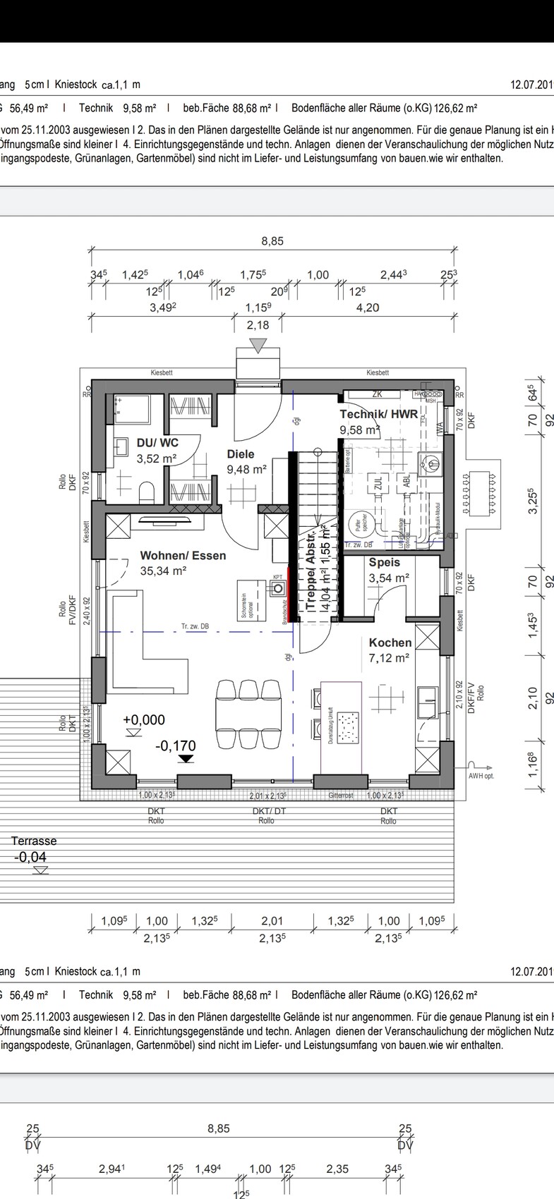

Floor plan of a house: living/dining area, kitchen, hallway, pantry, utility/technical room, shower/toilet, terrace.

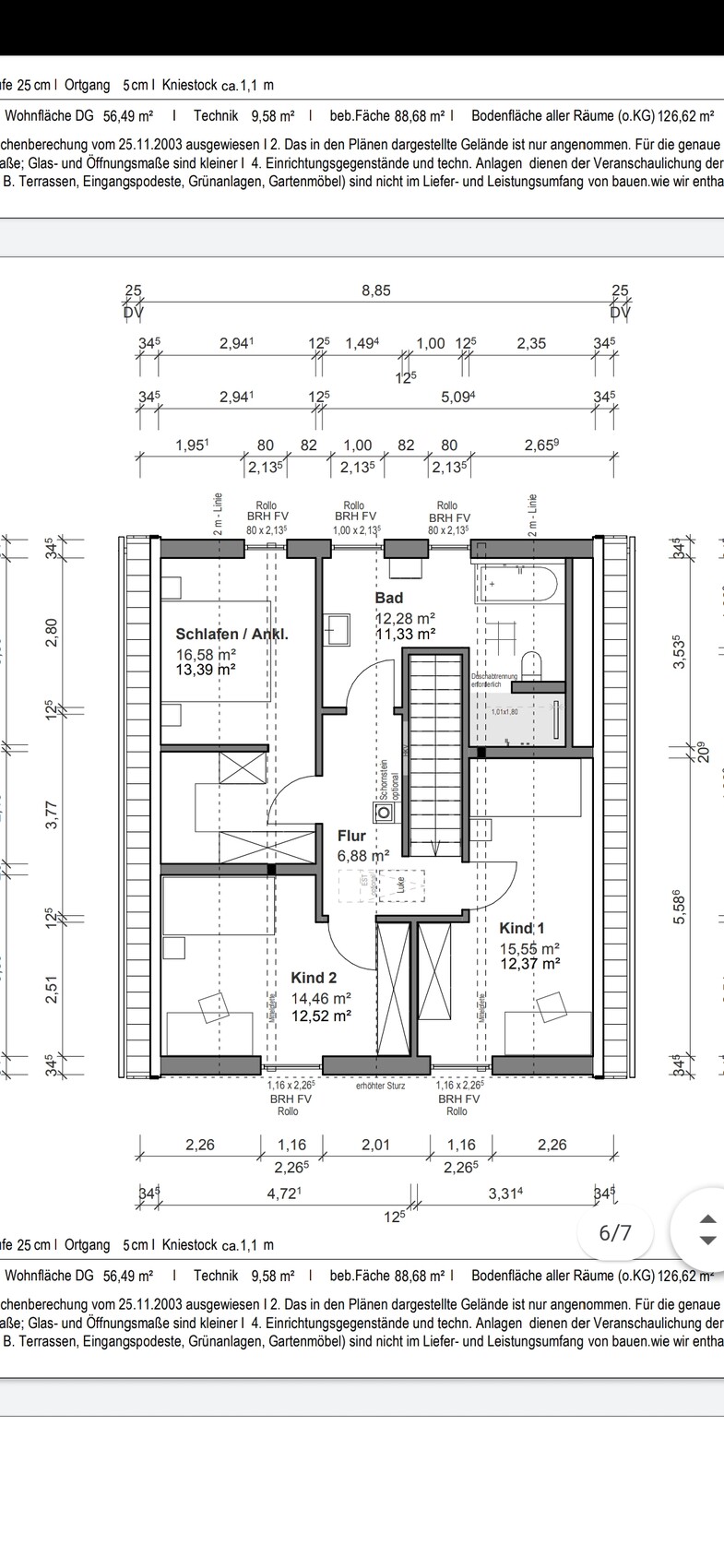

Floor plan of the attic: corridor, bathroom, bedrooms, staircase.

Why do you particularly like the upper floor? I think it’s completely ruined by the straight staircase.
If I had to choose, it wouldn’t be an option because Bedroom 1 is terribly ugly, the dressing room hardly has space for tall wardrobes, and the bathroom is like a maze. On the ground floor, I would definitely swap the kitchen and the chill-out room. I would also combine the space under the stairs with the pantry and move the door to the left side according to the plan. But, of course, nothing is allowed to be changed...

If I had to choose, it wouldn’t be an option because Child 1’s room is terribly ugly, the walk-in closet hardly has space for tall cabinets, and the bathroom is a maze.
I couldn’t have put it any better.

I can tolerate the compromise of an impractical design if it’s just two of us.
As a family, I find it impossible. The upper floor is the absolute worst!!!
Tip: With 127sqm (1367 sq ft), avoid a straight staircase!

What I noticed: The passage in the living room between the sofa and the dining table, or between the dining table and the counter, might be a bit tight.
I would estimate the total distance from the wall to the counter is 5m (16.4 ft). With a 2m (6.6 ft) sofa and a 2m (6.6 ft) dining table, that leaves about 50cm (20 inches) of walkway on each side, which can feel quite narrow and would make sitting comfortably at the counter difficult.
I don’t think the upper floor is bad at all. For Child 1, you could install cabinets under the sloped roof and place a desk in the higher area.
I also think that the straight staircase fits this floor plan very well.

Tip: Avoid using a straight staircase for 127m² (1370 sq ft)!
This.
