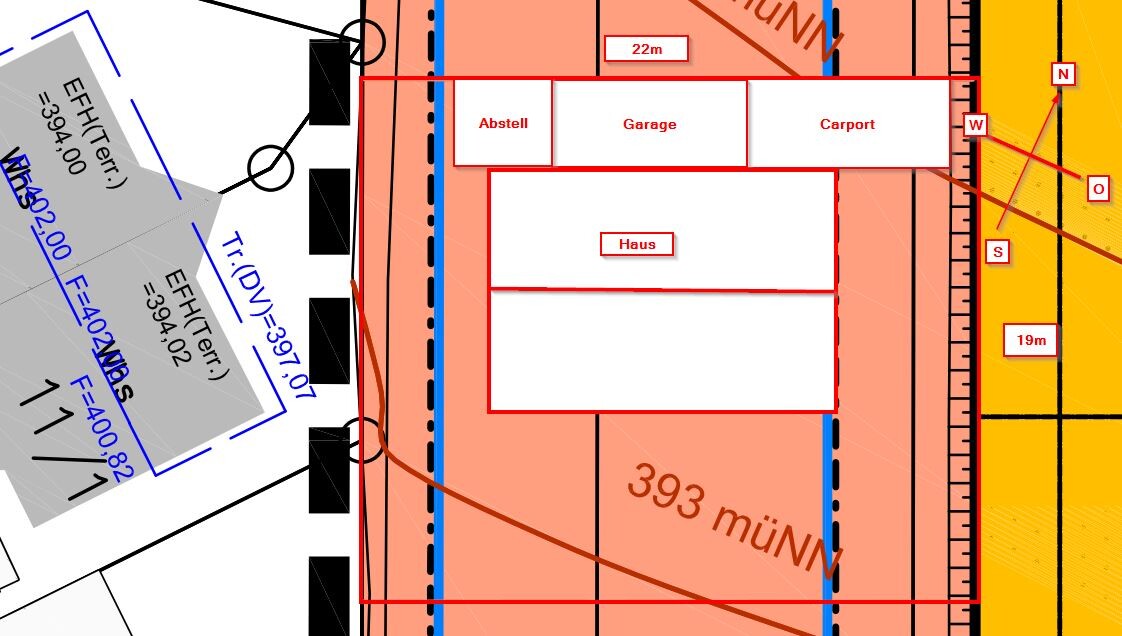

-Can’t give up: studyPlot additionally supplemented in the development planhanse987 schrieb:
A carport in front of the garage will almost certainly count as only one parking space, since the parking spaces need to be usable independently of each other.Thanks for the tip. However, we are also planning an additional parking space to the left of the carport.That's correct, like this
Hi, sorry, I completely forgot to mention that. It's Baden-Württemberg. The state building code states: "If there are different heights on a wall due to the terrain surface, for determining the wall height according to sentence 2 no. 1, the highest point of the terrain surface shall be used as the basis. Boundary construction along individual neighboring boundaries may not exceed 9 m (30 feet) and a total of 15 m (49 feet)." Whether the carport counts toward this, I don't know, but the architect will certainly know.
Michilo schrieb:
Which federal state are you building in? In NRW, a total of 18 m (59 feet) of boundary construction is allowed, with a maximum of 9 m (30 feet) on one side. With the carport, garage, and storage room, you are well above that.
