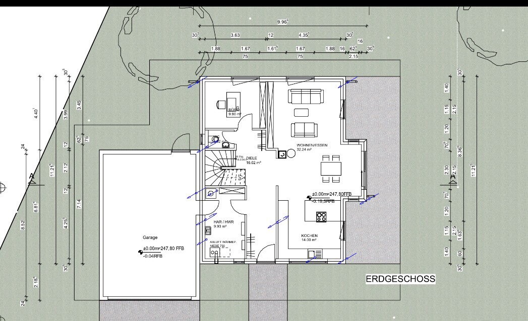

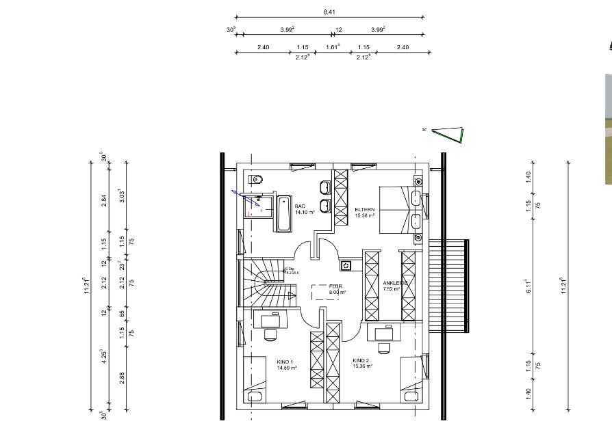

This is the first draft from our architect. What could be done differently? The guest toilet is poorly positioned. The floor plan on the upper floor is acceptable for the moment.
We welcome tips and ideas for the ground floor.
Grundriss-Dachgeschoss: Flur, Elternzimmer, Kind 1, Kind 2, Ankleide, Bad, Treppe.
Grundriss Erdgeschoss mit Innenräumen, Treppenhaus, Küche, Bad, Büro, Garage und Grundstücksgrenze.

By mirrors, I mean more the layout of the rooms. Bathrooms stacked above each other, 1m² (11 ft²) less won’t affect the bathroom. That can definitely be managed.

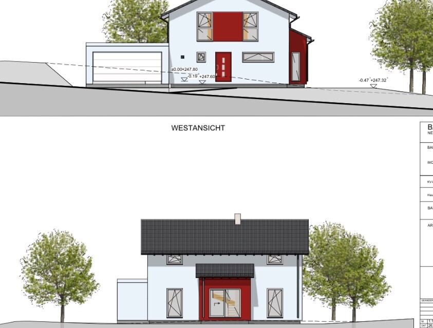

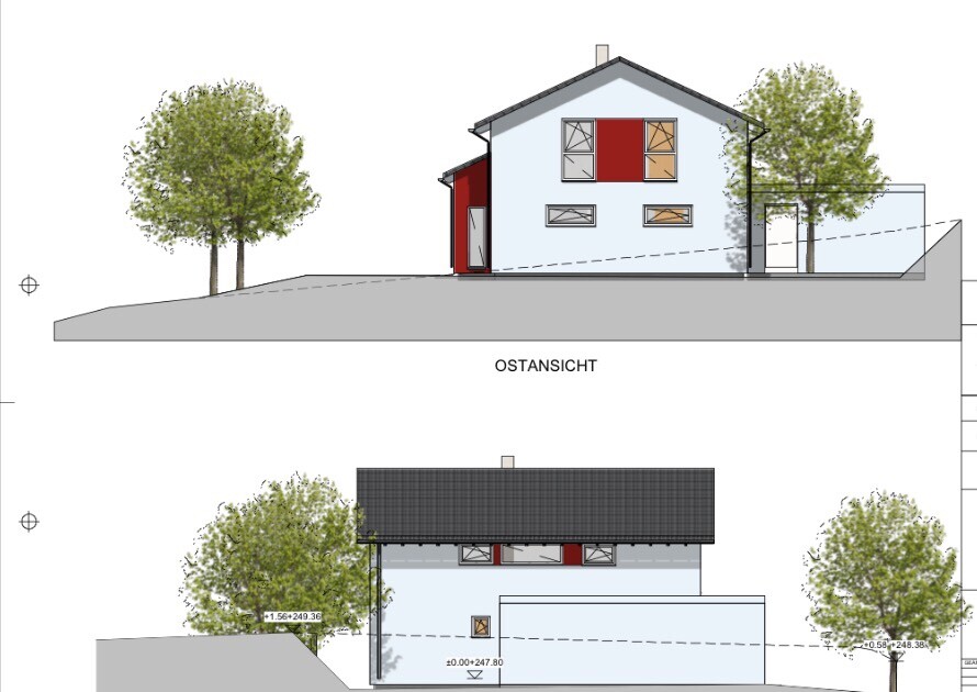

Changed again....
A second utility room is out of the question.
Any other ideas?

Two-story residential house with red entrance, garage on the left, window fronts and trees (west/front).
East view of a hillside house, two stories, blue facade, red shutters, trees.
Floor plan upper level: master bedroom, two children's rooms, bathroom, walk-in closet, hallway, stairs.
Floor plan ground floor: garage on the left, entrance hall, kitchen and open living/dining area.
26 May 2015 10:43
That works.
I would also try to modify the staircase run, then move the door to the WC under the stairs, and shorten the hallway accordingly. The wardrobe would then go next to the door to the office.
