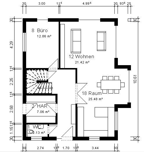

This is the first draft from our architect. What could be done differently? The guest toilet is poorly positioned. The floor plan on the upper floor is acceptable for the moment.
We welcome tips and ideas for the ground floor.

7 m² (75 sq ft) should be enough for the utility and laundry rooms. Additionally, there is the storage space under the stairs for the vacuum cleaner and similar items.
You’ll probably need to do ironing in front of the TV or in the office.
You’ll need to create storage options on the property for things you would otherwise keep in the basement.
Kitchen items should fit well in the kitchen — it’s already large (with many cabinet units).
I would make the entrance area larger. It’s already better as it is, but with children, a lot can really end up left there. Also, I would integrate a shower into the bathroom on the ground floor. It takes a few square meters (square feet), but it saves stress when the kids are teenagers.

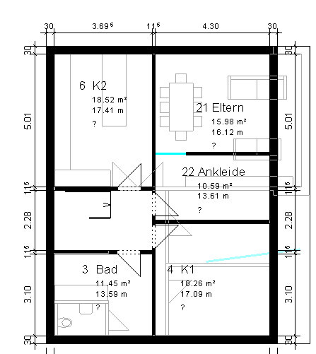

If you skip the walk-in closet, there would be space for an office on the upper floor. Alternatively, the washing machine could be placed elsewhere, allowing the utility room to be smaller.
