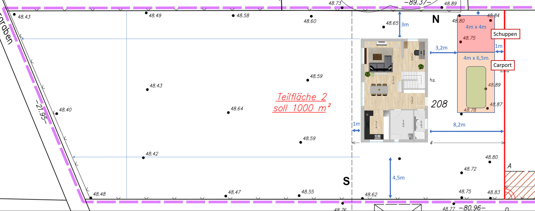

Site plan: large blue building, carport and shed on the right; subplot 2 1000 m² (10,764 sq ft)
kaho67411 Mar 2020 10:36
To my knowledge, this is the location:
Ground plan of a building plot with a residential house, carport on the right, shed top right and dimension details.
Ibdk1411 Mar 2020 11:00
Thank you! Oh no, I don’t really like the orientation either. Was this already discussed in the previous posts? Is the ridge direction fixed? What’s the purpose of the more than 3 meters (10 feet) between the house and the carport? Parking space? Couldn’t the house simply be rotated 90 degrees so that the living areas face south? It might just work despite that annoying dashed line, whose purpose I don’t understand, especially on such a large plot.
I have to admit that I’m not an expert at reading plans, but I don’t see any restrictions that would require the house to be positioned exactly like this and nowhere else on the property.

Can someone tell me how the house is positioned on the plot? In the first post, I see the entrance on the east side but no north arrow. My posts so far referred only to the floor plan itself. I liked the last one, although I would probably mirror the stairs so one goes up from the dining area (even if it doesn’t look as nice on top). But now I’m wondering why the long house is positioned like that on the plot.
Would be nice if someone could tell me the actual orientation and location of the house with the post number. I must have missed something.
Ibdk14 schrieb:
Thanks! Oh no, I don’t like the orientation that much either. Was this already discussed in previous posts? Is the ridge direction fixed? What are the more than 3 meters (10 feet) between house and carport for? Parking? Couldn’t you just rotate the house 90 degrees so the living areas face south? It could still work despite the dotted line, which I don’t understand the purpose of on such a large lot.
I must admit I’m a layman reading plans, but I don’t see any restrictions requiring the house to be positioned exactly as shown.
Looking forward to enlightenment, even if it doesn’t help the OP. It’s just private interest and my own learning.
Thanks for digging out the site plan, @kaho674. At first, we thought about square (prefab) floor plans. But my architect friend advised orienting a longer side toward the garden and the sun, for energy and comfort reasons. Makes sense. There is no development plan, so no mandatory ridge direction. The dotted line marks the building limit—you cannot build beyond it because there’s a nature reserve behind the angled plot boundary. We want to leave enough space at the front of the plot to keep options open for a future extension (mainly for our parents if they can’t live independently anymore, see sketch in post #158).
And why someone would want to rotate it 90°, please explain that in more detail. Yes, it’s true that at solar noon the light comes exactly from the top left corner into the kitchen, so the living area gets afternoon and evening sun—which is what you mostly use the living room for. But if you rotate it, you’d be looking at the neighbor instead of the garden, which is a serious argument too. And I find evening sun at the desk in the study quite distracting as well.
In...
Ibdk1411 Mar 2020 12:28
That was just me rotating it by minus 90 degrees so that the living areas face south instead of west. However, your comments have answered my question.
