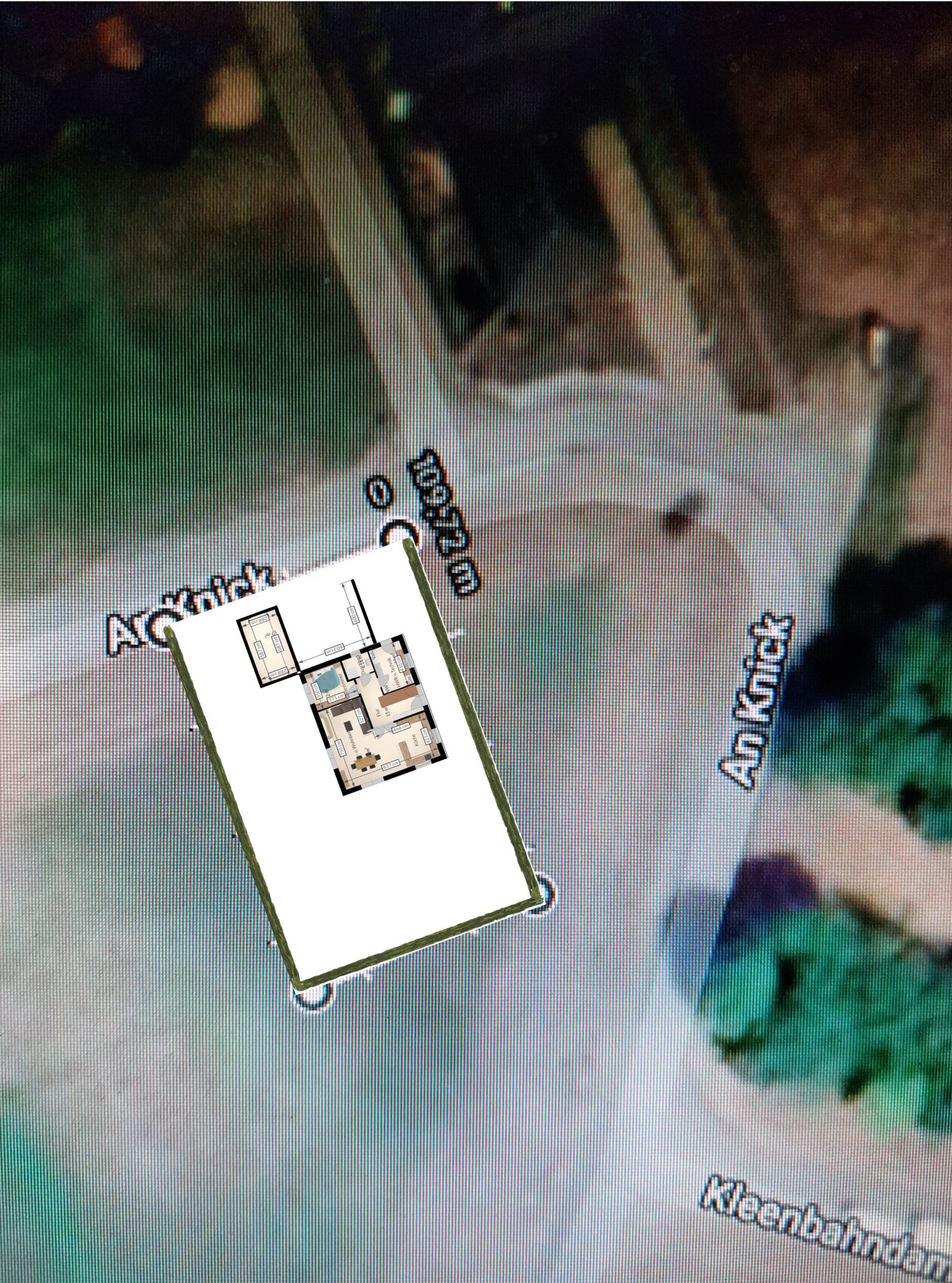

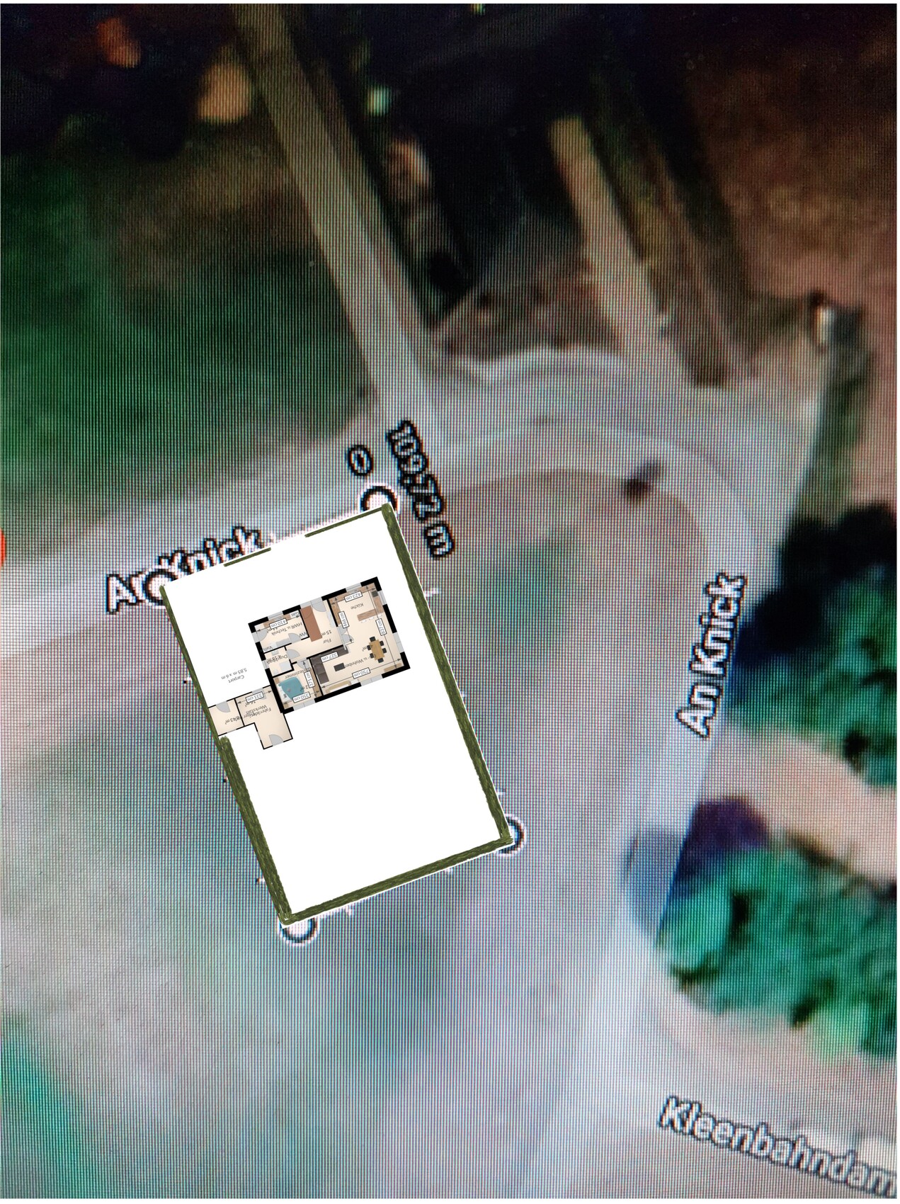

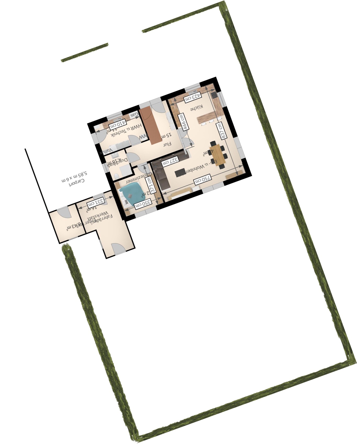

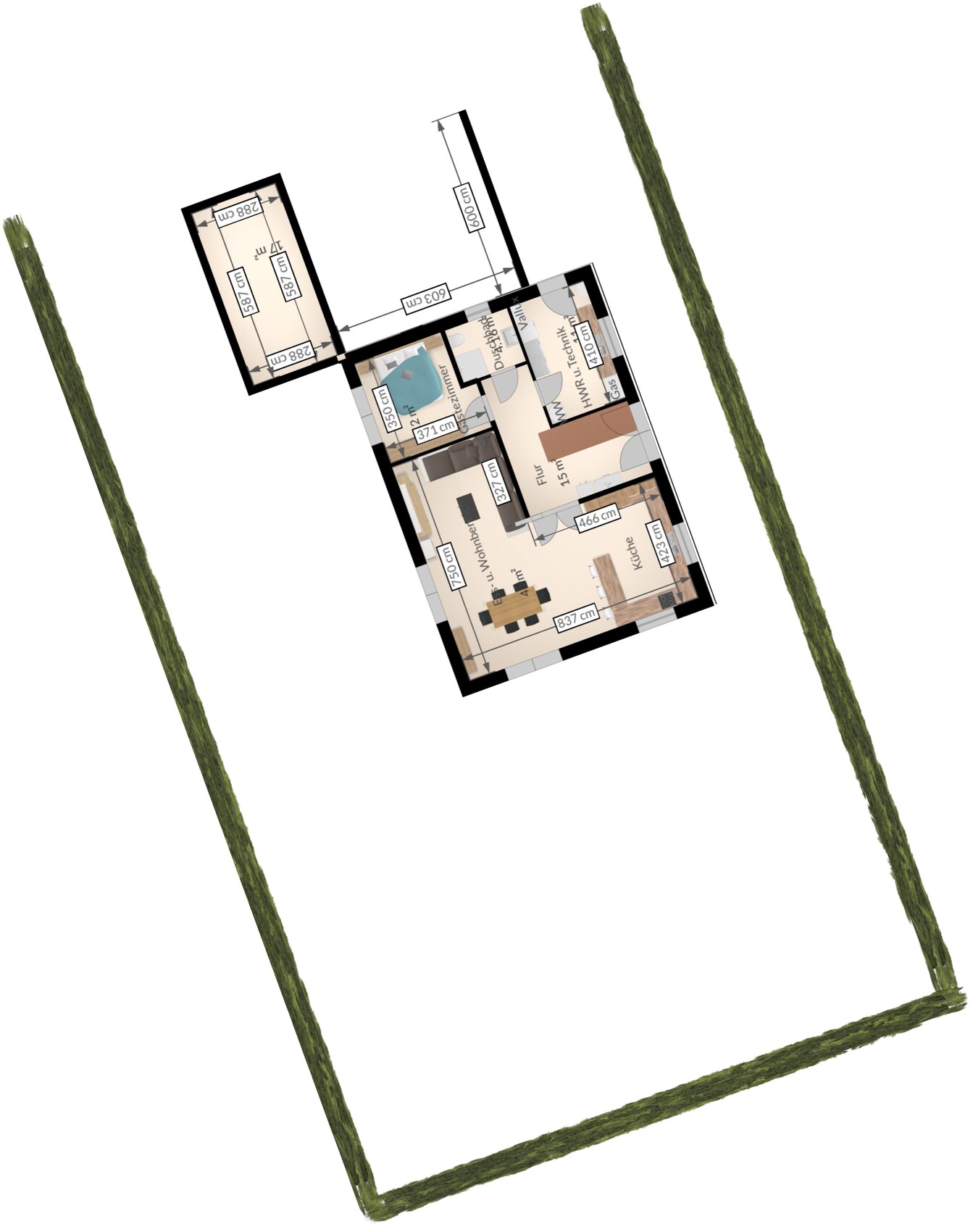

I placed the house floor plans onto the plot.
I would position the carport with an adjoining room along the length of the house directly on the western boundary of the plot... and also provide access to the storage area from the street side... this way, bicycles can be brought to their storage area most comfortably and without interfering with the car.
And yes, rethink the house design, because a Frisian gable with an entrance on the east side is not ideal.
However, I would clearly prefer the longitudinal orientation.

Phew, this is a tough decision... We have been considering changing the Frisian gable to a captain’s gable and orienting the house lengthwise, with the captain’s gable (where our home office would be) facing west toward the garden.
Then I used a sun path simulator, which showed that our west-facing terrace and living area might be in the shadow of a neighboring house if one is built on the western property. Difficult choice...
We will not mirror the ground floor either because we love having the morning sun in the kitchen. It brightens our mood for the day and is more important to us than having sun in the kitchen in the evening.
In addition, the carport on the west side acts as a windbreak, which is an important factor here on the west coast of Schleswig-Holstein.
We might set up a small seating area in the garden to enjoy the evening sun, but that will be planned later.
Thank you for your suggestions, ideas, and the effort you have put into this!
