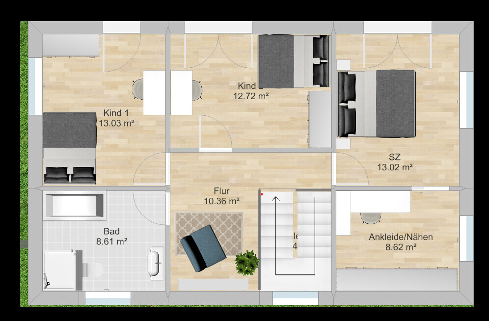

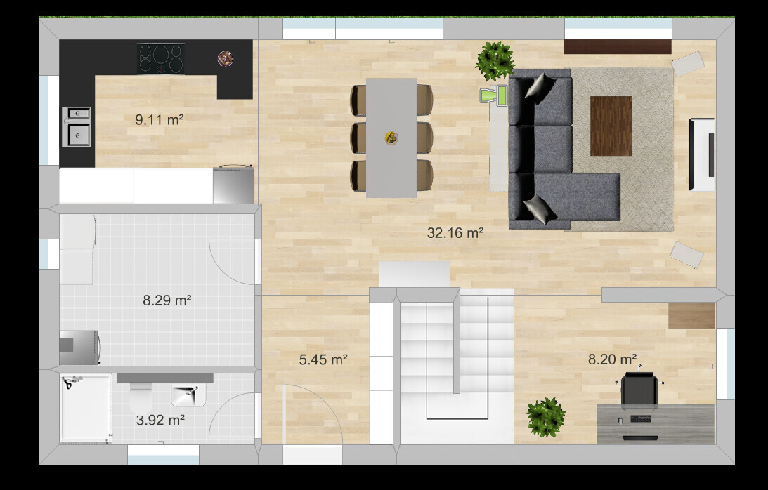

- What we like: open living area, all main rooms have large windows facing the garden, efficient size, although the children’s and bedroom could be smaller, sewing/work nook behind the stairs upstairs, plenty of wall space for large wardrobes in the upstairs bedroom and hallway on the ground floor, light shaft in the stairwell, staircase (we originally wanted a straight run staircase but it would have taken too much space; the one with three quarter turns is also fine with us).
- What we don’t like 100% yet: the height of the house from the outside. It is currently planned as a two-story house with an eaves height of 6.2 m (20 ft), with the ground floor 2.84 m (9 ft 4 in) high and the upper floor 2.60 m (8 ft 6 in) high. The gable roof will be an uninsulated, unfinished cold roof, mainly because of the economical prefabricated truss construction method. This is a bit disappointing because I really like sloped ceilings and did not want the character of a townhouse. Lowering the roof with a knee wall of about 1.90 m (6 ft 3 in) and an insulated roof with open sloped ceilings would probably be more expensive due to the rafter/beam construction. We would also lose the garden view through the floor-to-ceiling bedroom windows.
- Simple: What do you think about the floor plan?
- Can you still imagine the relatively tall two-story house having a country house character? Maybe it depends on the facade design and choice of materials? Do you think it looks too “blocky,” especially from the front entrance side? Or would a lower eaves height with an attic conversion including a knee wall be preferable?
- We are still unsure how to arrange the windows on the garden side. The drawing with the elevations shows two possible versions. We actually prefer it when the upper floor window is centered over the lower window front. However, this does not align the interior line of sight from the entrance door to the garden/patio door (see ground floor plan). This represents version two; for version one, the window front would have to be shifted about one window width to the right, so that the patio door is behind the dining table. With the window front shifted left, the interior looks better to us, but from the outside it looks strange if it is offset from the upper floor window, right? What do you think?

Basically, I would make the hallway narrower by a few centimeters and move the staircase accordingly to the left side of the plan. However, it is not that simple structurally, since the staircase would be hanging on one side, and above it (on the upper floor) there would just be a wall. This would require a somewhat more expensive beam to properly support it. You cannot expect a quiet workplace there—not referring to noise, which has already been discussed, but the disturbance caused by people walking up and down.
As I mentioned before, I would add a wall there and extend it partially, or follow that alignment, so you have a wall behind the couch and can potentially separate that area. Then, in the evenings, a couple could lounge there while others go to the club or come home later.
I would move the utility room door into the hallway area and yes, separate it from the living space with a glass door.
Regarding the heating, as I already said, it will not be placed along the wall.
I think the kitchen is fine as is; maybe add a second window?
I would make the living room corner window floor-to-ceiling, although I might be the only one here suggesting that.
How was the calcium silicate brickwork on the upper floor? Be careful with the cabinet in the sewing room/walk-in closet. It would then be only about 160cm (63 inches) wide with calcium silicate bricks of 160cm (63 inches)... (watch out for the shell construction dimensions, as the screed will be added everywhere, taking about 16cm (6 inches) in height). In this room, it might be better to place the sewing station under the window.
There is potential in the bathroom!
I see a yoga mat more in the bedroom or dressing room... plan the seating area there, you could also retrofit a walk-in closet if it gets too tight with decorations.

Regarding design #122:Since no one is mentioning it, I've been wondering if I missed something, but isn't the ground floor supposed to be mirrored left/right? Isn't the sun on the left side of the plan, where the utility room is currently taking the sunny spot?kaho674 schrieb:
Since no one is saying it, I’ve been wondering if I missed something, but shouldn’t the ground floor be mirrored left/right? Isn’t the sun supposed to be on the left side of the plan, where the utility room is now taking up the sunny spot?No, the house is rotated. The long side faces the garden and therefore to the south.
