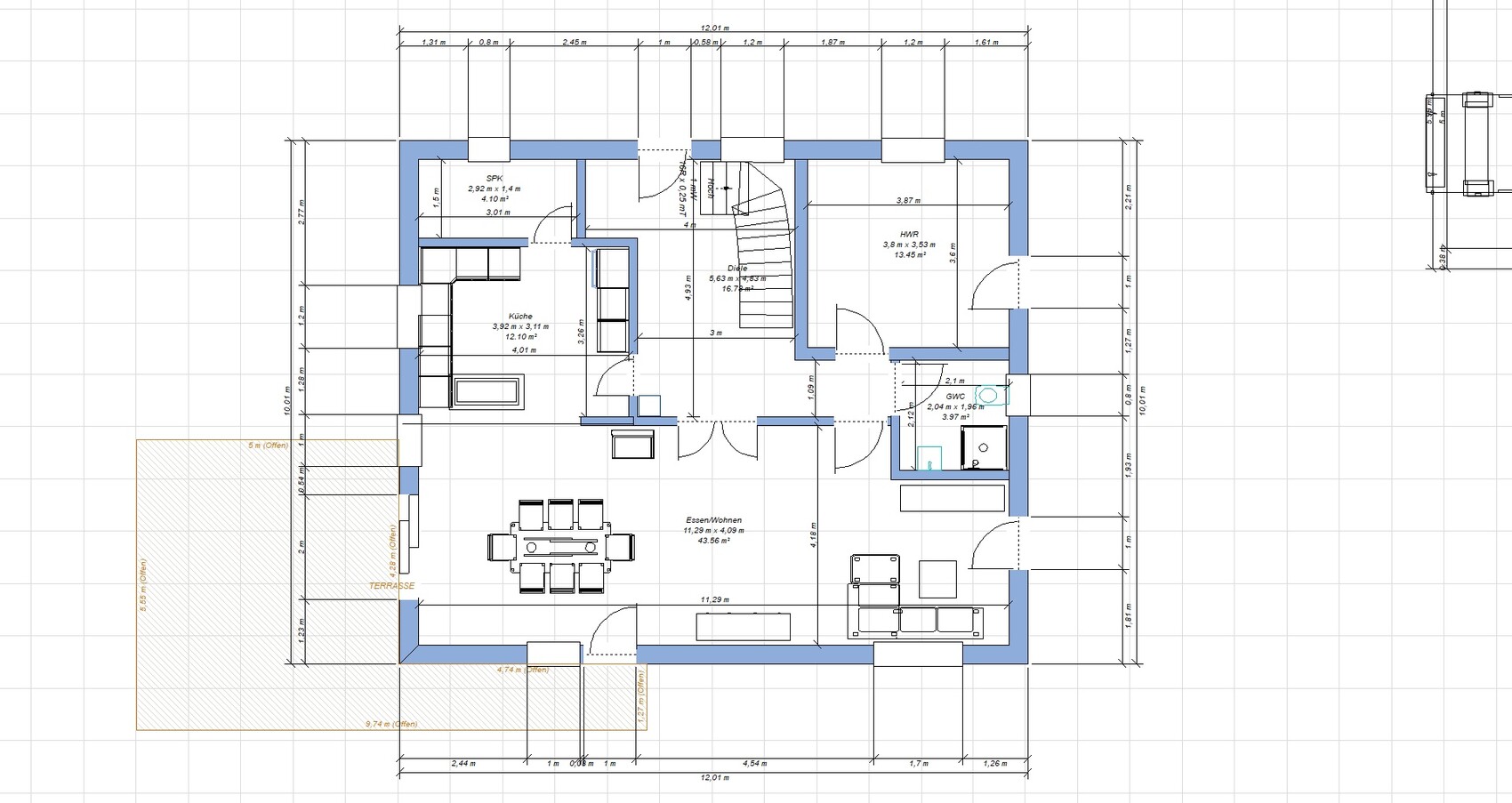

Hi,
You have some conceptual misunderstandings that negatively affect the design. I will explain shortly.
I appreciate that you are engaging in the discussion and responding here.
First:
How is two-story construction regulated in RP? According to your information, you have to build two stories, but the house is declared as one-and-a-half-story, which, strictly speaking, does not exist. This needs to be checked, and depending on whether or how a knee wall is involved, for example, the shower might have to be adjusted.
Budget: quite tight. What do you mean by "planned owner participation: electrical work, flooring, heating, water"? The entire installation?
Are you planning to build with Weberhaus? That is a prefabricated house... can owner participation be done so freely? Or are you just using it as a template?
I am a bit confused because the Weberhaus Balance 300 looks quite different externally on their website than the floor plan shown on page 3. With your extension to 10 meters (about 33 feet) instead of 9.50, you are just above 190sqm (about 2045 sqft), whereas 170sqm (about 1830 sqft) is planned...? I found the city villa model. I don’t see any issue with a gable roof and a knee wall close to 2 meters (about 6.5 feet).
About the design:
At first glance, I see some discrepancies regarding walls stacked on top of each other. For timber framing this might not be that critical, but I’m not sure. There are also load-bearing beams.
The windows seem placed rather arbitrarily; the result will be a house that does not have the carefully considered external elegance of the Weberhaus model.
The windows are also too sparse for the room sizes.
The fireplace is not shown on the upper floor plan (what exactly is a "light masonry stove"?)

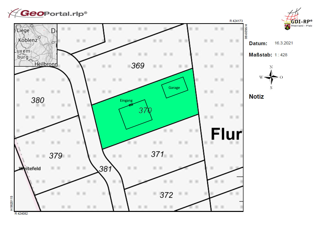

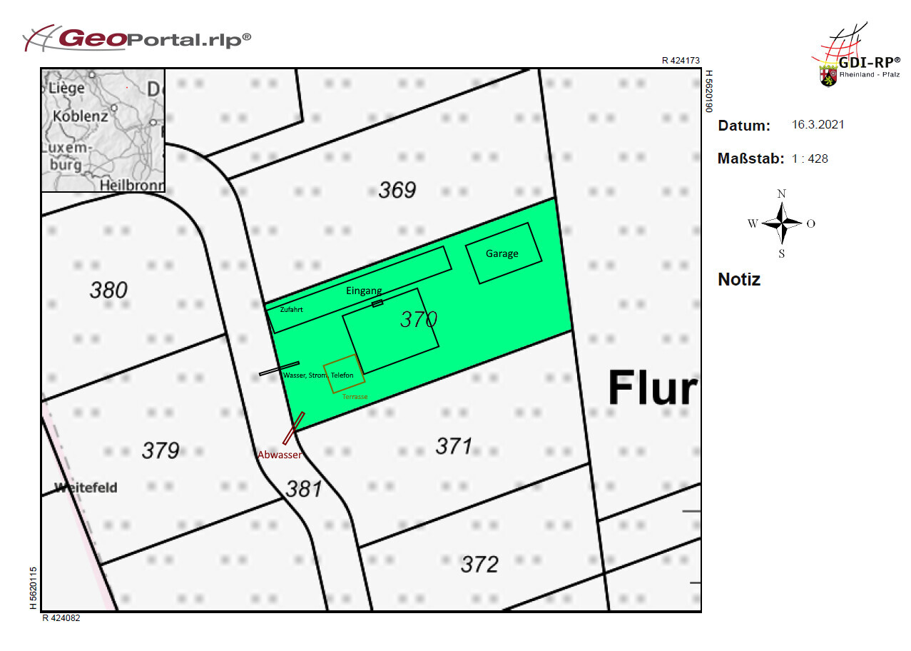

Regarding your conceptual knots:
a) Sunny spot
If the garage is at the front, i.e. on the west corner, there will still be enough sun in the living room during the day. What really blocks your western sunshine is the pantry!
The plot will offer plenty of sunny places. However, consider whether a sunny spot exactly where a garage could ideally be positioned, with a view of a very expensive and long driveway running north, really warms your heart. I would prefer the view of the field without a carport or garage.
Sunny spot: the terrace comes to mind here. If the plot is 18 meters (about 59 feet) wide and you want to drive past the house on the north side, then you will need a comfortable 4 meters (about 13 feet), including the stair landing. If there is hedge planting toward the neighbor (pray that you can share it), it reduces the setback from 5 meters (about 16 feet) to only 4.5 meters (about 15 feet). Then you plan a 10-meter (about 33-foot) wide house (very large) and your terrace ends up practically on the neighbor’s driveway… sorry, right next to the driveway. The question is, are you even allowed to build the terrace on the boundary? In our place, that is not permitted. And if allowed, do you really want to?
→ slim house on a slim plot.
→ There is light even in the shade.
→ A pantry on the west side does not take away southern sunlight.
b) Access "behind the house"
As said before: you are sacrificing a nice view of the field.
A smart builder uses a carport also as a windbreak and plans an extra meter (about 3 feet) to walk or drive through the carport.
Apart from that: planting 120sqm (about 1290 sqft) costs four times as much as 30sqm (about 320 sqft)... the question is how long you will spend shoveling snow.
You also have access all around the house from the entire street side.
You can always get behind the house!
c) Living room reduction
There is a difference between giving an office or guest room a 20-30 cm (8-12 inch) recess or taking about 3 sqm (about 32 sqft) out of the living room corner, which reduces the living area by about 25% and makes it almost unusable as a living room.
If there are children, will the sofa then be moved? Where? Opposite the double door? Opposite the single door? Two doors side by side?
You completely limit yourself with this niche solution; moving the furniture won’t work because of the doors...
The idea of dividing the room also stumbles. I assume it is planned for an elderly bedroom? Try to furnish the room with a double bed and a wardrobe. You will run into tight corners and narrow passages like in the shower WC. This is not suitable for aging; more likely you will bump your toes on corners and edges near the bed, that corner, the hallway in front of the utility room, the shower WC, and its door.
There is no all-in-one perfect solution. Plan uncompromisingly for the next 30 years with a comfortable room and not one where you can barely place anything without bumping your calves. Even if you are not couch potatoes: sometimes you just want to relax, lie on the sofa, kids want to cuddle, etc. And before you move downstairs due to age, there are many years when the couch is the favored place.

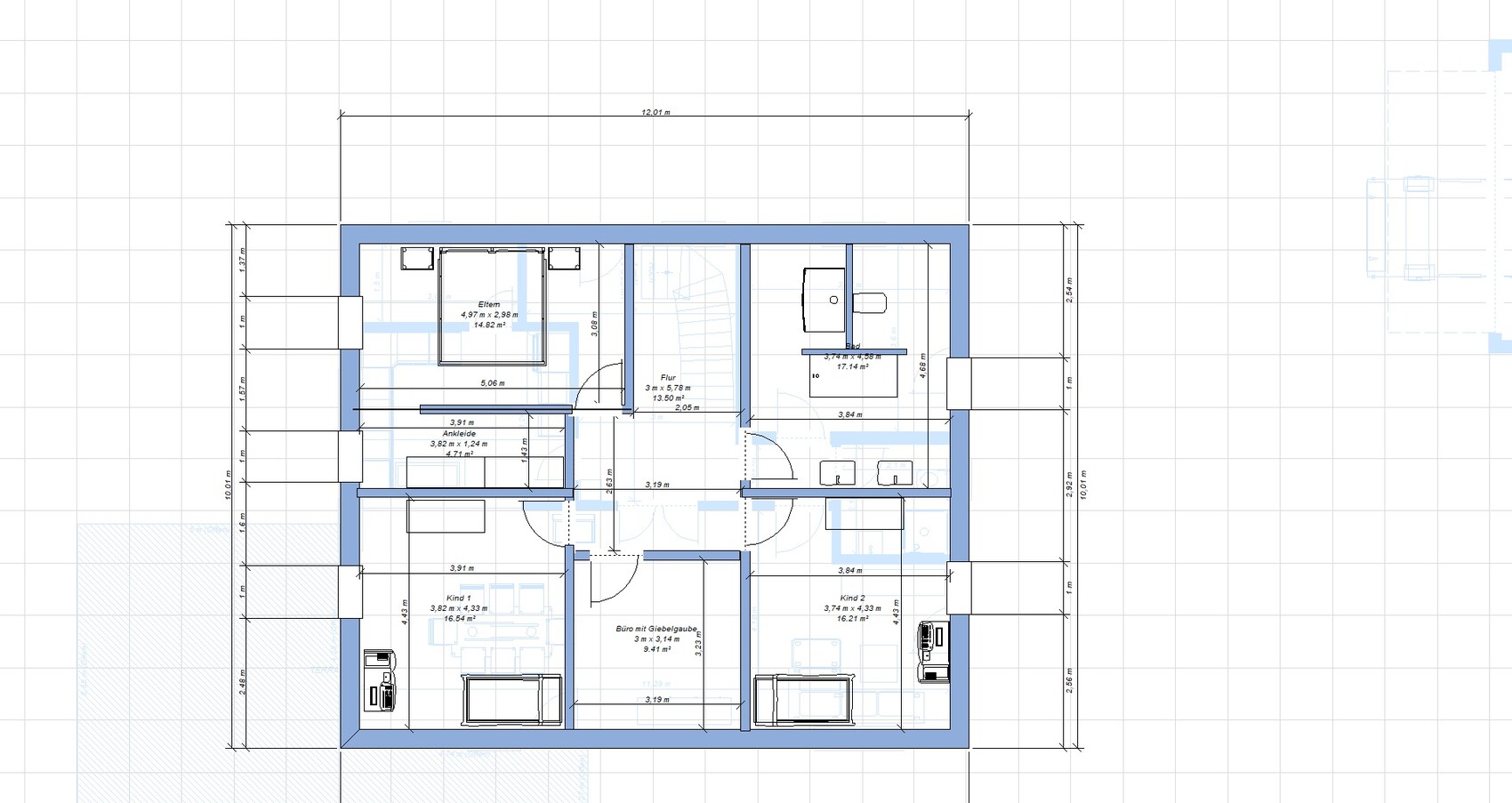

Regarding the floor plan:
No. You could even take 2-3 sqm (21-32 sqft) from it for the shower WC. However, I would also reserve a small storage room upstairs, or if necessary, the office or a large closet for suitcases, decorations, etc.
Just barely. Not for aging.
Not too small, but I find it quite awkward. The tall cabinets are disconnected from the U-shape kitchen.
- Cloakroom directly by the front door restricts movement when arriving home.
- Pantry in the golden west
- Kitchen lacks unity
- Living room nearly unusable for furnishing, practically unusable.
- Two doors side by side into the same room is bad planning (see above)
- Bathroom: T-shaped layout is disproportionately wide, but acceptable.
- Only the utility room door is well placed (behind it there is space for a cupboard). The office door can be moved.
- Dressing room just consumes space and walls. Wardrobe in front of window. With 1.43m (4.7 feet) width and a placed wardrobe, about 75 cm (30 inches) remain as passage width → one-way street with no turning possibility.
Long story short: I would build a narrower house. Everything else would feel too cramped for me.
Garage: driveway on the left, then turn and drive into the perpendicular garage. This also provides privacy for the west terrace. And yes, the sun still comes there.
Edit:
Pantry in the north, utility room in the front → plumbing runs!
ReneWie schrieb:
However, this blocks access behind the house and takes up a lot of space at the front, e.g. with a parallel paved driveway.
ReneWie schrieb:
Then we still can’t get behind the house,
ReneWie schrieb:
Garage, carport: yes, planned at the rear of the property
ReneWie schrieb:
Are there issues with the size of the utility room if you want to accommodate washing machine, dryer, technical equipment, and storage space?
ReneWie schrieb:
Is guest WC with shower sufficiently sized?
ReneWie schrieb:
- possibly kitchen too small

Regarding the design:
At first glance, I notice some discrepancies concerning walls that align vertically. This might not be so relevant for timber frame construction. I’m not sure. There are also load-bearing beams.
The windows seem placed rather arbitrarily: this will result in a different house that no longer has the thoughtfully elegant exterior like the Weberhaus.
The windows themselves are too sparse for the room sizes.
The fireplace is not shown on the upper floor (what is a light masonry heater?)
Okay, I have no knowledge about the structural engineering. The architect/structural engineer (an office) will certainly keep us in check. It could, of course, be that the Weberhaus timber frame method doesn’t require as much attention there.
The issue with the windows is correct. I think especially on the upper floor we need to improve that. Symmetry is just not that easy to achieve.
True, the chimney is missing on the upper floor. It should run along a wall in the corridor. A masonry heater stores the heat from fire and gases in its heat-retaining material and continuously releases it to the surroundings. These heaters come in various designs. For a new house, a smaller model is sufficient.

I have attached another image regarding the terrace placement.
