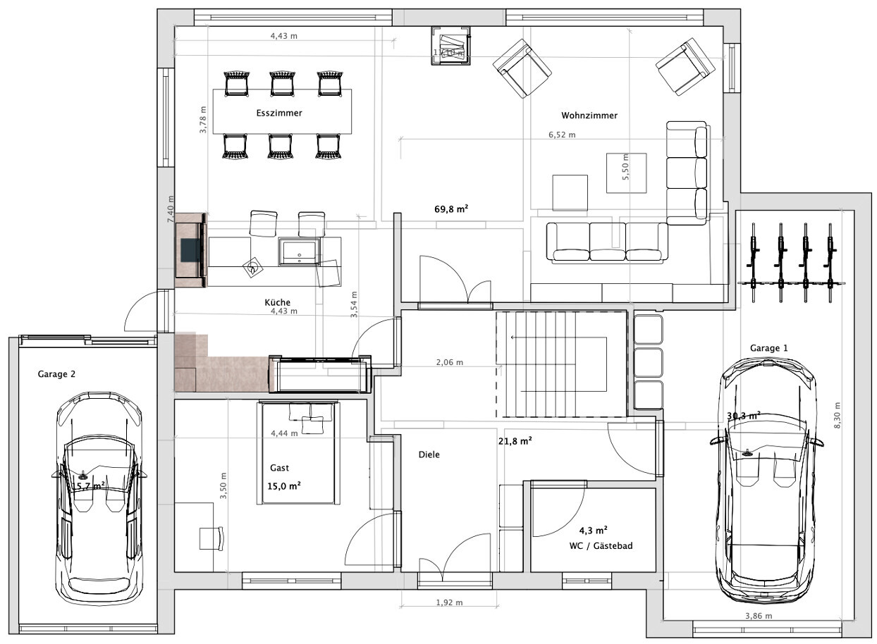

Ground Floor:
Two main questions still concern us:
1) Should the kitchen/dining area be on the left, or should the living room be located there instead?
The recessed kitchen on the left works well for natural light and especially because otherwise, we can't properly fit the staircase. Having the living room on the left would be nice since there is sun there until about 9:30 pm in summer, while the right side is in the shade by 6:30 pm. It’s a matter of preference when and where you want sunlight, but we’d be interested in your opinions.
2) Where should the staircase be placed, and how can we avoid losing much space on the upper floor?
So far, we have only found one solution. We prefer a 180-degree staircase; a 90-degree staircase would also work, ideally with a landing, as we want to avoid angled stair treads.
Other notes:
The plan lacks a pantry. We initially considered placing it in the passageway from the garage to the hallway, but there isn’t enough space for that. So the pantry will now go into the basement. Additionally, the hallway doesn’t have a particularly large cloakroom, so we are considering taking some space from the kitchen/guest room. The guest bathroom on the ground floor could be a bit larger.

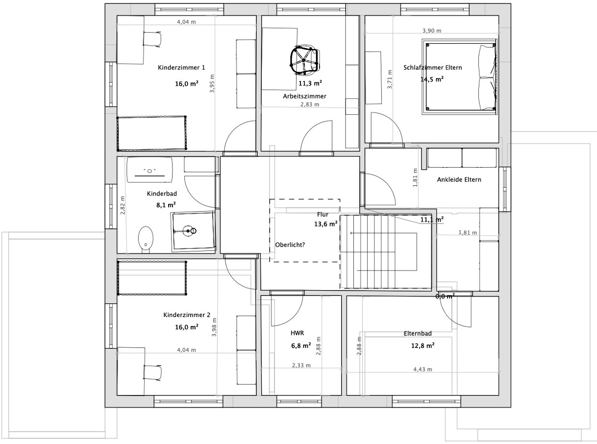

Upper Floor:
We need the space upstairs for two children’s bedrooms, a study, two bathrooms, a master suite, and a utility room. With the current staircase placement and some restrictions regarding the master dressing room and bathroom, everything fits well, and we like the room sizes and their layouts.

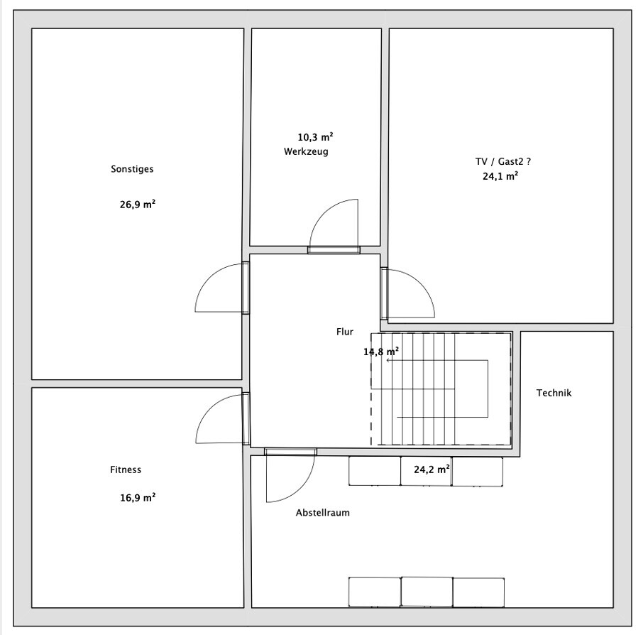

Basement:
Yes, we need a “white tank” (watertight concrete basement). We want it for storage and technical equipment, which cannot be accommodated upstairs. Other rooms like a home gym are nice to have but not essential. Nevertheless, we want the basement for possible resale value and flexibility. Due to costs, we plan to only partially finish the basement. So the basement layout is less important for now.

What do we dislike? Master area – dressing room and bathroom are cramped. Is the hallway with the staircase practical? Kitchen on the left side is practical regarding light, but the living room won’t have sun after 7 pm in summer? Possibly rearrange the sofa in the living room for the TV

Please show the original plan before the changes. It looks a bit chaotic, so I suspect there is potential for better modifications.The changes are only on the ground floor with the extension in the kitchen and the study.
Is there a site plan? A plan with the plot. Please include a north arrow.
Maybe I’m not fully awake yet, but I haven’t quite understood the orientation... on the left (west?) the sun/garden until 9:30 PM, so facing southwest?
With so many square meters, you can definitely do a lot.
- Do the bicycles come out of the garage with the car parked?
- Parents’ dressing room feels awkward
- I would rather place the partition wall in the open space closer to the living room.
I haven’t looked at it in more detail yet...
