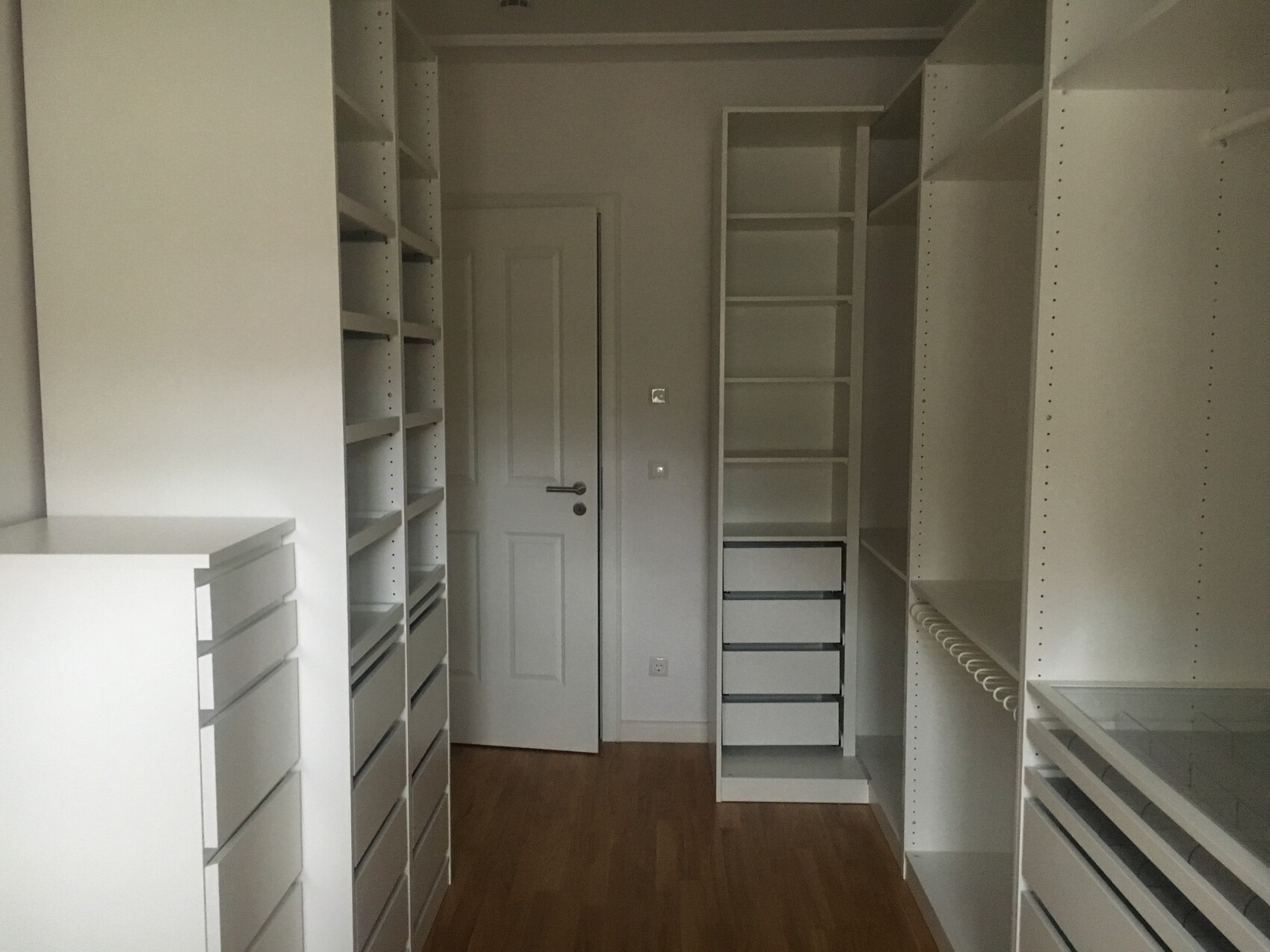

I would reduce the width of the walk-in closet, as well as the entrance to the closet, and then place wardrobes on both sides, not those corner cabinets that are difficult to use effectively anyway.
Sabine
Coletrickle_7808
7 May 2020 09:56
The width really needs to be like that. I think you definitely need about 100cm (39 inches) of space in between... but you can close off the wall and just make a door from the hallway or something like that.
You can also make good use of the corners from Ikea.
Begehbarer weißer Kleiderschrank mit vielen offenen Regalen, Schubladen und Garderobenstangen.
