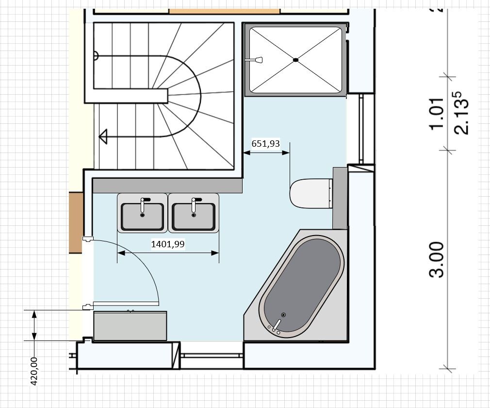

@RomeoZwo Nice planning, but don’t forget the stud walls!Yes, it’s getting tighter, the stud walls are now 20cm (8 inches) thick – is a 65cm (26 inches) passage between the toilet and shower enough? Maybe rotate the bathtub further and also move the window opposite the sink.

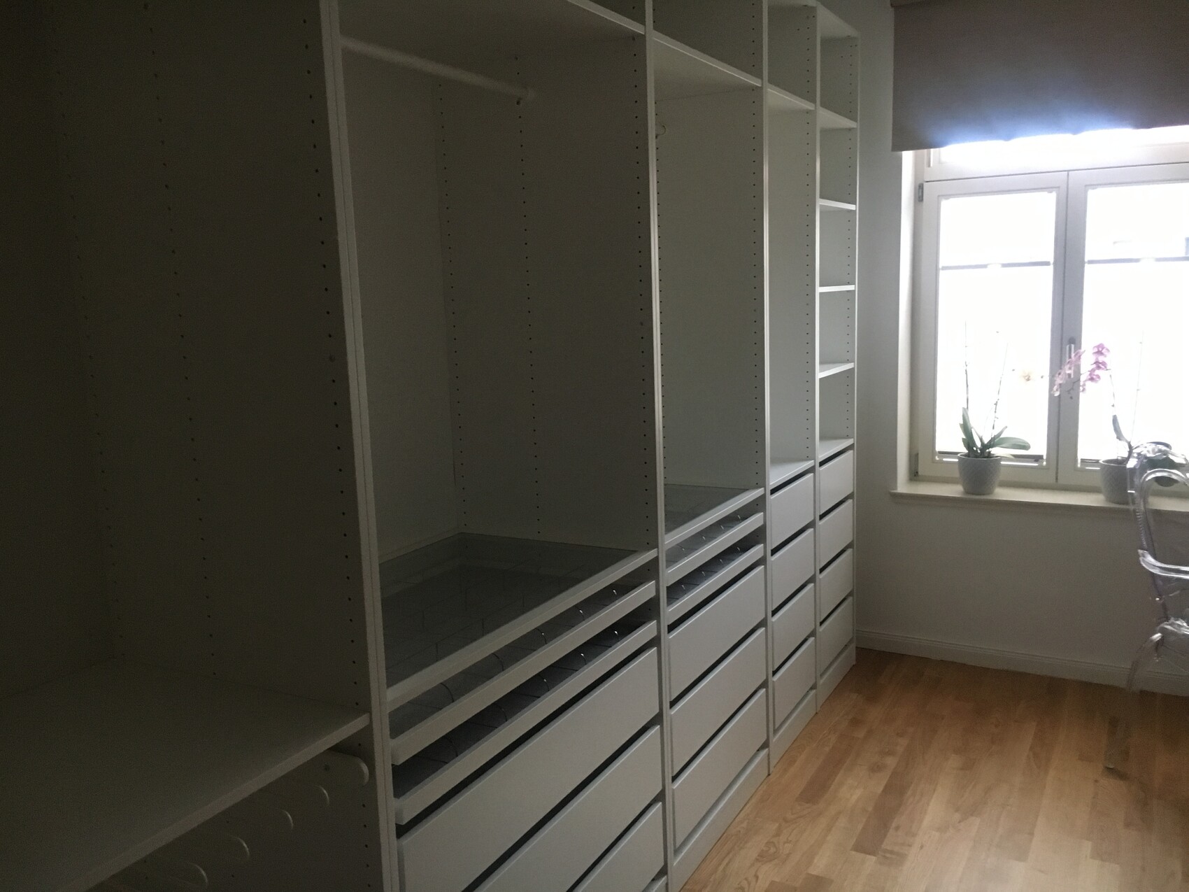

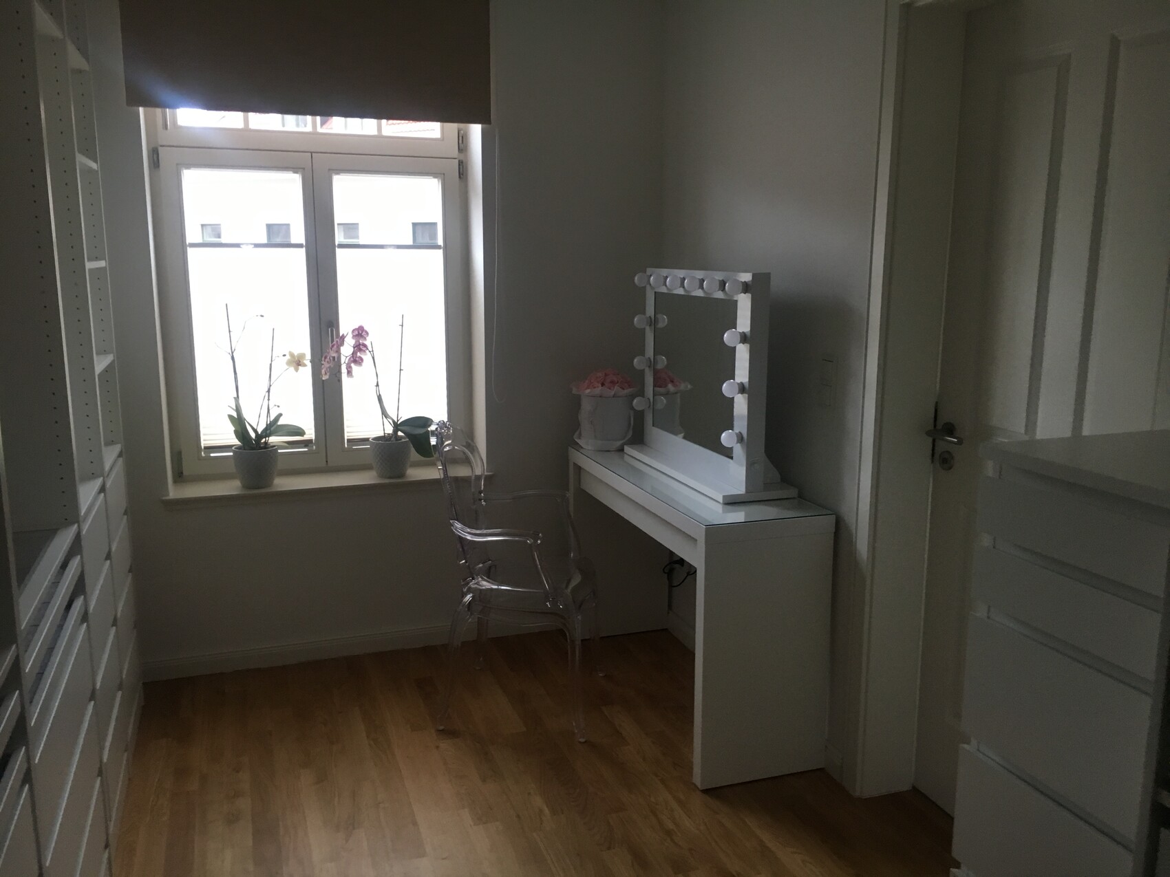

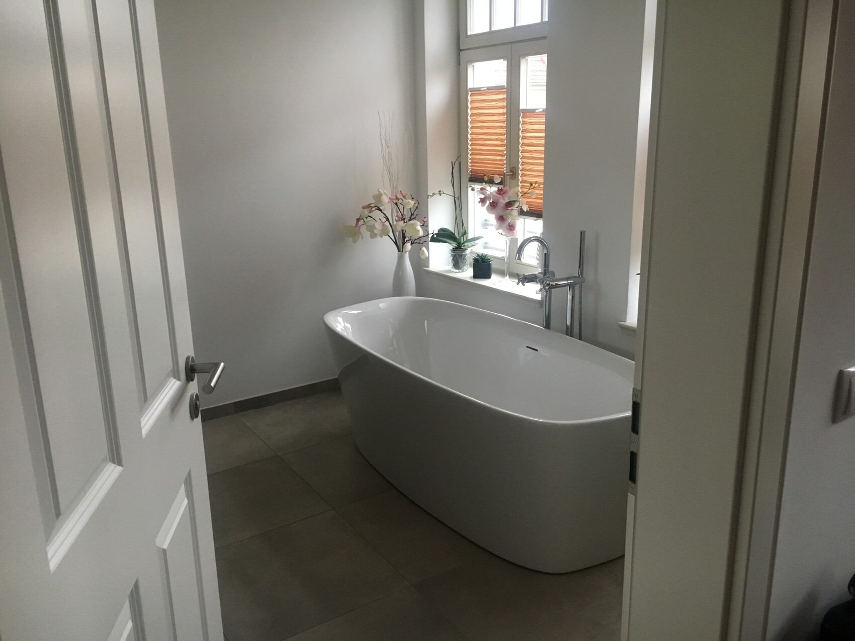

It is important to have room for Pax wardrobes and a dressing table. We have a freestanding bathtub but don’t want one anymore. It’s a hassle to clean.

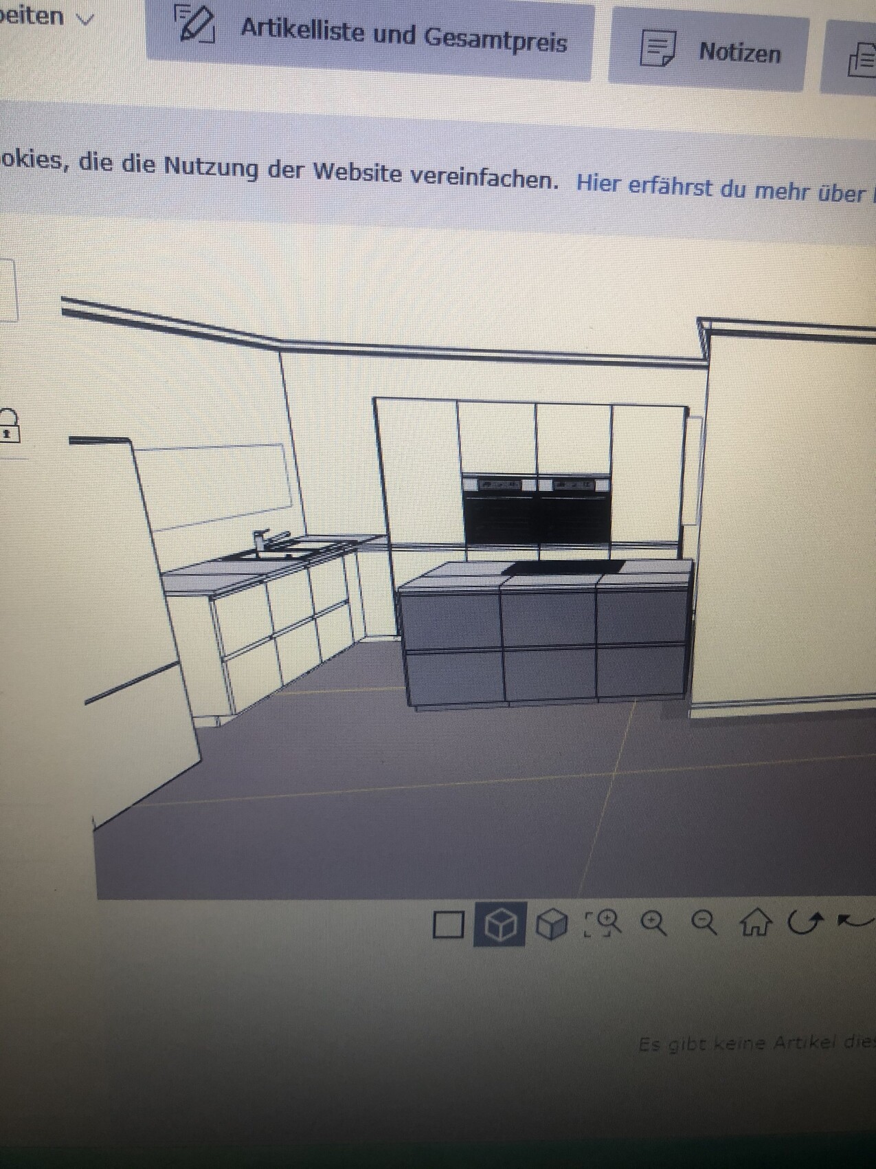

This is roughly how the kitchen should look.

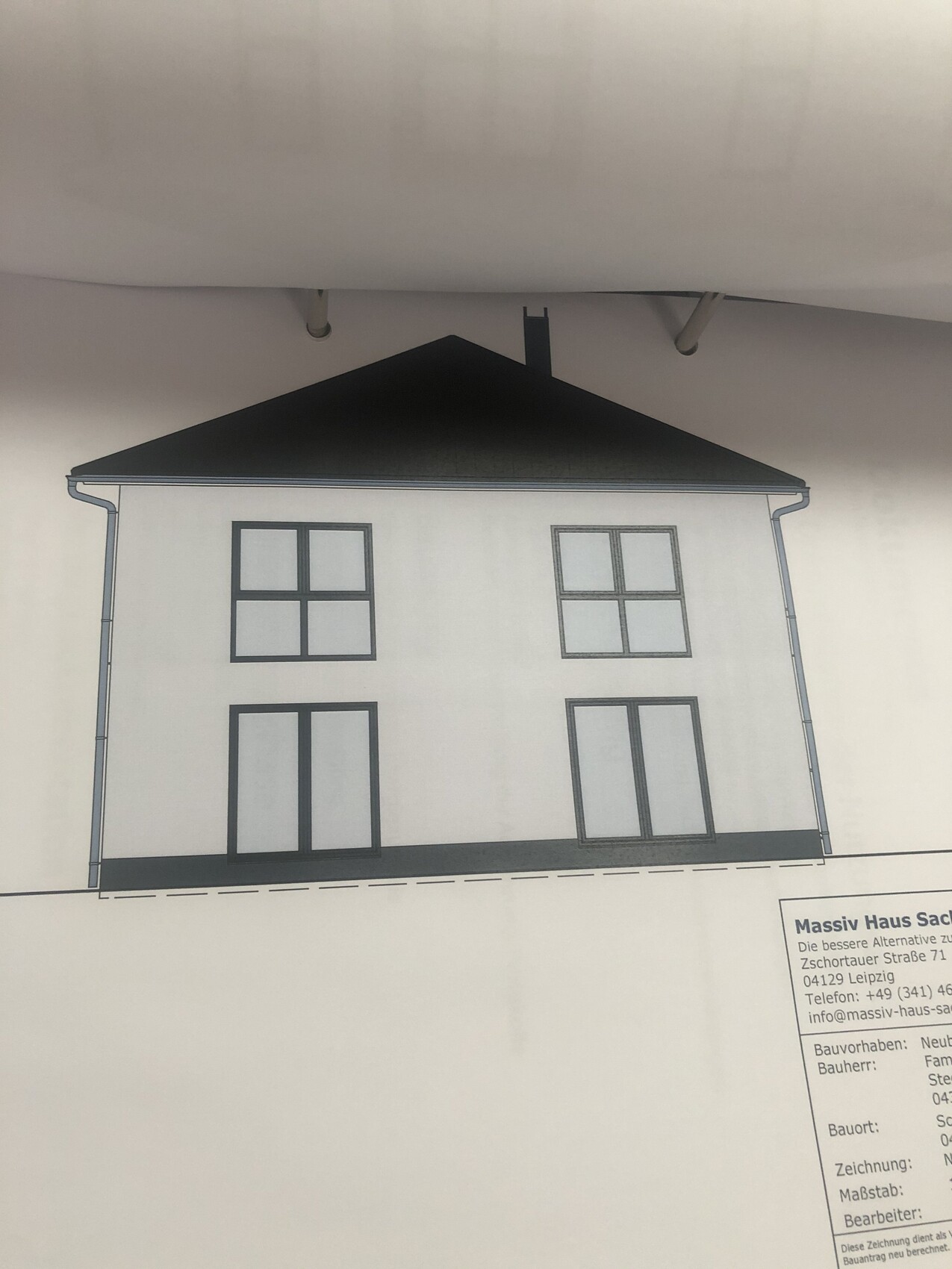

This is roughly how the house should look.

RomeoZwo schrieb:
Is 65cm (26 inches) enough for the passage between the toilet and the shower?That’s starting to get really tight. For a new build, it’s not really appropriate.Coletrickle_7808 schrieb:
What’s important is the space for the ... dressing table.

But we’ll have to agree to disagree on taste.kaho674 schrieb:
That starts to get fiddly. Not really suitable for new construction.If I rotate the tub further, I can manage about 75cm (with a 20cm (8 inch) wall projection).Similar topics
