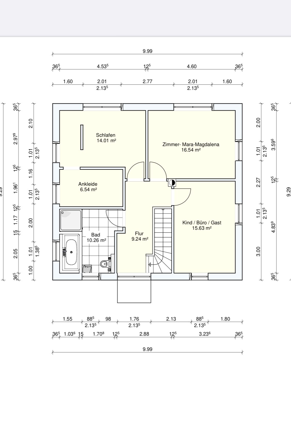

Hi, attached is a floor plan for a townhouse (142sqm (1,527 sq ft)).
What can be improved here? How can the upper floor be optimized in relation to Child 2’s room?
All windows on the upper floor are floor-to-ceiling and located in the same positions as on the ground floor.
On the ground floor, for example, I would create an opening from the kitchen to the hallway opposite the floor-to-ceiling window.
1. This would save having to go through the living room.
2. It would allow natural light into the hallway through that window.
Additionally, I might consider moving the fireplace closer to the living room.
- This would make the walk-in closet more usable; it would probably not disturb Child 1’s room.
Regarding Child 2’s room, the only idea I have is to incorporate the hallway space. Child 2 would then have the wide floor-to-ceiling window, but the hallway would lose its window entirely...
I’m really at a loss here.
Open living/dining area (36.87 sqm (397 sq ft)) with kitchen on the left, sofa on the right, shower and storage room.
Floor plan of the upper level: hallway, bedroom, walk-in closet, bathroom, 2 children's rooms, office/guest room.

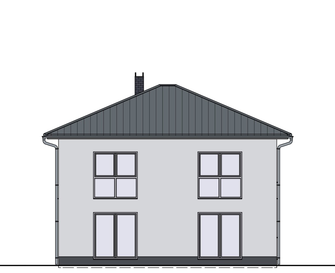

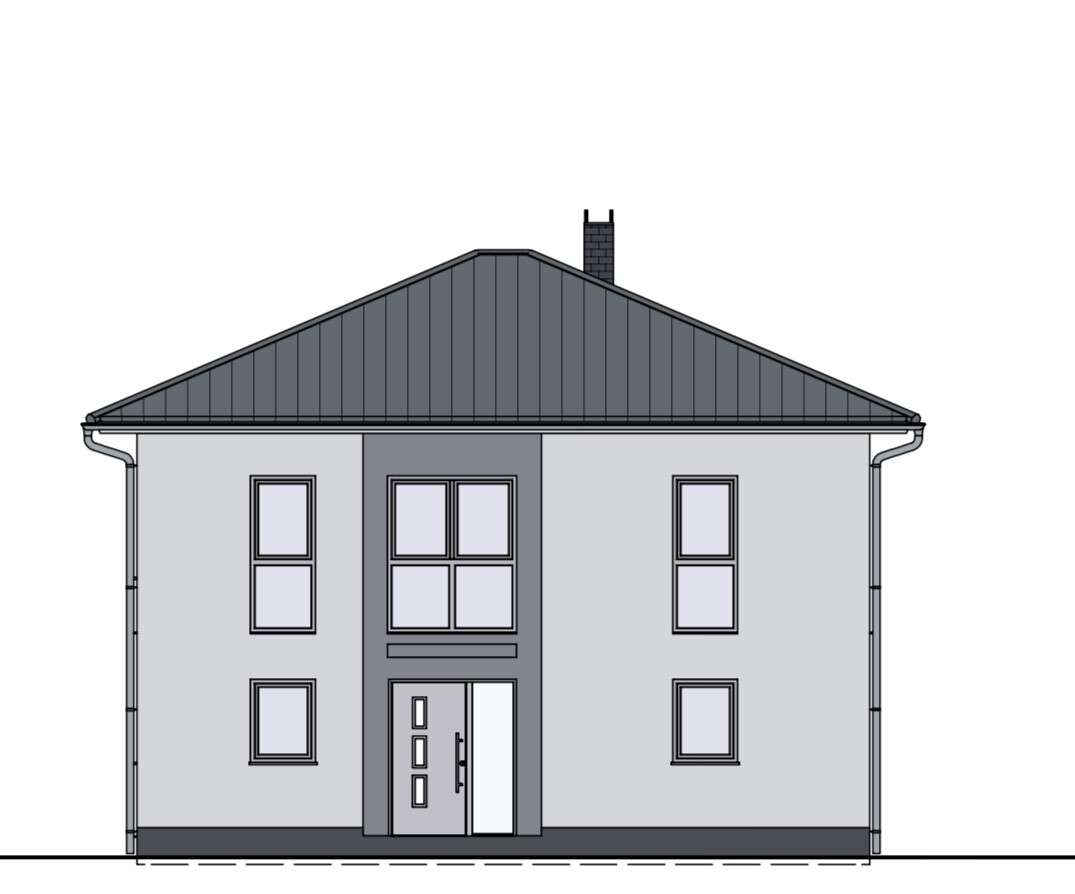

Here are the changes (he forgot the kitchen door).
Floor plan of an upper floor with bedroom, room, dressing room, bathroom, hallway, and child/office/guest room
Floor plan of a house with dining/living area, kitchen, entrance hall, storage room, and utility/technical room
Two-story house with gray facade, dark pitched roof, and chimney; windows upstairs, glass doors downstairs.
Side view of a gray detached house with pitched roof, chimney, two windows on the upper floor.
Two-story detached house from the front with gray facade, dark roof, and central entrance door.
Two-story house: gray facade, dark pitched roof, chimney, multiple windows and doors.
3D interior view with stairs, doors, windows, and wooden floor on two levels.
Pinky03016 May 2020 15:37
Does the bathroom on the ground floor work? It seems very cramped to me. Upstairs, the sink was simply left out to make it fit.
