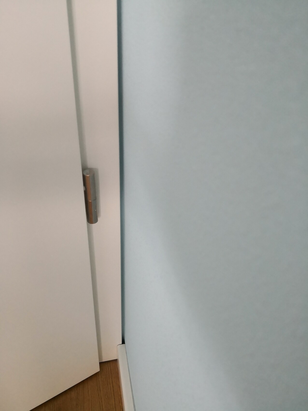

In our case, the doors are positioned so close to the wall that only the door frame fits. I can’t say exactly how many centimeters (inches) this was in the planning stage. However, I would recommend leaving some space behind the door for a closet or wardrobe whenever possible.
Weiße Tür links mit Bronze-Scharnier, daneben hellblaue Wand; Bodenleiste erkennbar.
