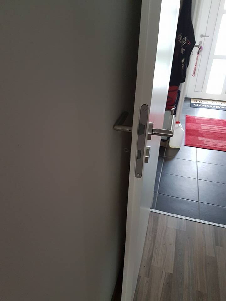

1 Jul 2019 15:30
That is a 6cm (2.4 inches) remaining width in the door opening (in the shell construction phase, so without the door frame yet)
Open door with handle, view into hallway with tiled floor and red carpet runner.
