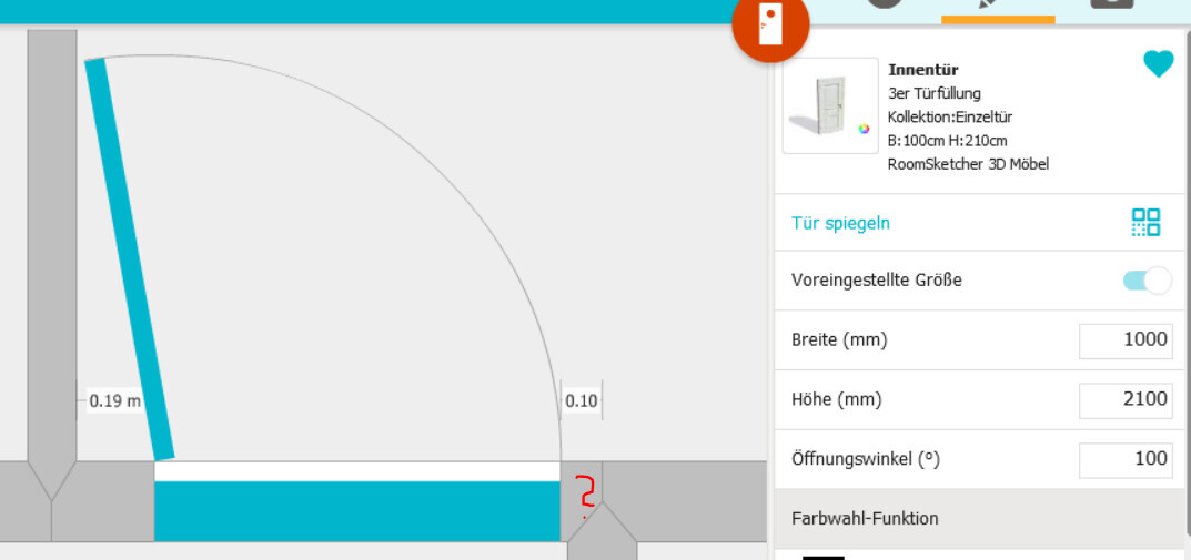

micric3
1 Jul 2019 14:05
I have worked with an opening angle of 100° before.
What should the distance to the opposite side be? Would that even be possible?
Door in a furniture planning app: Blue filling, opens 100°, dimensions 1000×2100 mm (39×83 inches).
