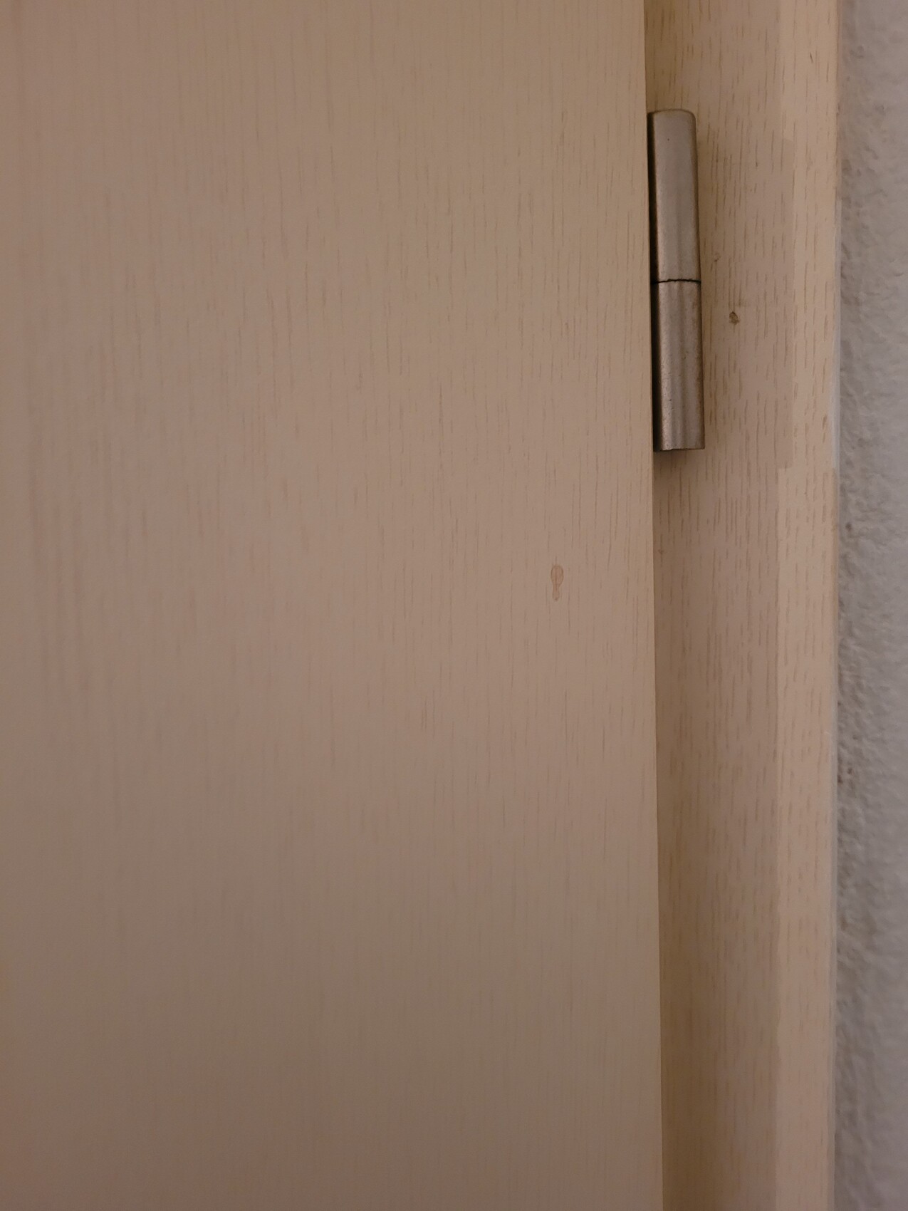

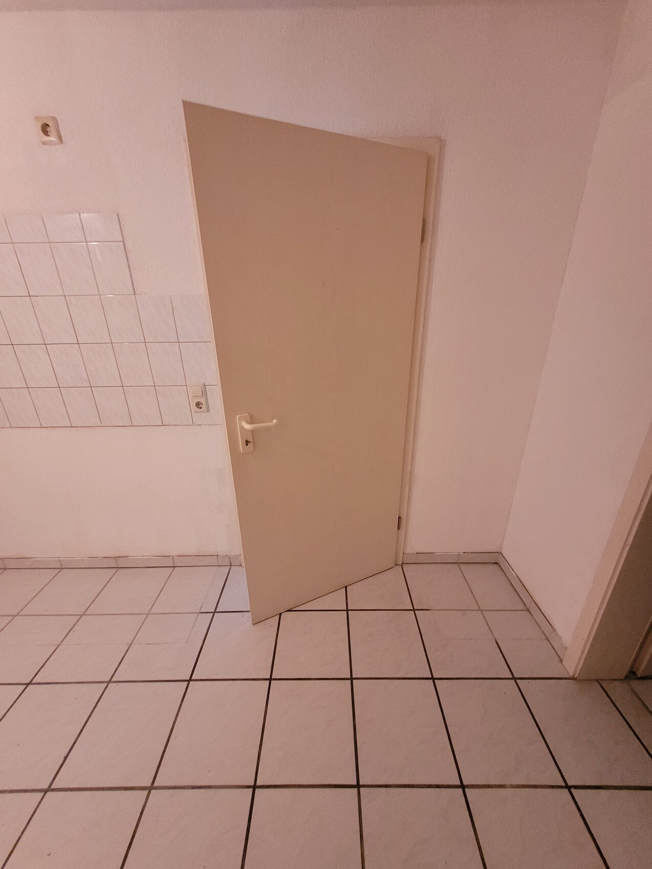

HubiTrubi4020 Dec 2021 01:39Hello everyone,
We are considering replacing the doors since we are also planning to refinish the floors and paint. Due to a limited budget, we are thinking about keeping the doors in the basement or possibly painting the door frames and only replacing the door panels. I suspect the surface is a plastic veneer (see photo), probably not wood. For the basement, affordable door panels from a hardware store would probably be sufficient. Upstairs, our renovation contractor recommended Prüm doors. My question is: How do these differ from, say, the better hardware store doors?
Here are photos showing the entire door
