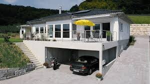

Looking at the photo, there is a noticeable difference in elevation, especially towards the northeast corner of the property (based on the height of the street and the house to the east). The hedge appears to be planted on a slope when viewed from the street. It’s hard to estimate precisely from the image, but I would guess about 1 meter (3 feet). Do you have more accurate measurements?
If parking spaces or a carport are planned in the northeast area, this needs to be taken into account. If the difference is more than 1.5 to 2 meters (5 to 6.5 feet), a (partial) basement with parking underneath the house might be a good solution. In any case, I would try to ensure the house terrace is not below the level of the sidewalk, otherwise passersby could easily look onto the terrace and into the living room.
