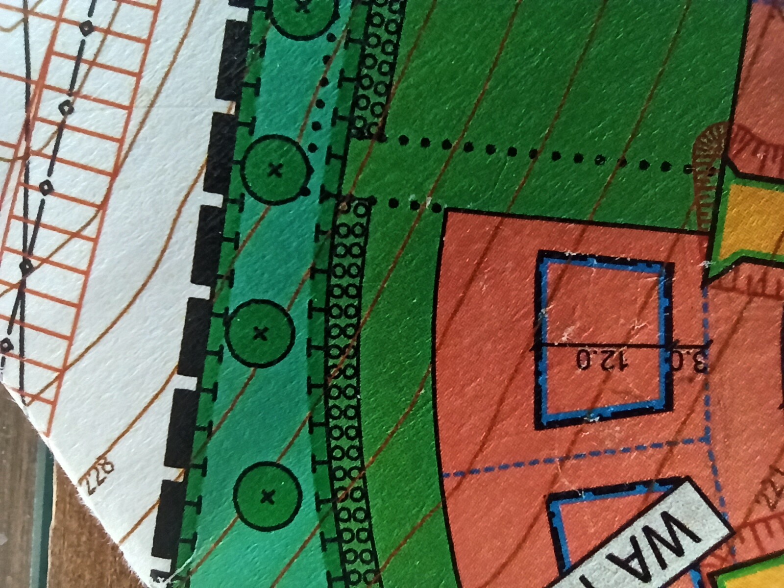

Construction plan snapshot: green areas, orange blocks, blue outlines, measurement lines.

What is the slope within the building area? From the section of the image, only one contour line’s number is visible, so it’s not clear how far apart the contour lines are. Are there any other restrictions in the zoning plan / building permit?

Each line represents 1 meter (3.3 feet). So the slope within the building plot is about 1.5 meters (5 feet).
The development plan sets a maximum ridge height of 11 meters (36 feet). So we have enough space.
